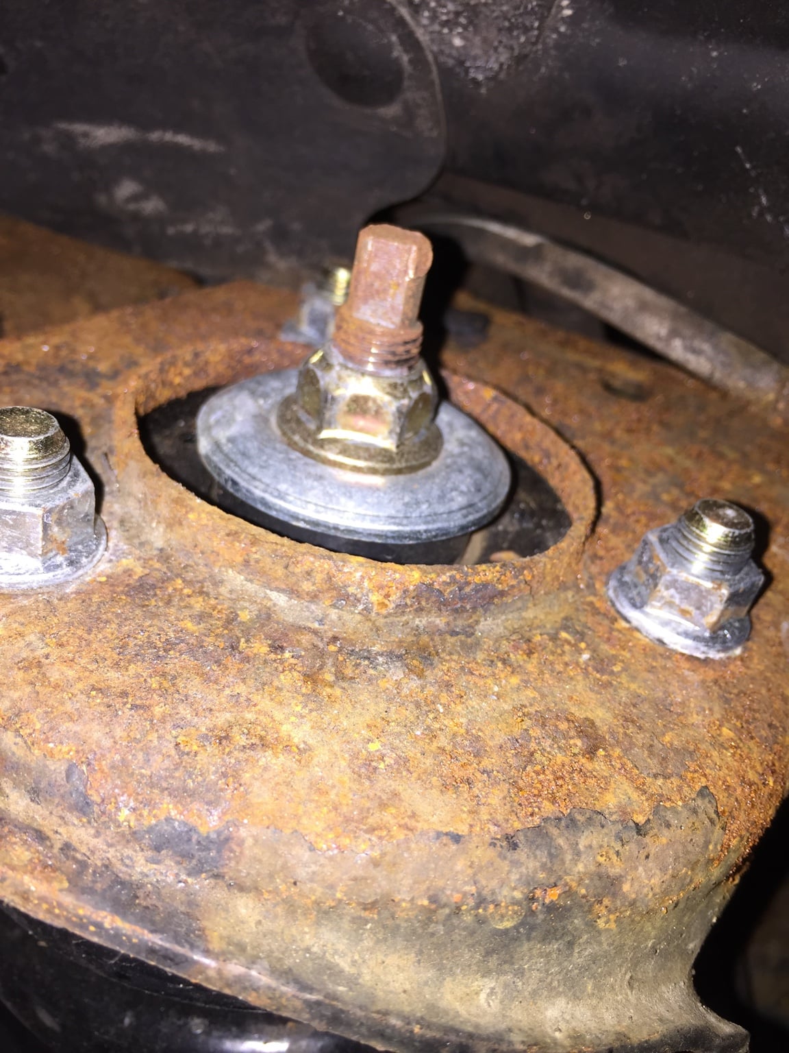

Front - 99 tall springs (ac delco) with bilstein 4600. I bought a new top plate called a Monroe strut mate

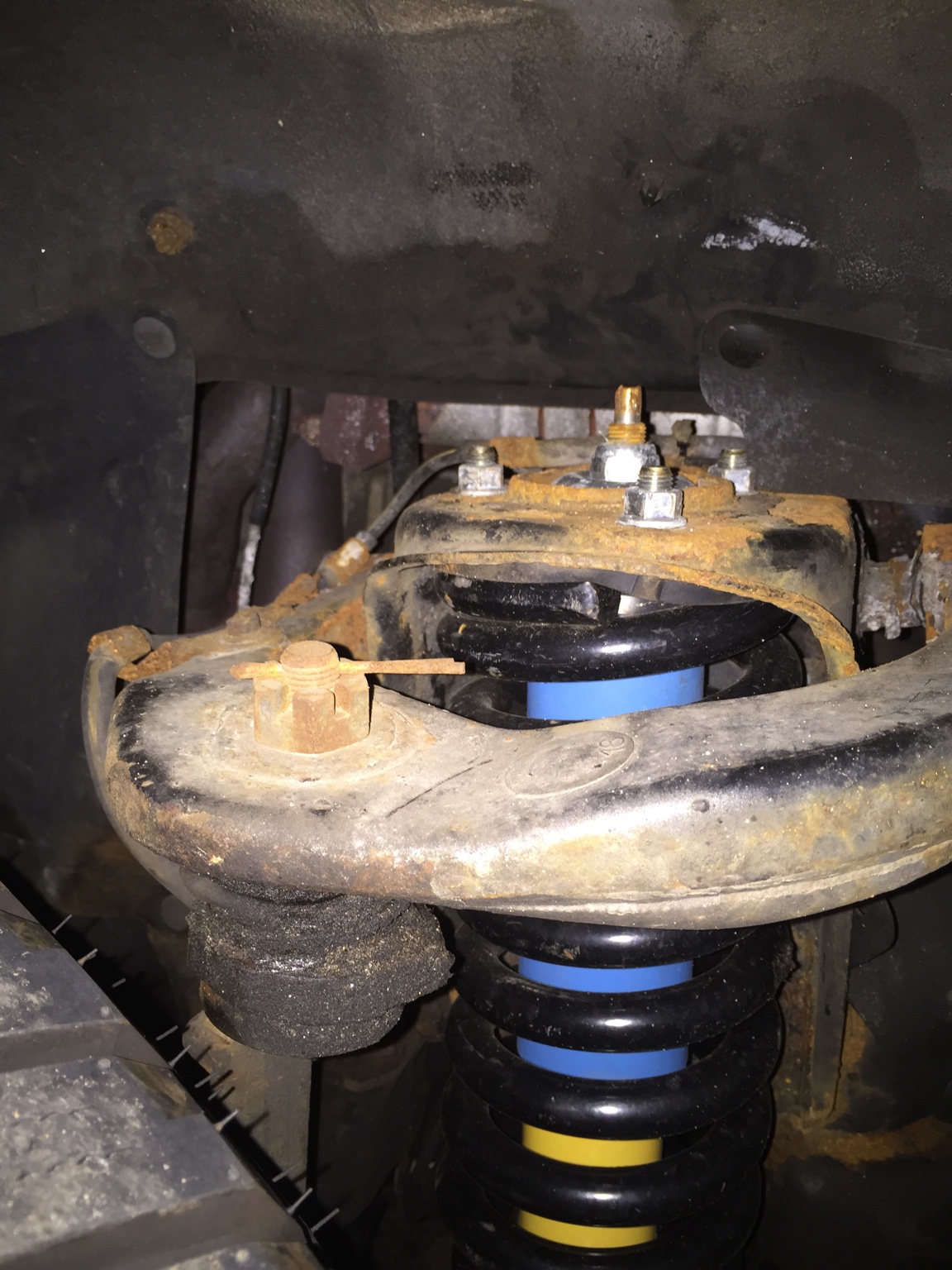

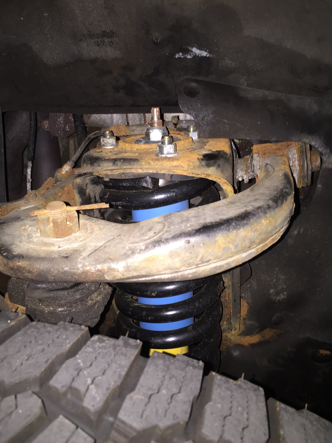

Here's a picture of the assembled strut

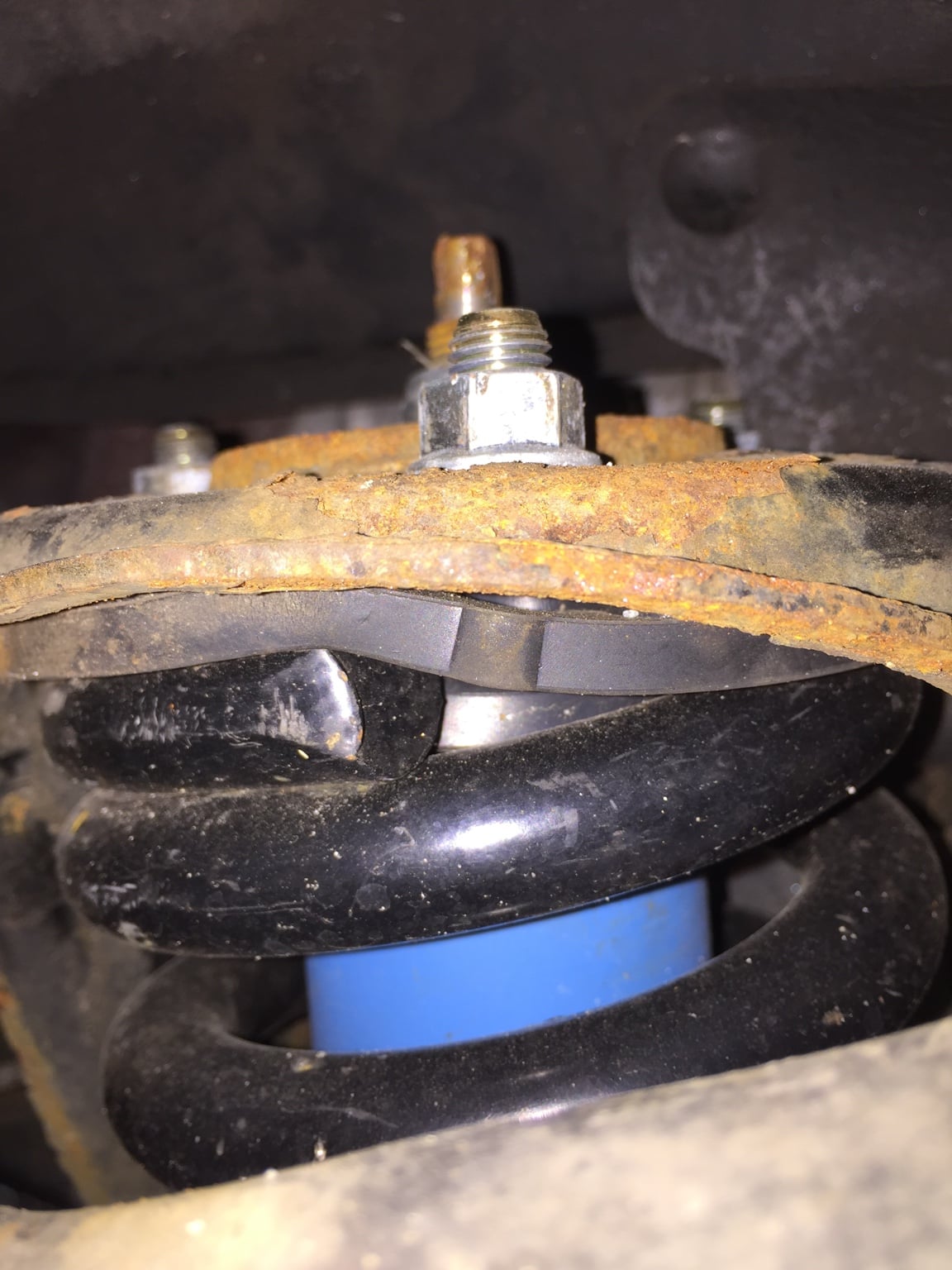

It's hard to see but it looks like the top of the spring doesn't really sit inside of a groove or anything, it just kind of mashes against the rubber unevenly. I'm thinking this might be giving an extra 1/2" of lift and maybe putting preload on the spring.

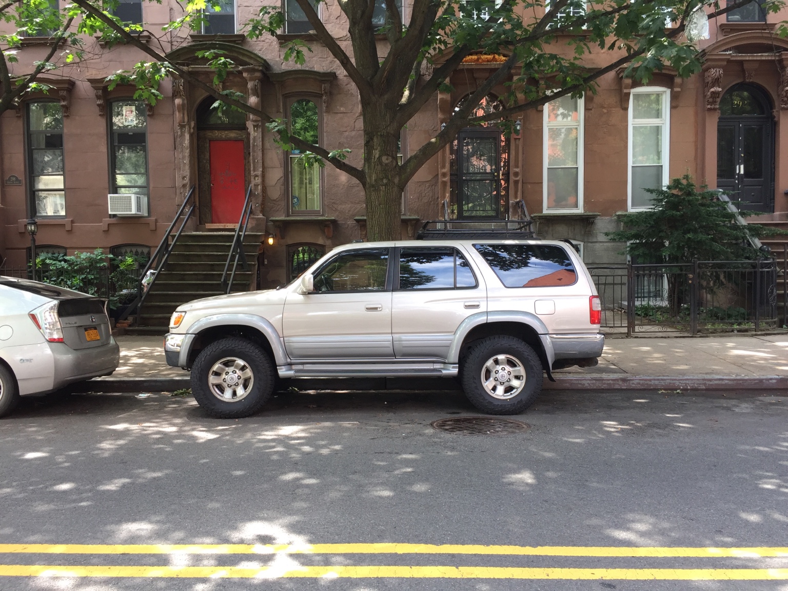

Here's what the Runner looks like unloaded:
It looks like I ended up basically level, at times it almost looks like I've got reverse rake. Measured hub to fender I can't remember the exact #s but rear is about 1/4" to 1/2" more than front.
The ride also is pretty stiff. Do you think the front struts are assembled wrong or those Monroe top plates are causing some weird preload?

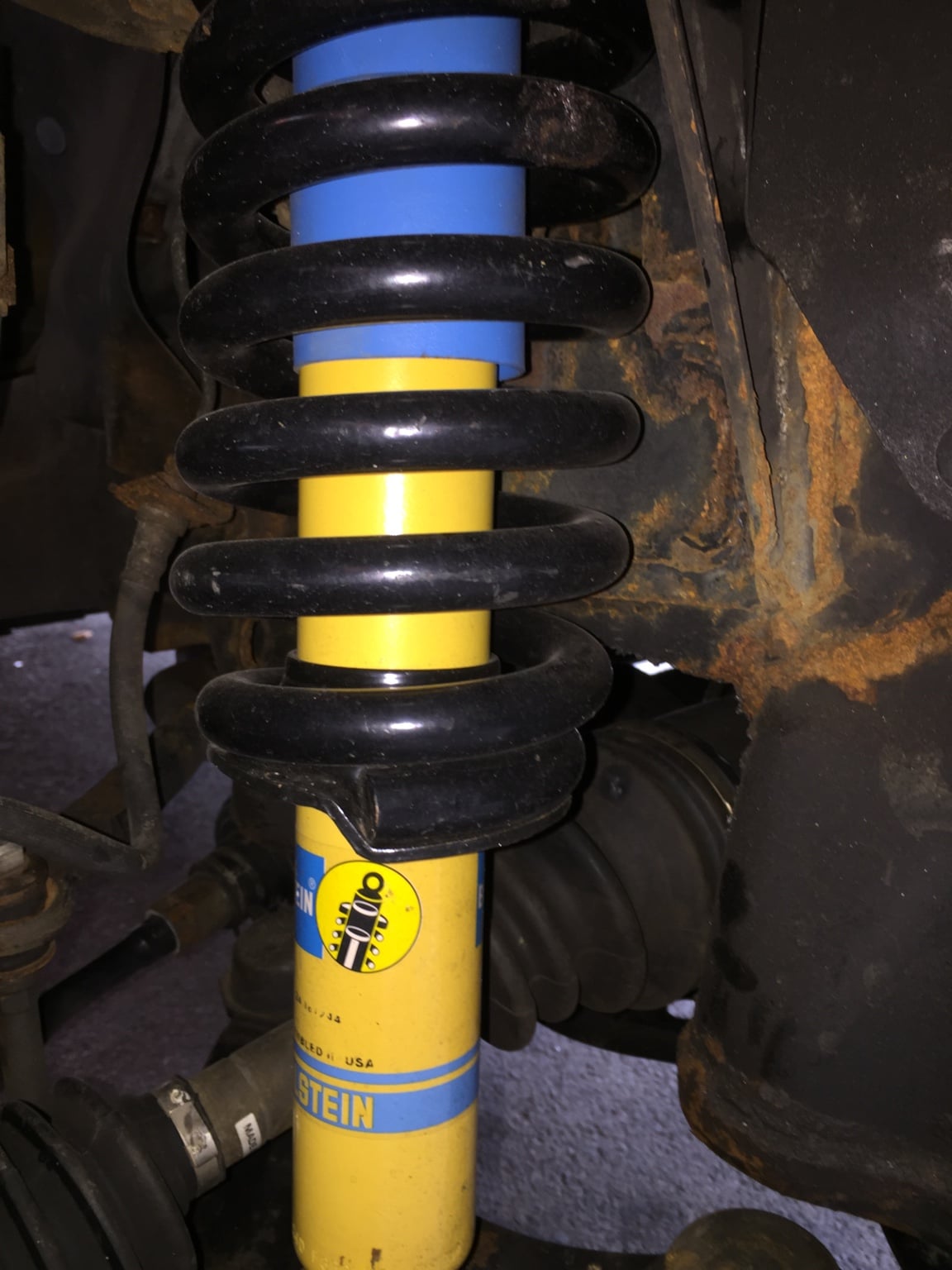

Edit- was thinking about it more, I can take some pics later but I do remember that the coil at the bottom does fit into the retainer ring.

It looks like the AC Delco springs do not have a nice taper at the end and flattened top like the OEMs. Perhaps the springs were installed upside down? One end of the spring should be able to stand upright on a flat surface and the other side should curl up at an angle. Do you have a picture of the bottom of the strut?
They're installed correctly. Including the orientation of the spring.

Hard to see in the picture, is there a rubber bushing on top of the top plate?

Run it, that is installed properly. Maybe someone will post a picture of their aftermarket spring sitting against the top plate. Normally it's a much smoother transition then that, but it's installed properly.
Thanks for the insight fellas. You think the way it's smashing in there is causing any noticeable preload and contributing to a rough ride? The mechanic did note that it was challenging to compress the springs.
Sounds like I need to get some 10mm trim packers for the back to satisfy my rake desires. I was thinking about stacking 2 of them for 20mm.
The other option is the daystar 1.5" spacer. Do you think 2" of rake unloaded will be ridiculous?

Personally it looks wrong. But I guess it's not according to members. I would think the coil would sit inside the shock cup. And the top part would be flat. Which would sit perfectly with the bushing. That's how my old eibachs were.
its correct. its just the top of the spring did not have a nice taper, give it some time and the ride quality should change
