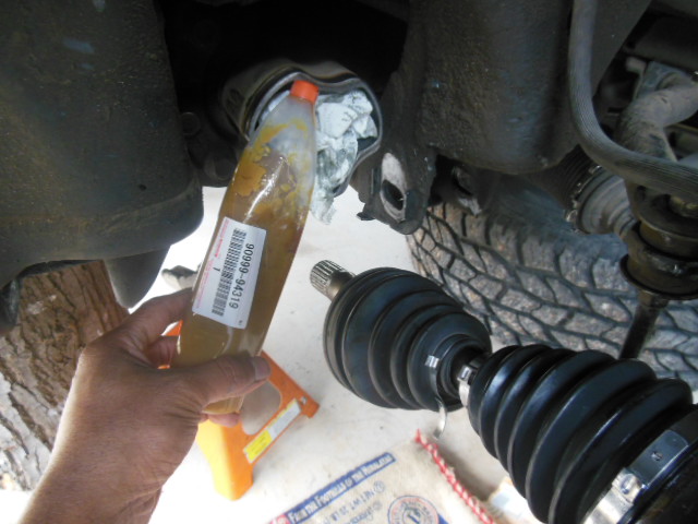

CV Boot Kit
Boot Kit FR Drive 04438-35062: Plastic boot and white grease tube for outer. You can
use metal cable ties (at NAPA) as CV boot clamps too!

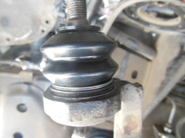

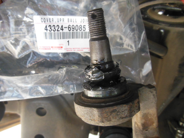

Upper Ball Joint Grease Boot
43324-69085 Cover, UPR Ball Joint

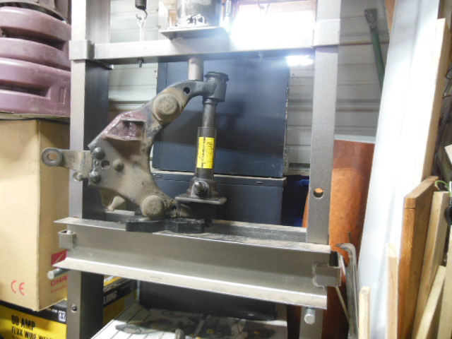

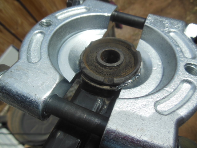

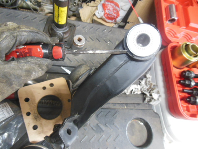

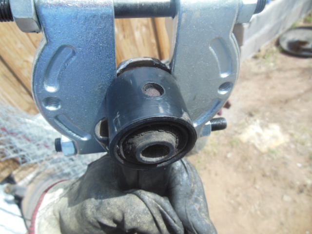

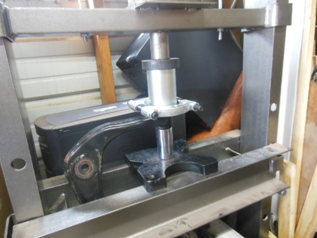

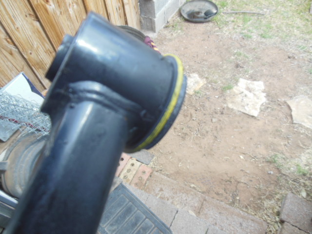

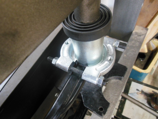

A press was used to hold the Lower A-arm secure while using the bottle jack. This made sure the A-arm is NOT getting elongated/bent while pressing out bushings. Heating required on certain bushings.

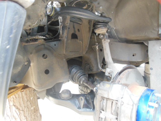

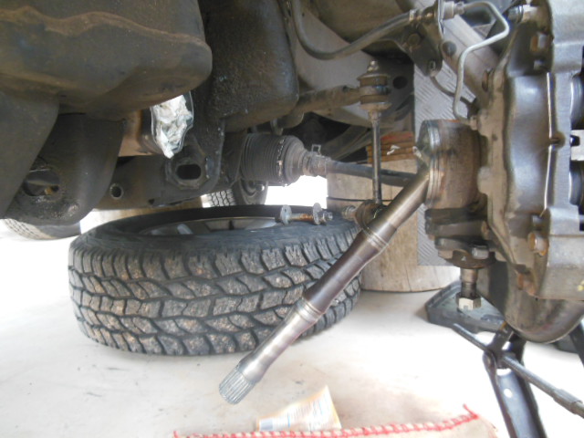

I followed Tim's video on how to remove the Lower Control Arm. Pictures start from there.

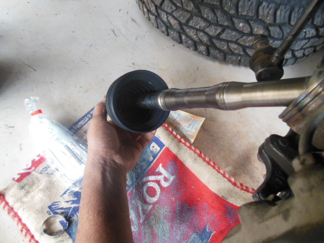

To get the CV boots: Remove boot clamps and pull the inner boot towards the wheel hub. Note the orientation of tri-pod joint to the axle shaft. Removed the C-clip that holds the tri-pod joint to the CV axle shaft. Slide the tri-pod joint off the axle followed by the boots.

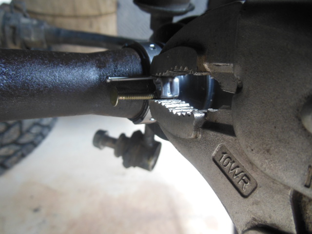

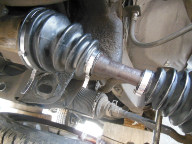

Use two nails (pointy end cut-off) to tighten the outer clamps. As Tim stated the Chinese CV boot clamps are JUNK! Mine broke in 3rd try!

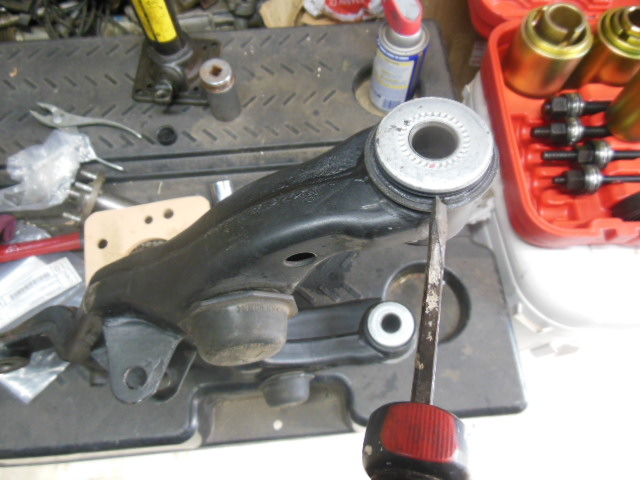

Note the proper orientation of TAB marking (shown by the screw driver) on last 2 images in this post

CV Boot Kit
