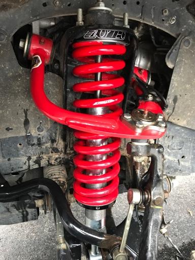

Have you adjusted your toytecs in the past? If you can post a picture of them we can see the model and style you're working with.
Im running toytec aluma 2.5s on my rig and have adjusted them a few times. As far as instructions go:

When I originally installed them I adjusted them slightly to compensate for a slight drivers side lean, but that was years ago. They are not alumas, they're the older model that adjusts from the bottom. I don't believe there is any locking ring or set screw at all from what i remember.
They look like this:
url
url
