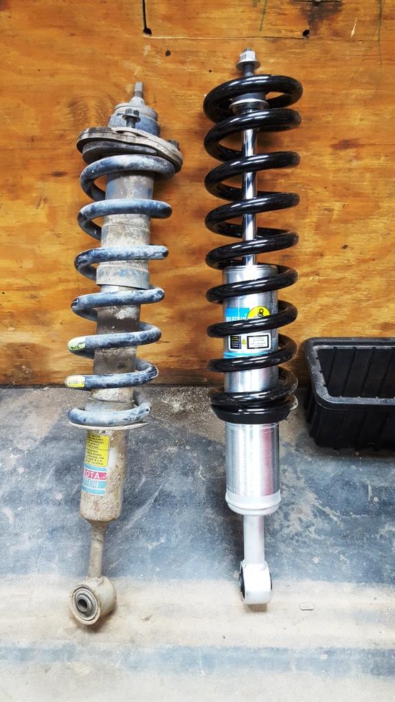

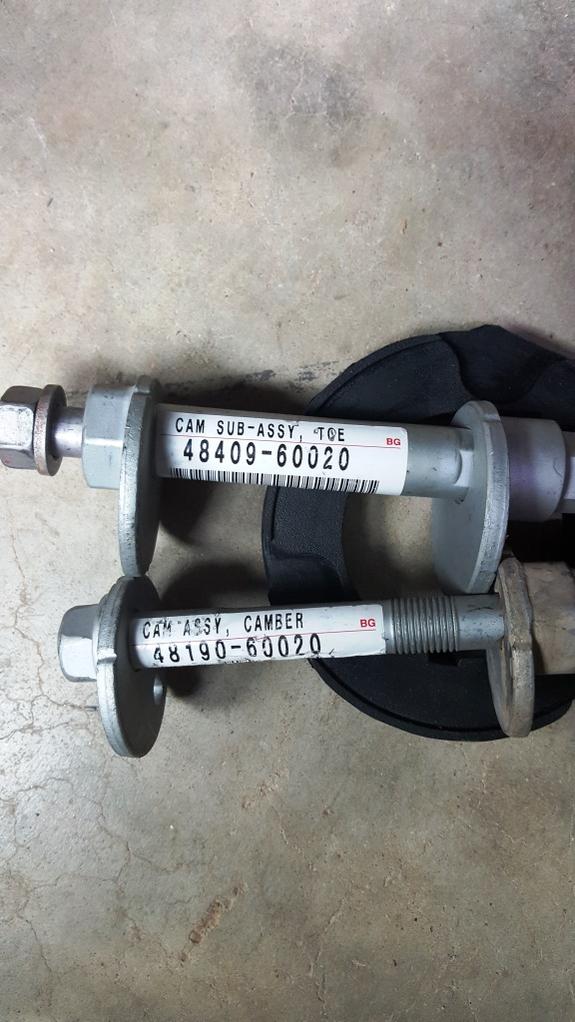

This post is about the front suspension upgrade: LCA bushing swap with Moog and the installation of 6112s. This vehicle is a Southwest vehicle so rust is minimal. However, the passenger side LCA experienced a seized alignment (toe) hardware. Apparently the front hardware is for Toe and the rear is for Camber. A quick strip to the local dealership for new hardware was required.

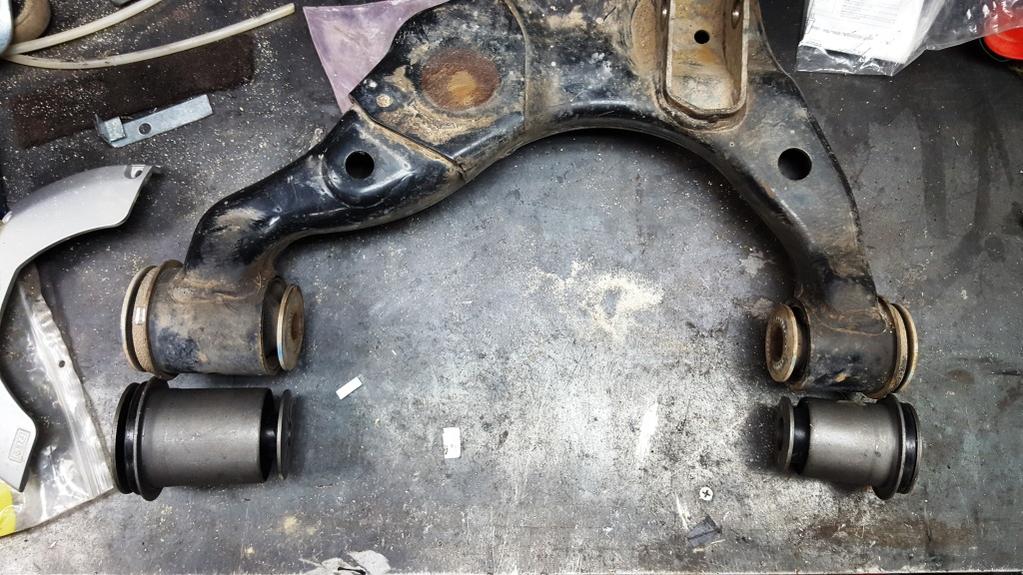

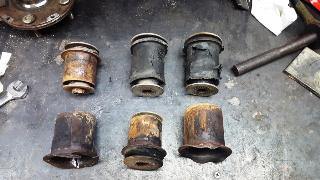

Pressing out the old bushings required the use of a hydraulic bottle jack and a MAP gas torch. Youtube has vids on this. Due to the shape of the LCA, I wasn't able to place it on the 20T press or use the typical BJ press tool. The UCA may allow the use of the BJ press tool, not sure.
This vehicle has 320xxx miles now and I installed a set of FJC suspension two years ago and I think that suspension had around 100xxx miles on them. That was much better than the original 280xxx miles tired suspension.

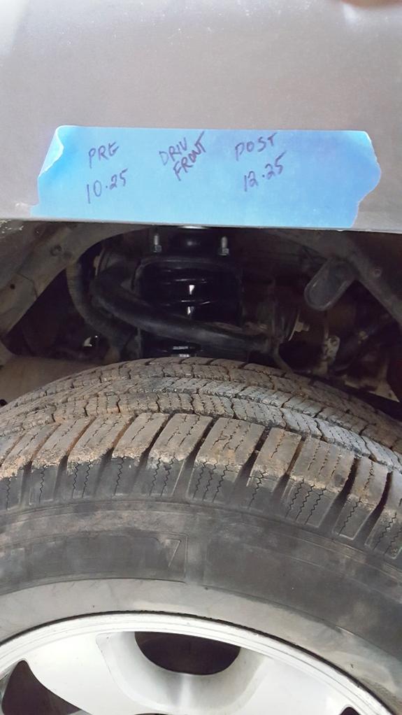

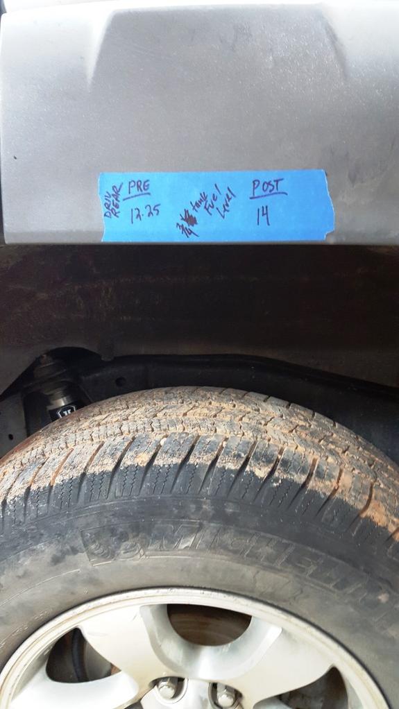

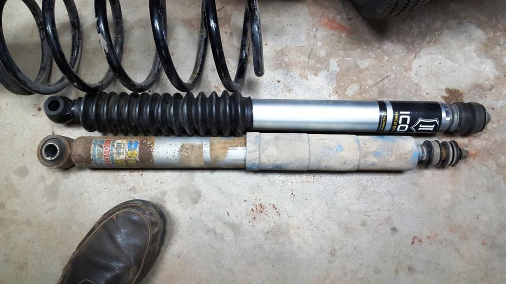

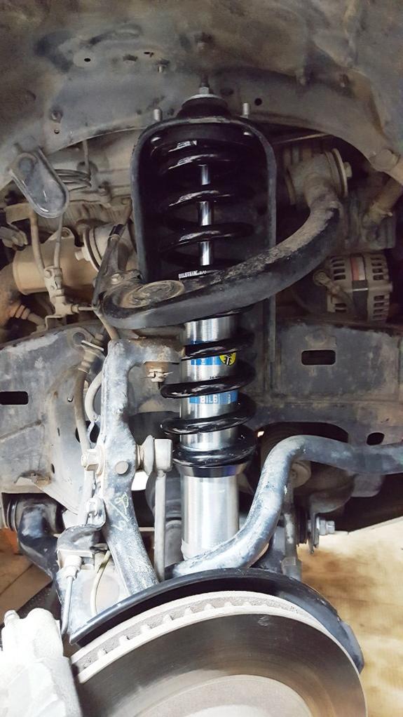

I installed 6112s up front along with 2" Icon VS2.0+Icon springs in the rear. Rear suspension were purchased from members of this board. The total lift was 2" all around, even though there is a noticeable rake. I'm ok with the rake as the vehicle will sink in the rear when we go camping/wheeling.
Per Bilstein's instructions, driver side spring perch was set at #3 from the bottom, pass side set at #1 from the bottom. This results in 2" lift with a stock vehicle (no bumper/winch/etc)

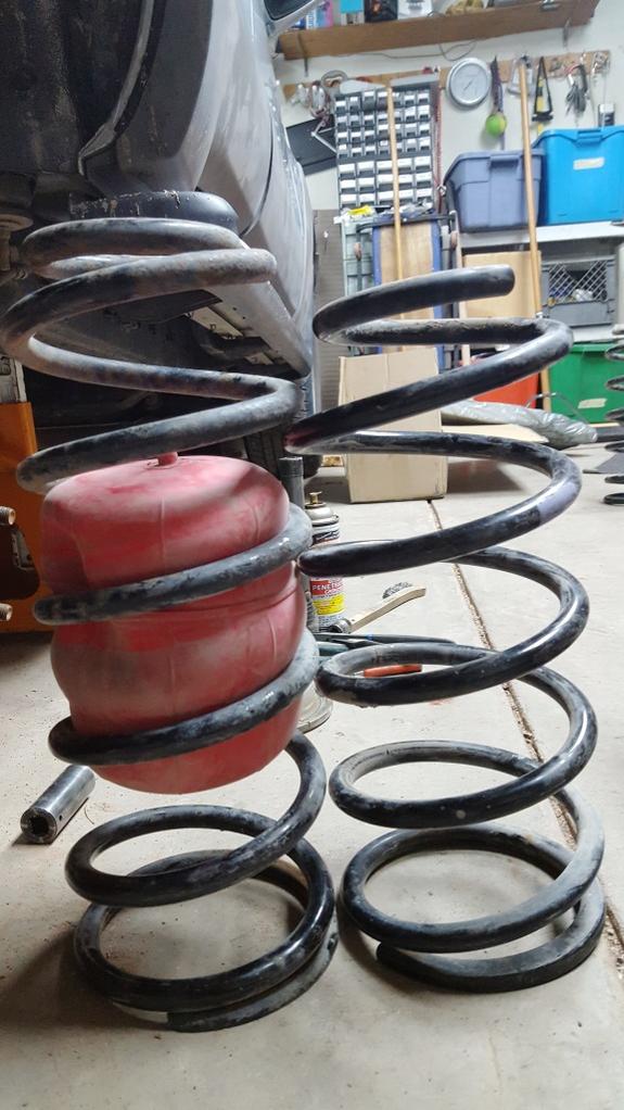

I moved the Air Lift air bags from the previous rear springs to the Icon springs, although I may not to use them. I figured I already have them, might as well use them. Swapping the air bags over took the most amount of time.

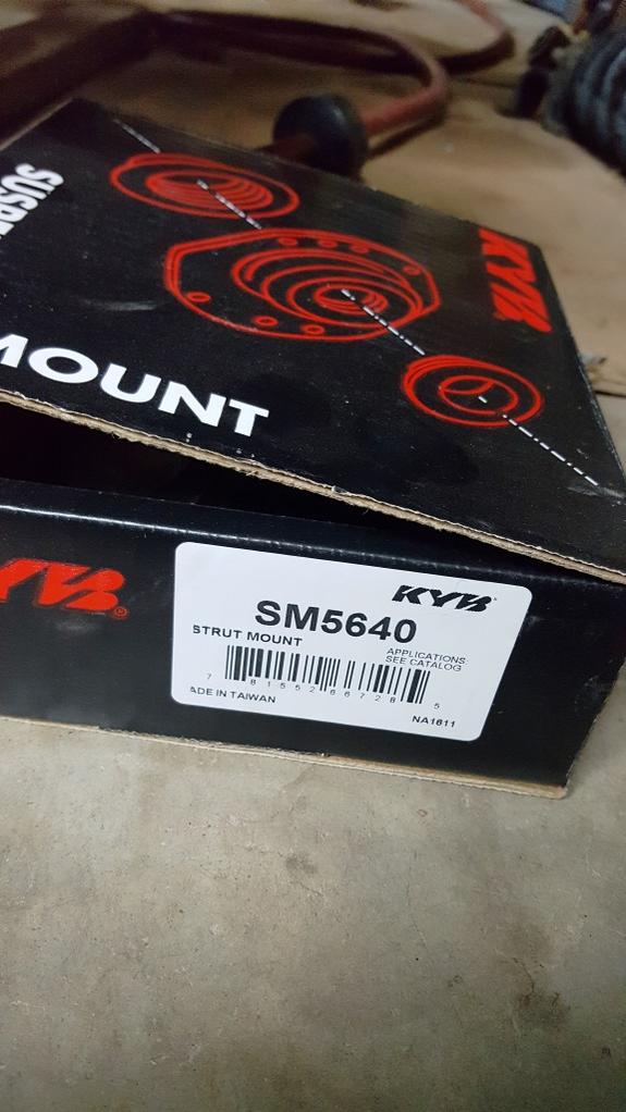

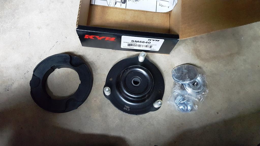

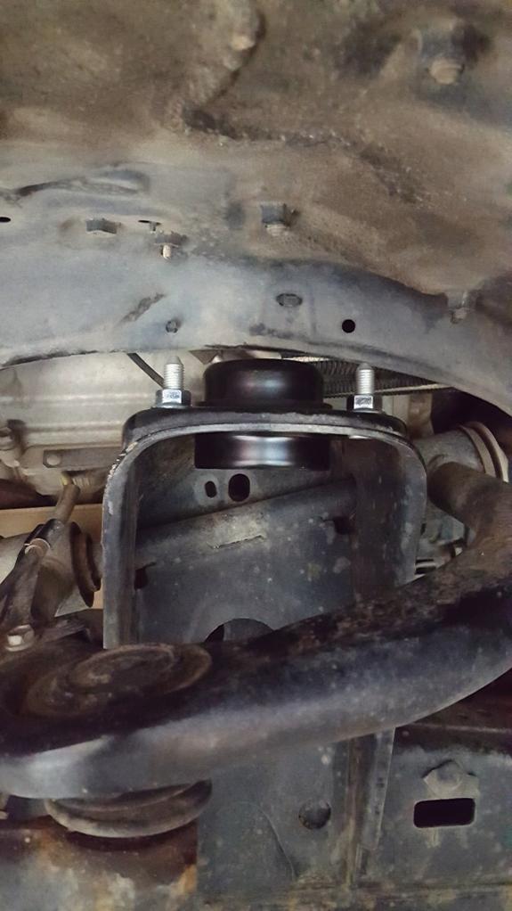

Front strut top hat from KYB/Amazon

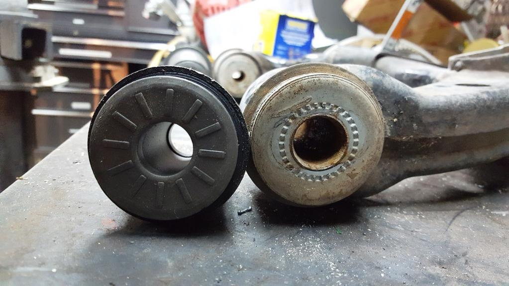

New Moog LCA bushings
New alignment hardware at one location

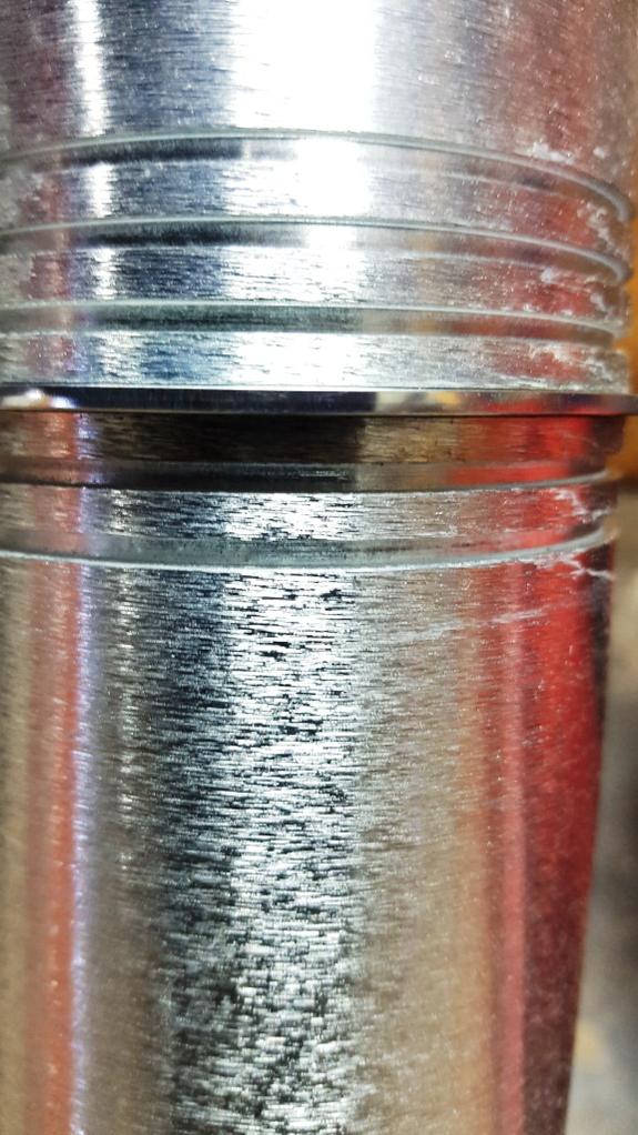

Bilstein 6112 updated with more grooves

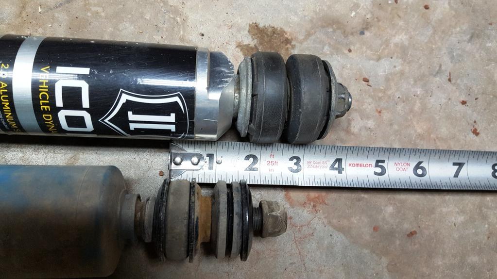

Icon VS 2.0 rear shocks
Icon 2" rear springs

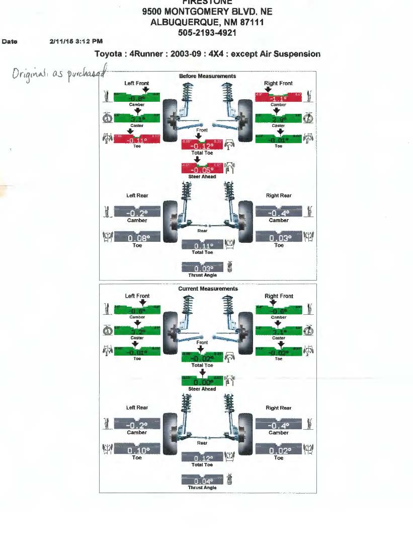

EDIT: my last post has alignment sheets scanned in.

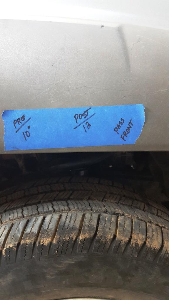

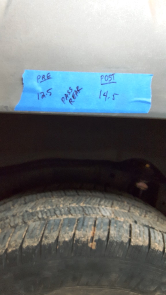

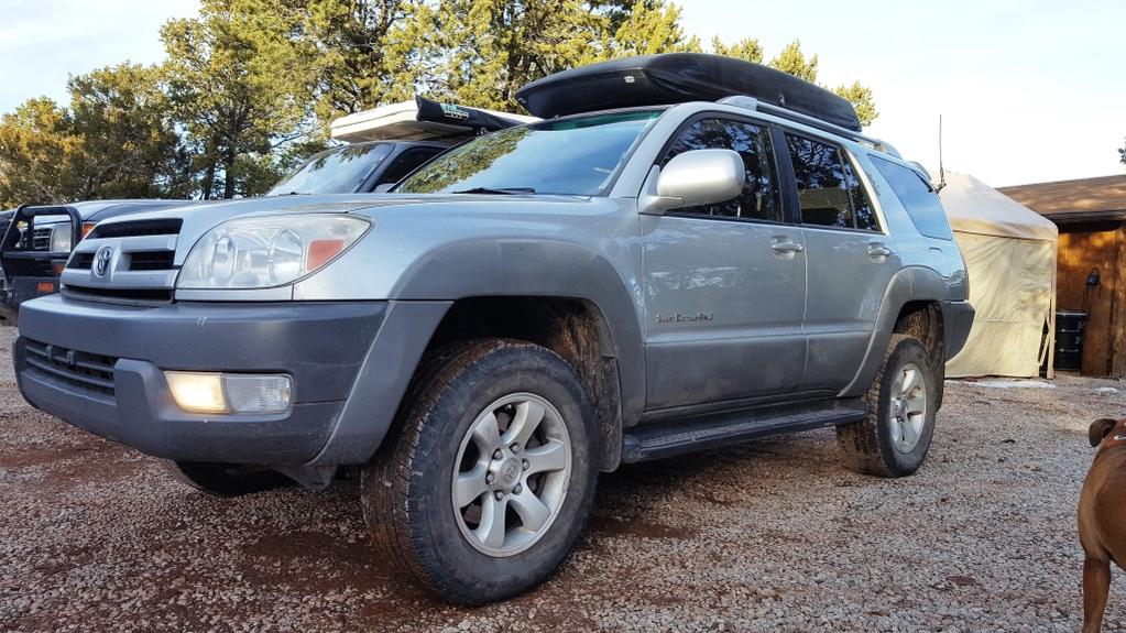

Some more pics for your amusement. The measurements were taken from the fender lip to the top edge of the rims. Fuel tank was 3/4 full.

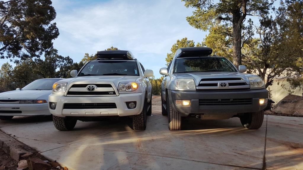

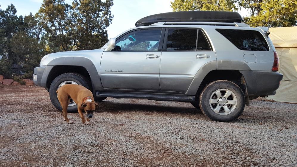

Height comparison with my GF's 2008 Limited V8 with XREAS. When the hidden winch goes on, I'll raise the front to compensate. The last picture is my 80 series on 4" lift and 315s.

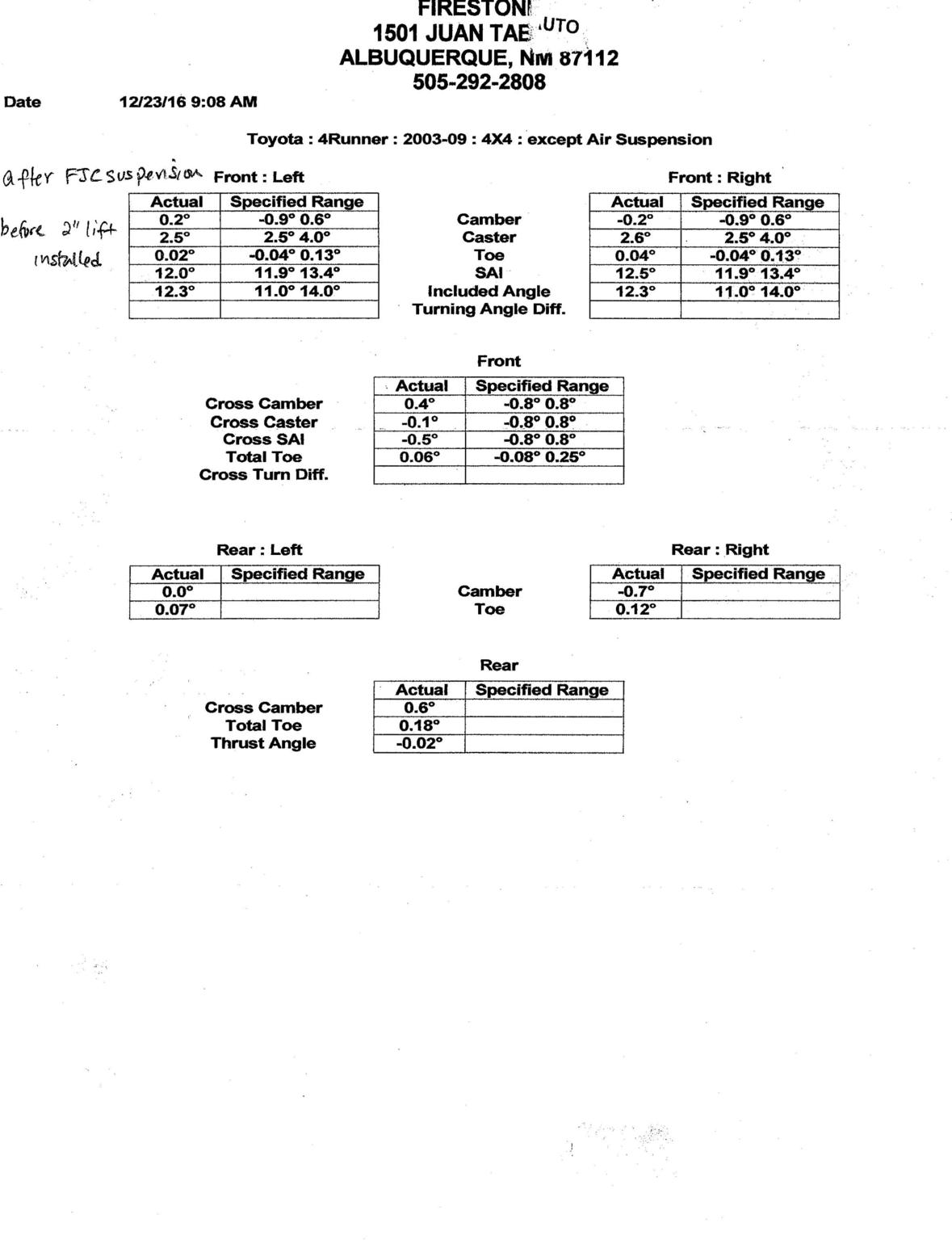

Caster was 2.6 deg before and now at 1.7 deg so she feels a little "wandary" to me. Steering wheel doesn't return to center as quickly. I'll keep an eye out for an used set of UCA to bring the caster back to spec. Camber is spot on.
Removal of the frozen LCA bushings:
Using the bottle jack and the heat method is a good way to remove the old bushings. Unfortunately, two bushings came out without their outer sleeves so that required a more "creative" approach. You can use a sawzall to cut the sleeves in multiple locations then simply punch it out. I happen to have a die that was used to push the sleeve out with the bottle jack.
One of the LCA was stuck due to the frozen alignment hardware. I used a sawzall for a little bit but this took way too long. So, I resorted to a pneumatic right angle die grinder with a 5" cut off wheel. This was a very effective means of cutting through frozen hardware just be sure to wear your PPE. You can see this stuck hardware on the top left bushing in the pic.
Be patient, drink a beer or two and think through this process. It can be rather frustrating to have a frozen bushing.

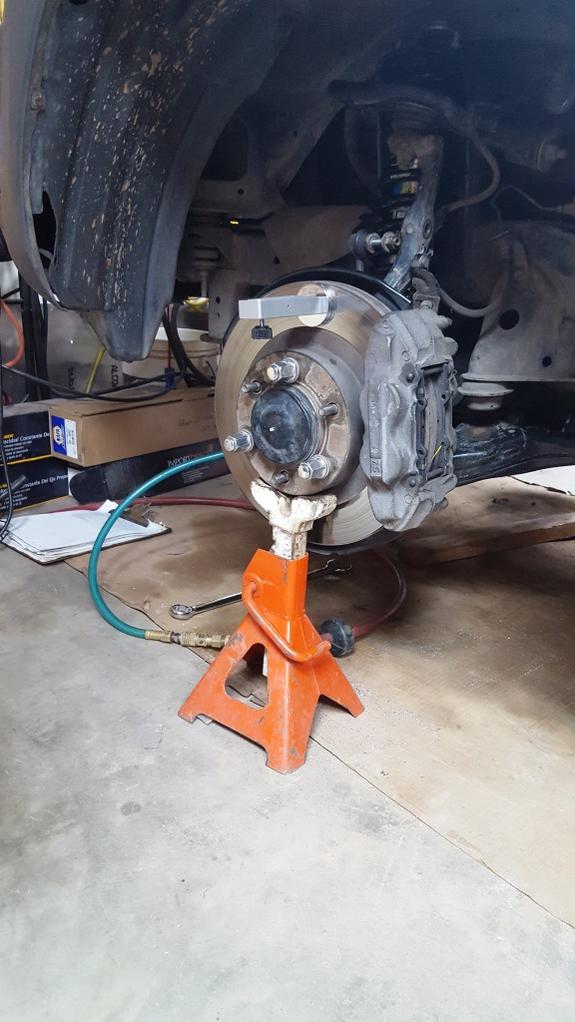

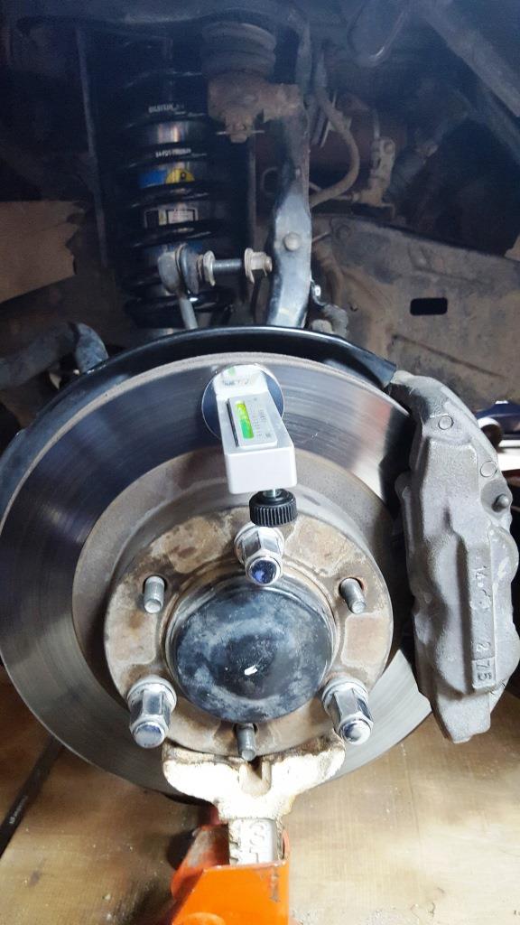

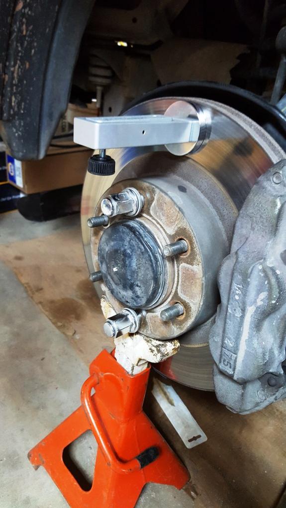

Finally, tightening up suspension hardware. This needs to be done with the weight of the vehicle on the suspension. I achieved this by placing couple of lug nuts on the studs and tightening up the rotor. Lowered the vehicle until the jack stand was fully supporting the weight of the vehicle then I torqued everything down. I still have another jack stand under the cross member but not touching just for safety.

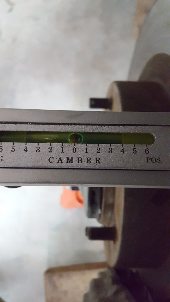

I also use a magnetic camber gauge to set it to zero before I started the whole process. After everything was done, I tried to adjust the alignment hardware so that I was close to reading zero on the same gauge. This is mainly for the drive to the alignment shop w/o wearing out the tires too much.
I am a huge fan of Firestone's lifetime alignment service. I got a free alignment on Friday then went back to the same shop on Monday and compared the printouts. Firestone often has internet promo on this service so keep your eyes open on their site.

I uploaded some alignment printouts for your amusement.

Hmm, didn't I do this on post #2 above? I'd suggest using the rim lip vs the rim center because trying to estimate where the center on the hub cap is not really very precise.
