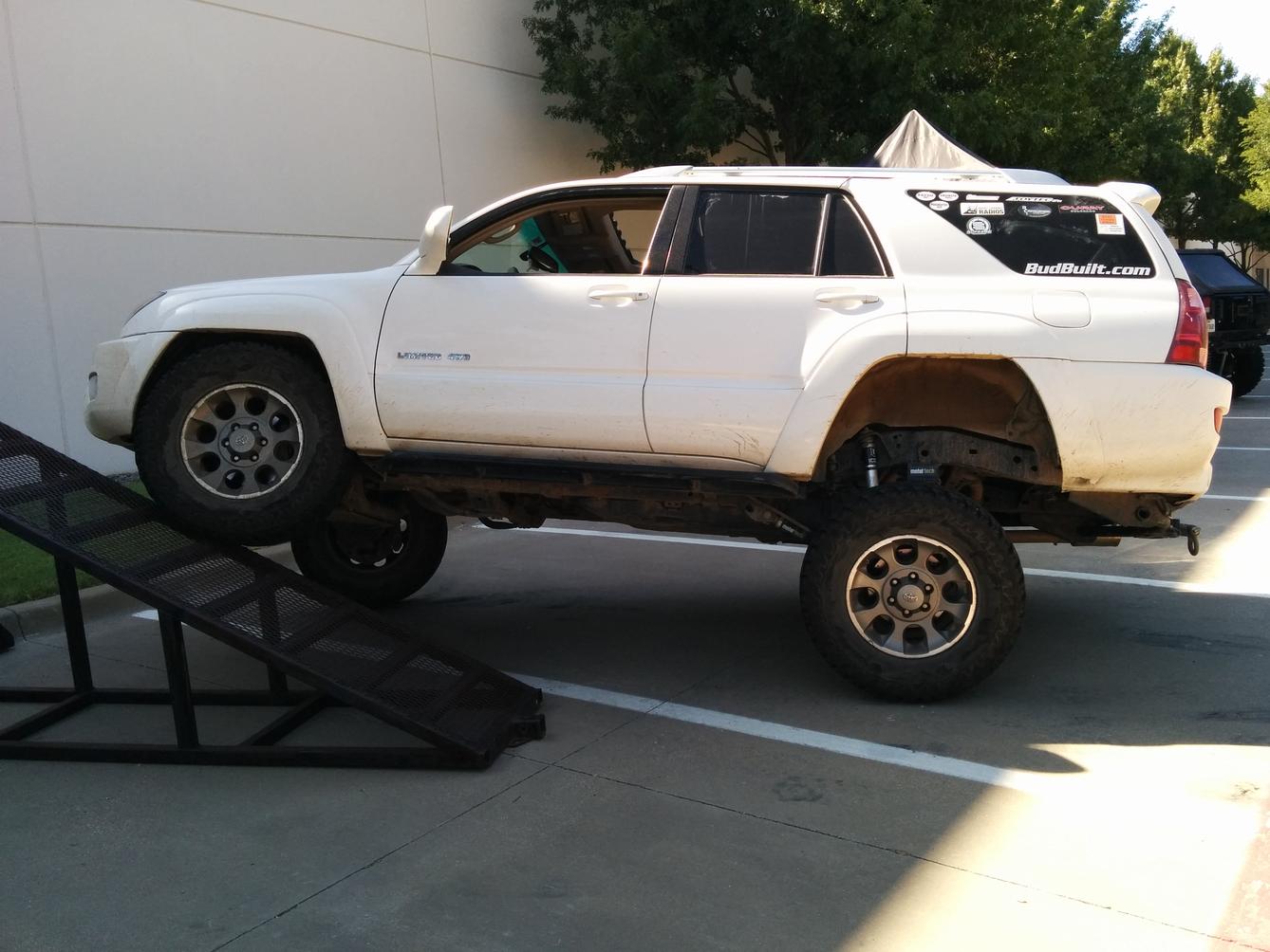

can you show us on picture how much flexing you are getting or how far can the front wheel travels?
heres mine, the straight on one is before i tweaked my front end setup. i now have another ~1.5" of down travel

Just convinced my brother to get there for his Icon lifted 4th gen. After showing him how free my 3rd gen flexes disconnected he was convinced.
