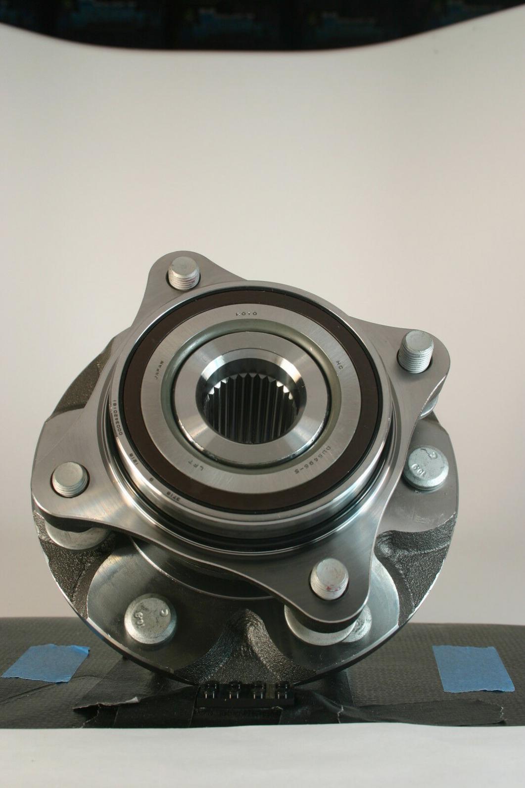

That's what I heard before I went with the Dorman/KOYO unit on ebay. I got it in 4 days, has a 12 month warranty, and is a fair price. Just my two cents...

[MENTION=125326]apohl17[/MENTION]: "Was very impressed at the quality and shipping time of this one from seller 8maggie on the ol' eBay.
2003-2015 4Runner GX470/460 4x4 complete KOYO Front Wheel Hub bearing assembly | eBay
Dorman Assembly + Koyo Bearing + Toyota seals, bolts, and o-ring... Solid."
8maggie is marionbumper2bumper on ebay btw
