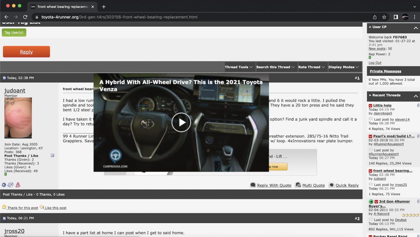

Oops, sorry I misread that because for some reason on mobile this giant video keeps loading over the first post... I was basically refreshing and trying to read what I could before the video popped up.
But okay yeah that is really weird that it won't press out

Toyota wants me to upgrade to their new 2021 Venza.... Not in this market!
