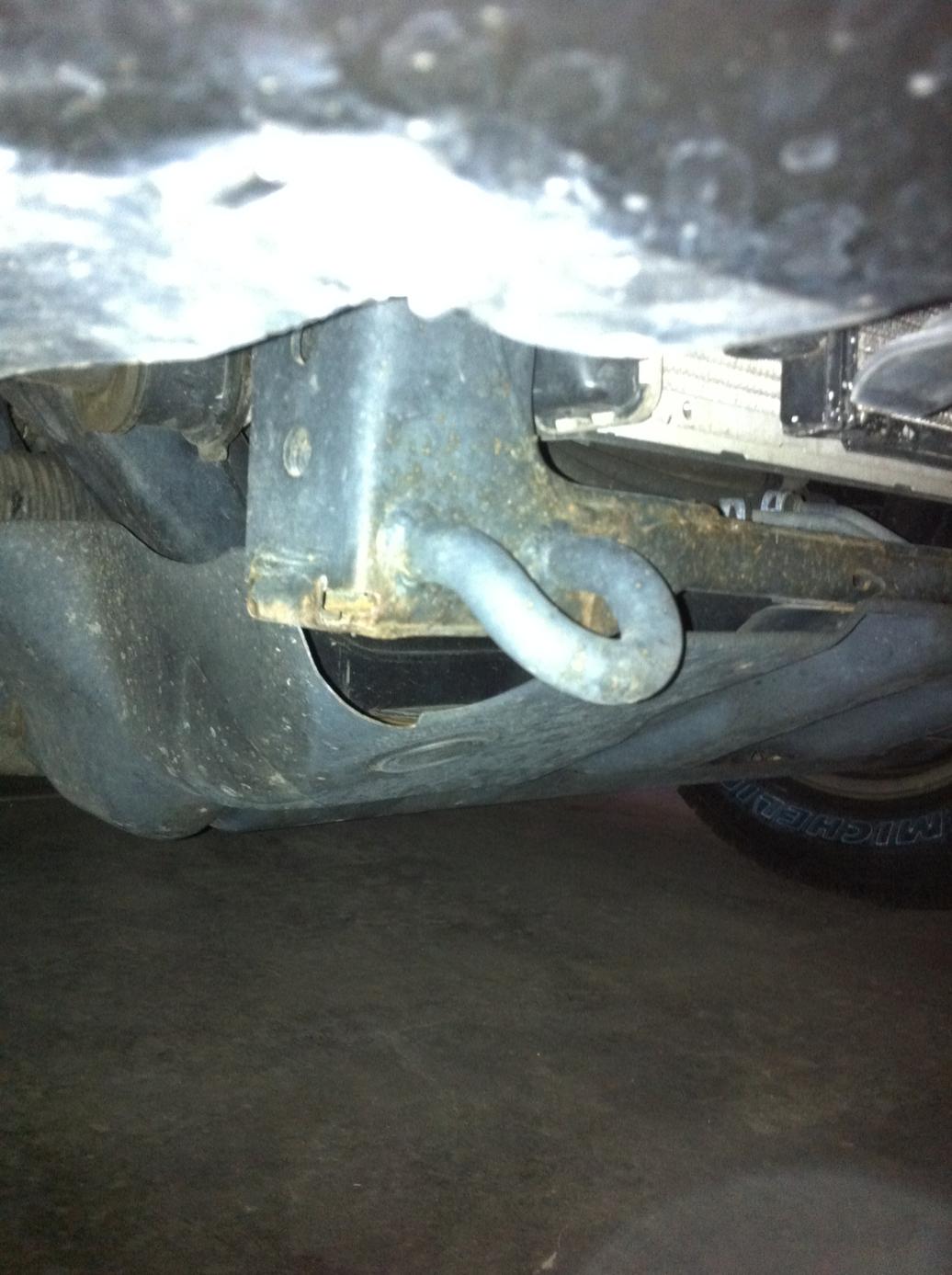

Thanks for the links. The first looks interesting as a permanent mount. Thinking more of a portable mount like the second link. As mentioned I'm familiar with the Curt mount however haven't figured how to deal with the different tow hook arrangements. The 06'-09' have tow hooks welded to the middle and tilted down 45 degree while the 05 hook is welded to the bottow pointing straight out at 90 degrees.
Anyone have a close up pic of the 06-09 tow hook?

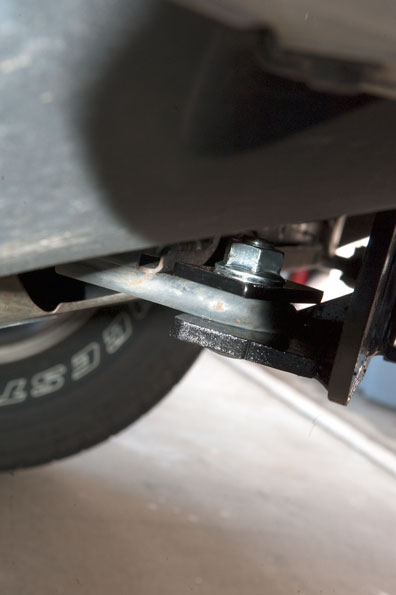

a post on the last link says this> I have an 04 and put this hitch on. You are on point about the tow loops. The tow hook mounts on the hitch are at a 45 degree angle. You can actually put the hitch on without attaching to the tow loops, but those add strength and are necessary. The solution is to cut out the gussets on the hitch's tow loop brackets, heat up the weld on theses brackets and bend the bracket down to a 90 degree angle(perpendicular to the face of the receiver socket) and re-weld them to the hitch. This way the brackets are now in the same plane as the tow hooks on the 04(and assuming 05 here), and you can bolt the hitch mounting brackets to them. They actually line up quite nicely. I too am buying a portable hitch mounted winch plate and a warn M8000 in the near future. I you are not comfortable using an O2/acetylene torch and a mig welder I would take it to a shop with these capabilities. It is not hard to do, but does require access to these tools and a comfort level using them. hope its of some help. i think MOMO mounted the hitch into the front bumper
Thanks for the pix Travis, certainly different tow arrangement than my 05'

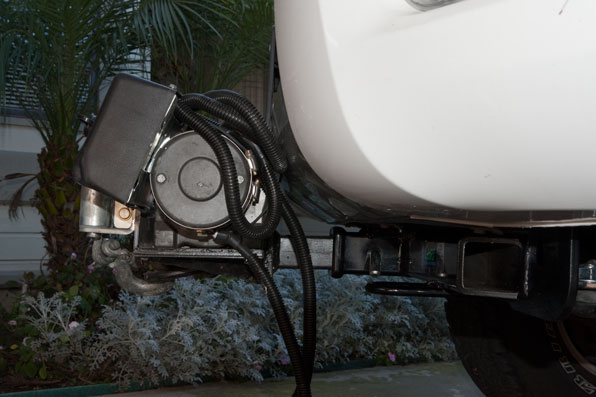

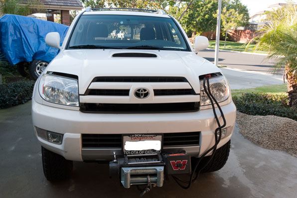

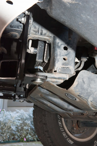

Here are pics of Curt 31367 installed.
