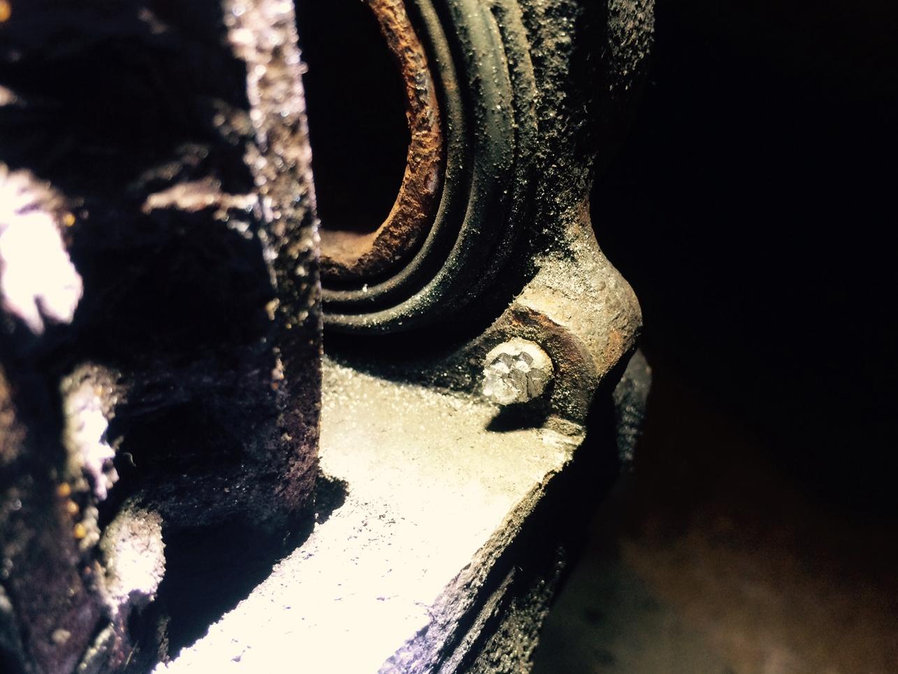

The lower caliper pin in my left front caliper is frozen. I have cut out all but the part frozen which is on the inside but can't get it out. What is left is basically filling the hole. May need a new caliper. Any suggestions? Could I drill it out? If not, should I spring for a Toyota caliper at over $400 or go with an after market one for less than $100?

A little more information would be very helpful to those attempting to assist e.g., what year is the vehicle, how many miles on the clock, a photo of the immediate area in question will give a trouble-shooter a much better vantage-point to assist you with this, :D

It's a 2011 4Runner limited. About 99,000 Miles. Photo attached.

Had a similar problem with my 4th gen. Spent a while drilling it out and it worked fine but the other pin gave me all kinda problems. Checked NAPA and they sold the remanufactured Toyota calipers for around $70. Went that route and didnt regret it. Check around for prices and lube those new pins up real good.
Pistons are looking pretty haggard - if it was me, I'd just replace the entire caliper assembly. You can never go wrong with fresh parts. Personally, I'd probably even replace both caliper assemblies as a pair, but that's just me. You could try drilling it, but I'd bet that the pin isn't even sold separately.
The pins are actually sold separately; about $6.50 each.
Pull off the caliper and get it on a bench... Carefully try some heat then ice the pin...You may still need to drill it out. Maybe take it to a machine shop if you don't have a drill press... Not sure how hard those pin are.
