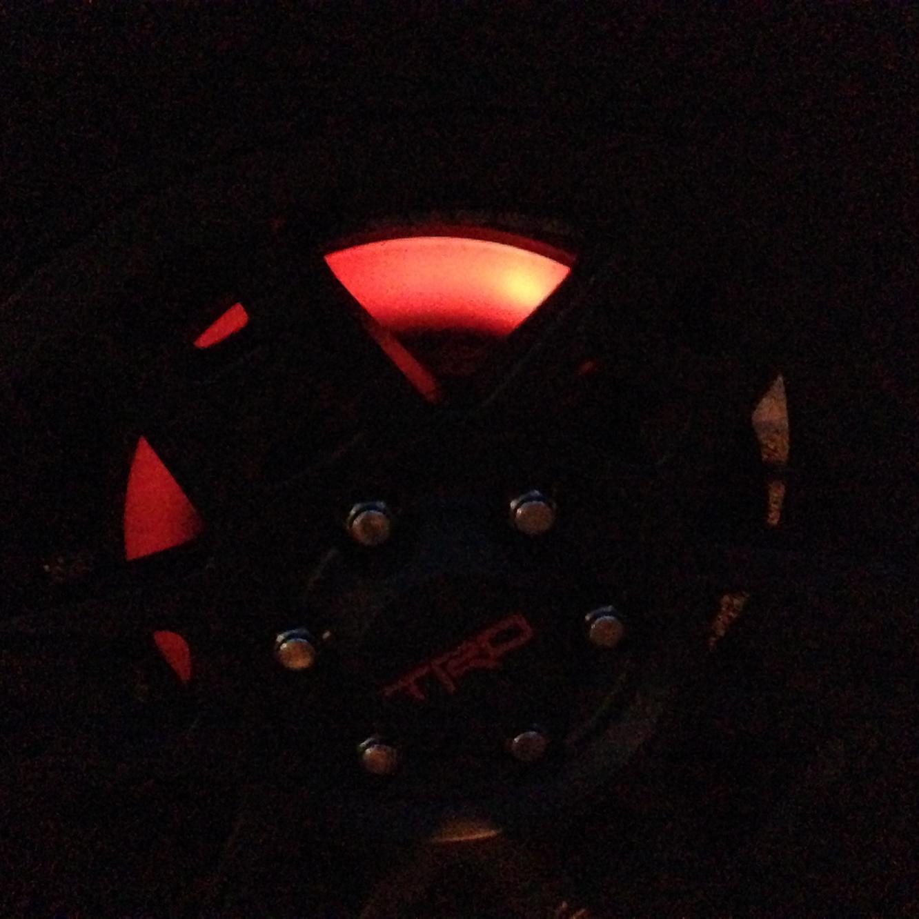

Frozen Calipers - How many others had this problem?

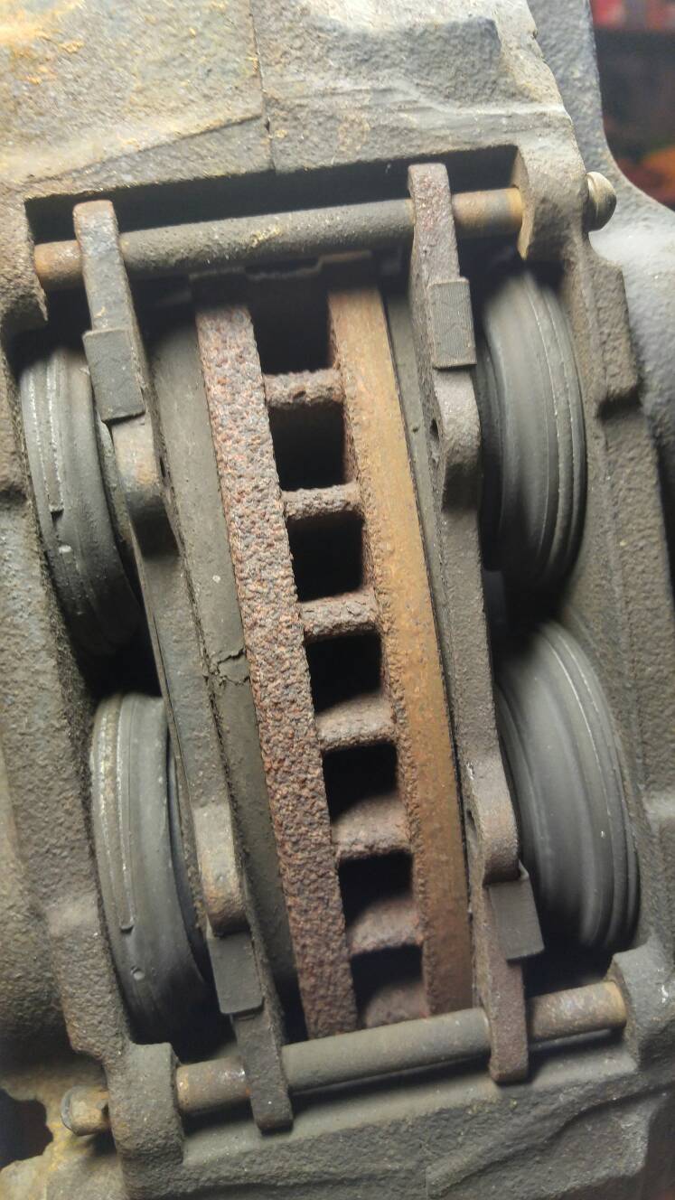

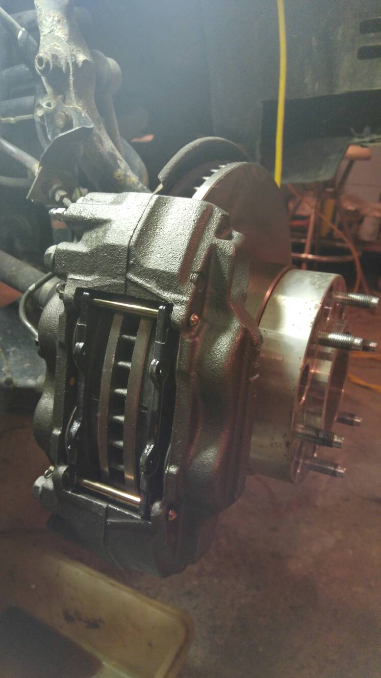

Mine started a month ago...pulled the wheel off and found this...
$200 later and a lifetime warranty from o'reillys and here's the result.
Drives like a dream again!
Sent from my LGUS991 using Tapatalk

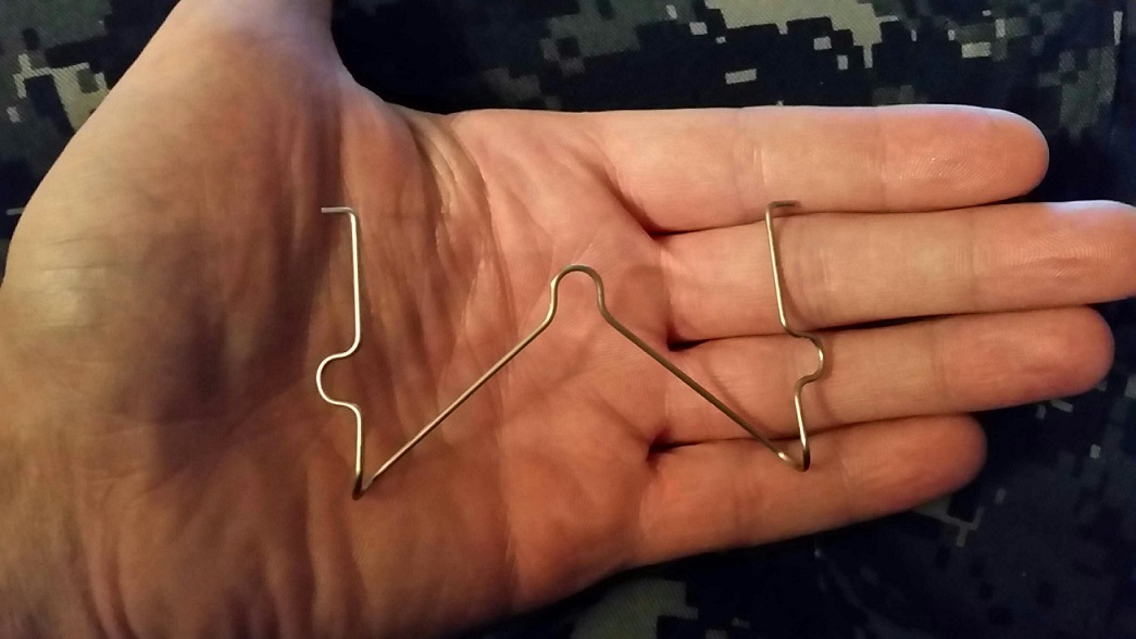

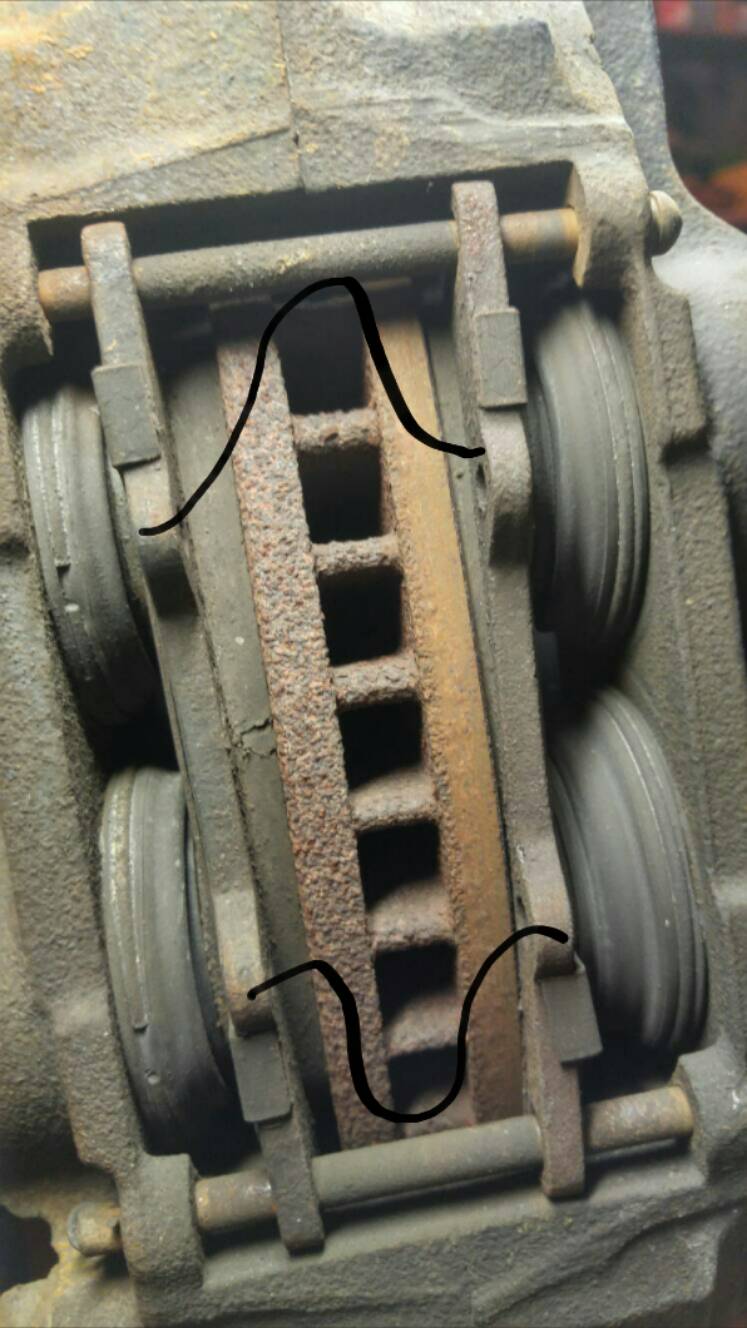

My brakes have a spring installed between the pads that spread them.
My plan to combat this common sticking caliper issue is to install two springs instead of just the one already installed like so. Forgive my editing skills.
Let me know what you guys think. I'm sticking with the smaller rotors and 13WG calipers btw.
Those just rust away right away where I'm at. Just threw em in the trash...
Well just look at the picture up above and tell me this spring wouldn't help prevent this issue. It's there for a reason. Not replacing them is IMO pure negligence.
Edit: Let me elaborate a bit... brake systems are a closed one way hydraulic system. When brakes are applied the fluid goes to the pistons and extends them. There is no hydraulics that returns the piston back. There is the release of pressure and perhaps some some other fluid dynamics involved but for the most part the "W" spring is a return spring which is the main factor in piston retraction in the OEM brake system. It's essentially going to prevent both premature pad wear and sticking calipers.
Edit2: Another thing to note is that the OEM has these springs on the bottom for a reason too.. the rotor rotates forward and the lower part of the pad is what bites and will wear faster and thus uneven without a spring.
Edit3: To add on to the reason for sticking calipers is when you have uneven pad wear your piston is going to be placing the force upon an uneven surface on the back of the pad causing the piston to be cocked one way and voila you have a stuck caliper piston.... all because of a spring.
Now if there are stuck calipers on 4Runners out there with springs I suspect not all pads come with these springs so when someone is replacing their pads and they don't get a shiny new spring to go with it they just reinstall their rusted spring instead of replacing it as they should. I'm done.

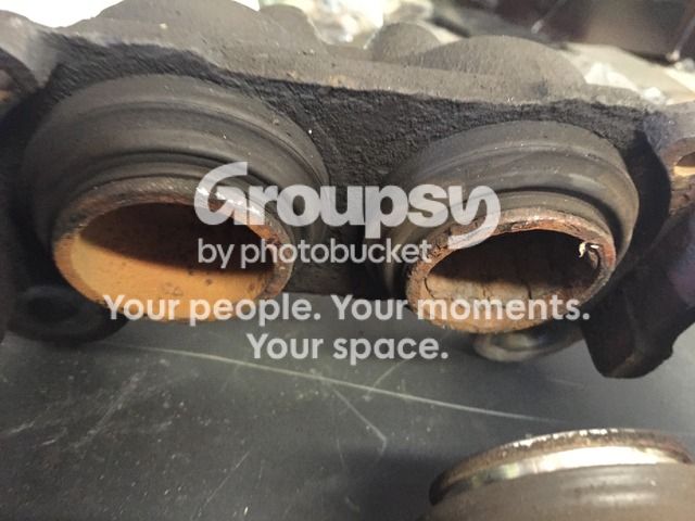

Did pad/rotors all around this morning and had a serious "frozen" issue (and I'm not talking about Disney Animated movies). Both front calipers, both the lower inside piston.
IMG_4017.jpg~original
No symptoms whatsoever; no pulling or dragging, although my MPG isn't as good as I think it should be.
I went to do a brake job on all 4 wheels. 3 out of the 4 were frozen. Went ahead and replaced them all. Had no symptoms at all, just would not compress for new pads

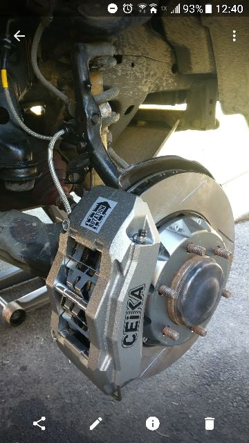

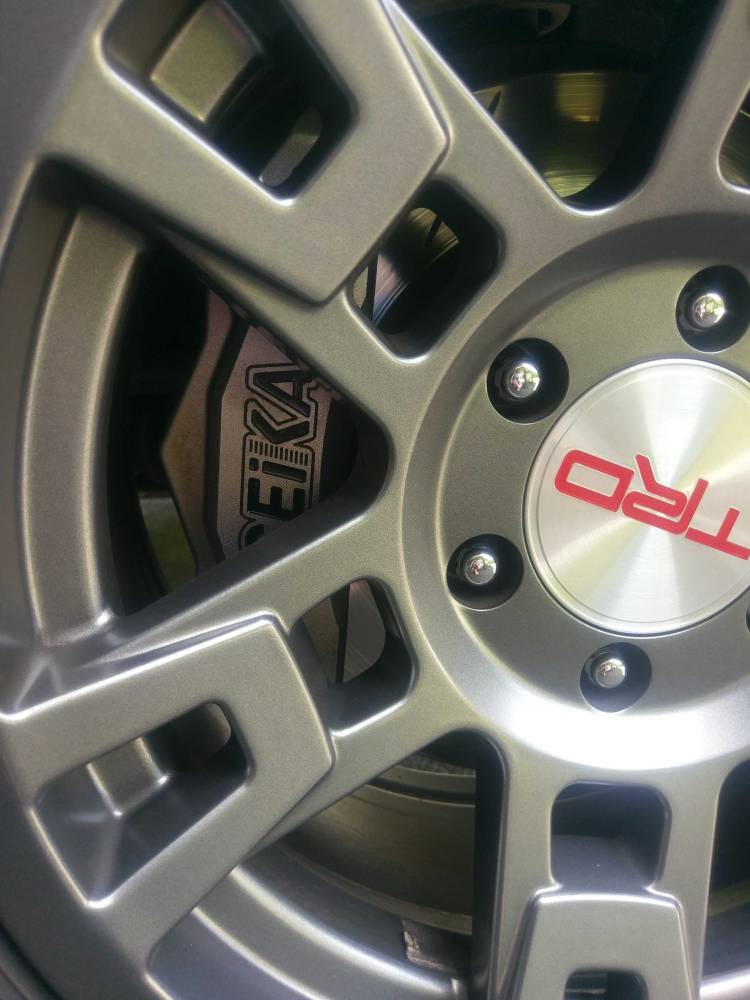

I was so sick of my frozen/stuck calipers bit the bullet and significantly upgraded my front braking system with this. Have about 20k on them and zero issues still feels smooth as glass when braking.
Sent from my HTC6545LVW using Tapatalk

Good advice. Each year, after winter and/or after beach driving vacations I disassemble the brakes to clean and lube them. Not only do I clean the slide pins with a wire brush and re-lube them, but I use a drill-mounted wire brush to clean the INSIDE of the pistons. This is where water accumulates and starts the rust process. Once rinsed with brake cleaner, I lube the inside of the pistons and the seals with NAPA Syl-glyde. Then I remove the pads and shims, clean em up and apply fresh lube to the back of the pads. Finally, I learned from sportscars that you need to bleed the brakes every year, not every 2 years. Brake fluid is hygroscopic and you want to minimize the water in the fluid that is contacting the other side of the pistons.
After I learned my lesson replacing 2 frozen calipers I implemented this process and have not replaced one since.
