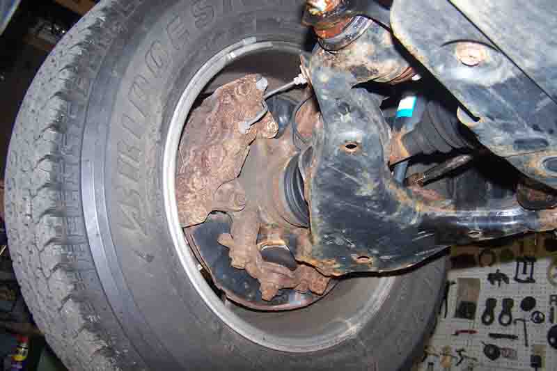

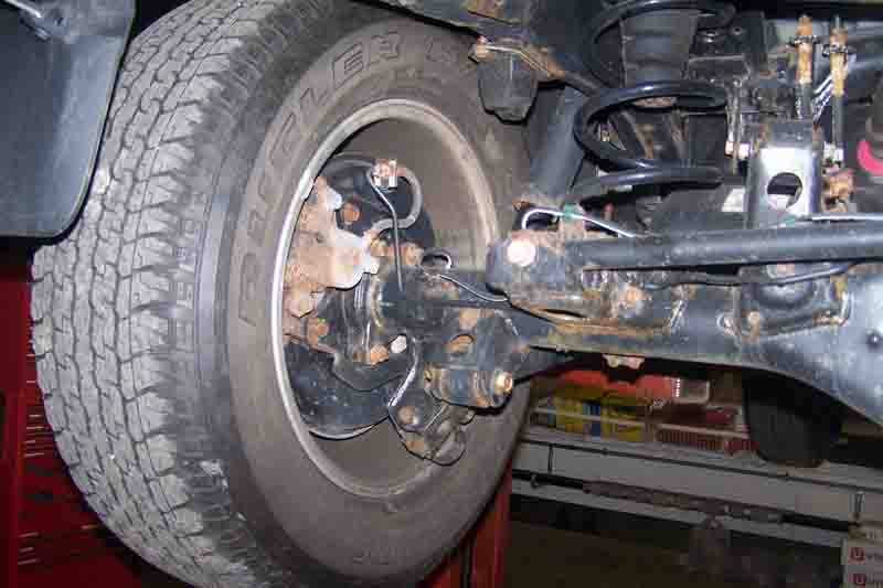

Not yet but I get the feeling my time is coming soon as illustrated in the photos...
The company that makes & sells POR15 will love me as I have used their product on my 4Runner's undercarriage twice now since I have owned it.
The first time I should have just painted the entire undercarriage not just the areas that were rusting.
The second time (about a month ago) the 4Runner spent the better part of a day and a half on a lift while I did the whole undercarriage.

Holy crap..that's a lot of rust!
charlier180,
I'm in San Francisco, CA...living by the fog & the beach and I think my under carriage looks pretty much the same.
CJ3Flyr,
I think I'm going to follow your suggestion.
Those photos and others of the frame and undercarriage that I did not post were taken on October 30, 2009. Granted my 4 Runner is 5+ years old now.
Sad part is the rust started around years 2 or 3 of ownership. That is when I did the first application of POR15.
FYI, I live in Eastern Pennsylvania and my 4Runner does not get to see the inside of my garage at home. I suspect that others here may have similar amounts of rust on their 4Runners that they either are not aware they have or are ignoring. Sad to say my 25 year old VW daily driver has VERY, VERY little rust compared to the 4Runner. VW might have a lot of other issues but undercarriage rust is not one of them. At least from the mid 1980s going forward.
