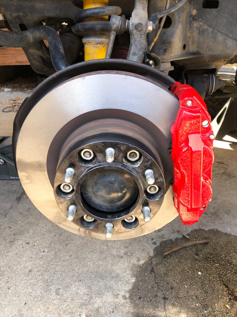

Just replaced the 5th gen seized calipers with new painted powerstop calipers. Hopefully these should last more than a few years! Just need to bleed them again in the morning since it wasn’t enough after a short/scary drive. Really hoping this solves the braking issues I was experiencing. The guy at Oreilly said one of the rotors showed signs of high heat (the seized side).
Just replaced the 5th gen seized calipers with new painted powerstop rotors. Hopefully these should last more than a few years! Just need to bleed them again in the morning since it wasn’t enough after a short/scary drive. Really hoping this solves the braking issues I was experiencing. The guy at Oreilly said one of the rotors showed signs of high heat (the seized side).
can you clarify the first sentence? you said you replaced the seized calipers... with powerstop rotors. did you mean calipers?

Yep, fixed, thanks.
My brake pedal feels worse now though. There's just a weird hiccup in the first bit of travel and then long travel before it bites well. I had a friend help me bleed them twice now and it got better each time but still not as good as they used to be. I went out to the country and tried bedding them in with 4x 60mph-20mph hard brakes until I smelled the burning, and I'll probably do that again since the rotor surface still doesn't look proper per se.
Also I kind of think O'reilly screwed up my rotors. They called to let me know they were going to be taking quite a bit off of one since it was really warped and wanted to make sure there was bad vibration during braking. There really wasn't terrible vibrations before, but they said one of them showed signs of heat which was probably the one with the seized pistons. Now I feel like I get worse vibrations.
I'm over dealing with this so I'm taking it to Firestone (was going for an alignment anyway) and going to ask them to check the rotors for warpage, and if they're good I'm just going to have them do a brake flush/bleed and be done with it. If the rotors are bad I'll be ordering the Powerstop rotors, doing that, and then going back for the flush/bleed.
