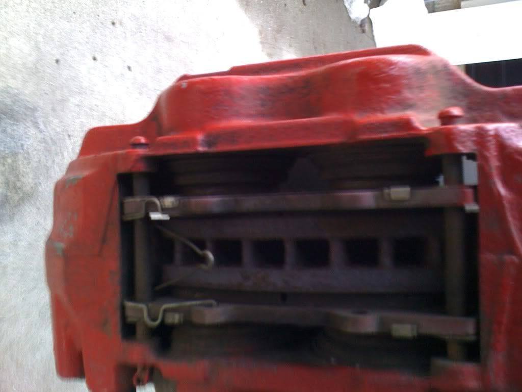

Just did new front pads on my rig. Did it because I felt like my braking was really starting to lack the bite I was used to and figured they were worn.
Took a picture of what looks like the inner pistons (this is a driver's side view) were seized. Notice how much more pad there is to the outer side:
IMG_0315.jpg~original
Sorry about the photo quality, but i hope you can make it out.
I cranked them back in and put the new pads in. Seems to be stopping ok with the bite I'm used to again. Passenger side was the same story. I wish I remembered all these issues 4Runner's have with this and left it alone to take to the dealer. I have extended warranty and no doubt they would've swapped out the brakes. I have 55K btw. I'll keep an eye on this and may still take this in to get scoped out.
