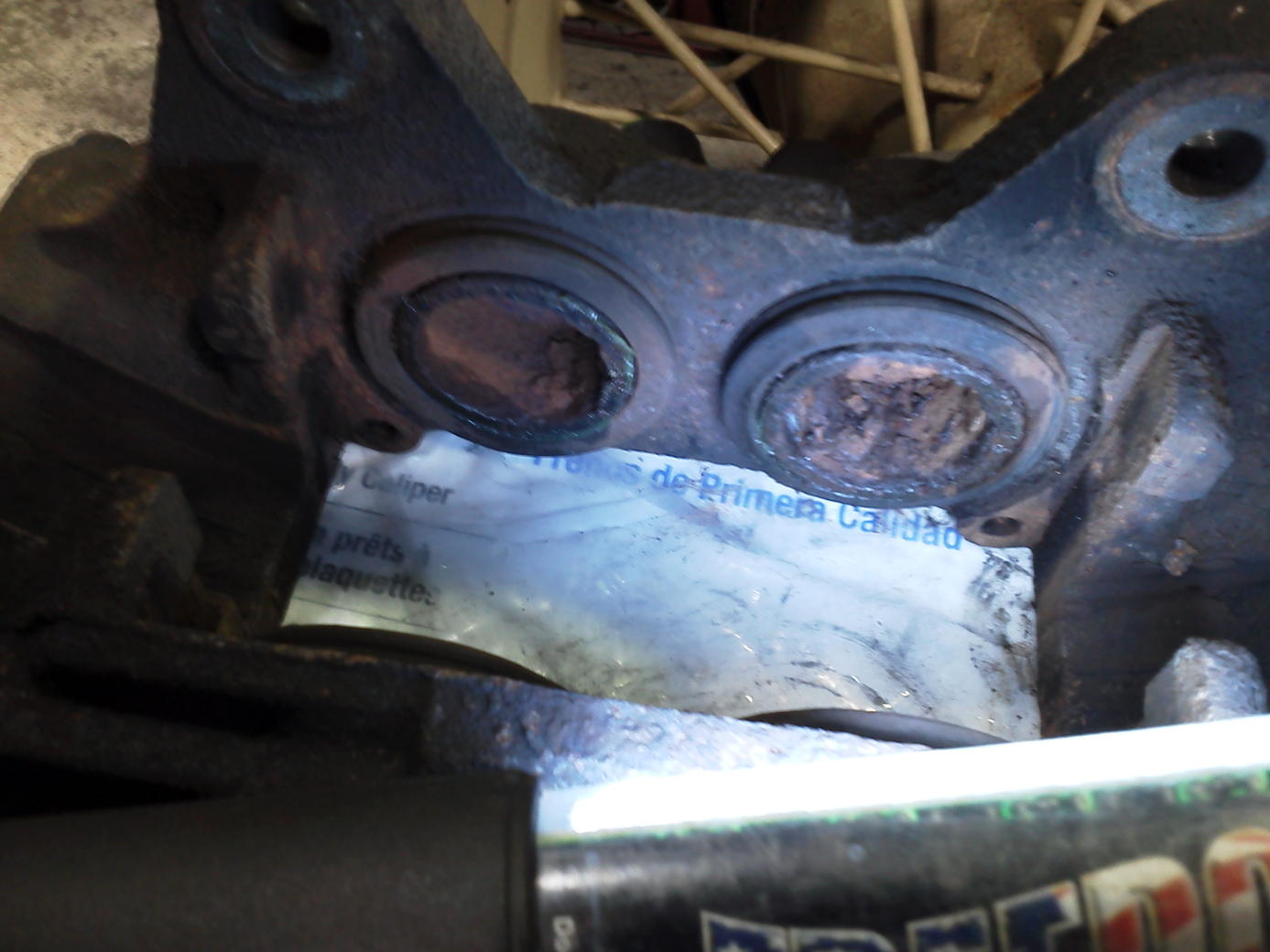

Just replaced the same front caliper that seized at 64K after replacing pads. This time I made it 30K. Had auto zone rotors and Cmax pads with a re-manufactured Toyota caliper installed at 64k at the dealer when at around 94K wife was complaining of pulsing.
So I got new rotors and pads again and I went 5 miles before the caliper would not release. It was the lower piston that would not retract...again.
Wow...30K and the same caliper fails. I think they make these calipers to do just that, fail, or piss poor design on the truck.
Look at the corrosion inside the piston. What junk. I went with a caliper from autozone this time. I least they have a 2 year warranty. I got one year with that junk Toyota caliper and made it 1 year 10 months.
Very disappointing. We have to plan on replacing calipers whenever we touch this brake system. What garbage. I guess its the price we pay for no other issues or problems to deal with.

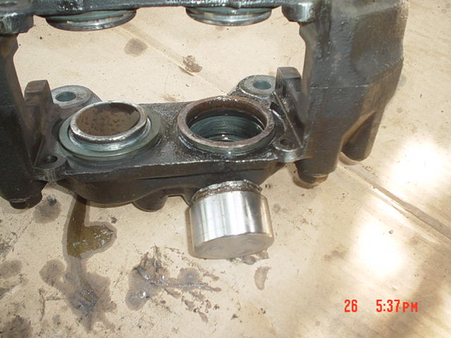

I had to replace the right front Caliper. One piston was stuck (rust) around the outside of the fluid seal. I broke it loose but I damaged the piston. Toyota sells pistons and seals. I did this on a Sunday so I bought a rebuilt Caliper from NAPA.I rebuilt the drivers side with new seals from Toyota.
