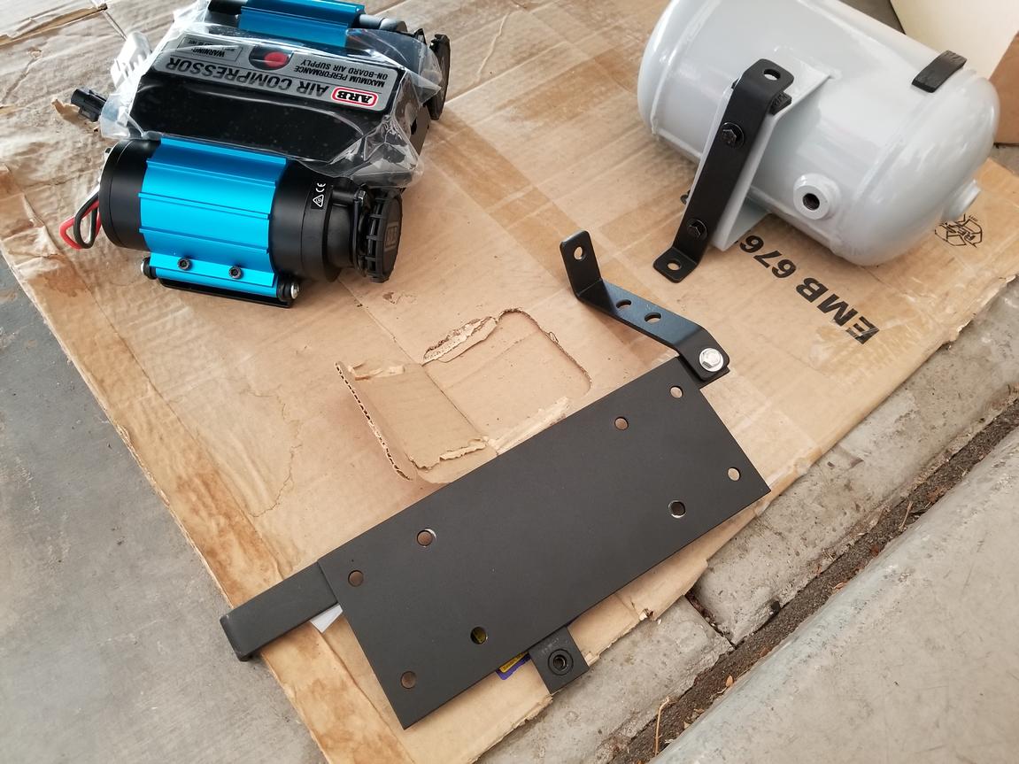

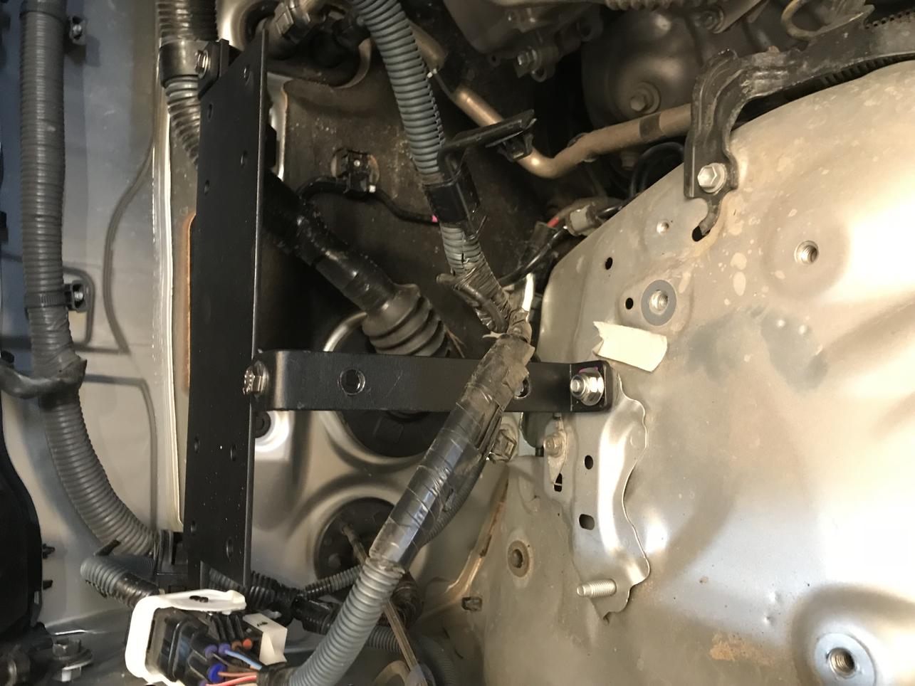

I'm not sure if I got the correct kit. I ordered the Shrockwork spare battery kit for my 2017 4runner with smog pump relocation bracket. Got the relocation bracket in and can't see how the Viar 1gal tank and ARB go in there with the kit you sent me. Any ideas or photos of completed setups?

Just following up on the above message, PM, and email. I know you're busy but I'd sure love to know how to finish my install and if the parts I received were incorrect dimensions somehow. Thank you.
Leroy- sent you a PM regarding fitment/install as well- please let me know what I’m doing wrong...
Simple dual compressor mount but the firewall arm just doesn’t seem to line up.
Thanks!

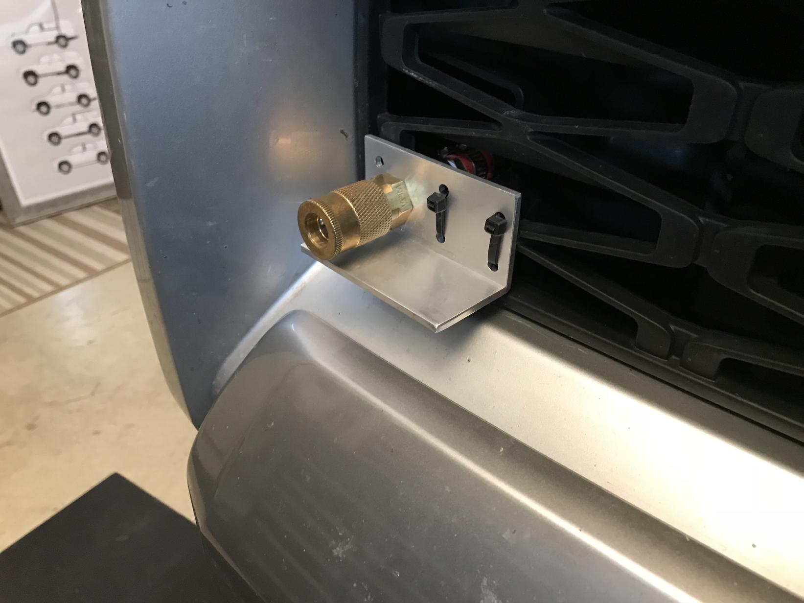

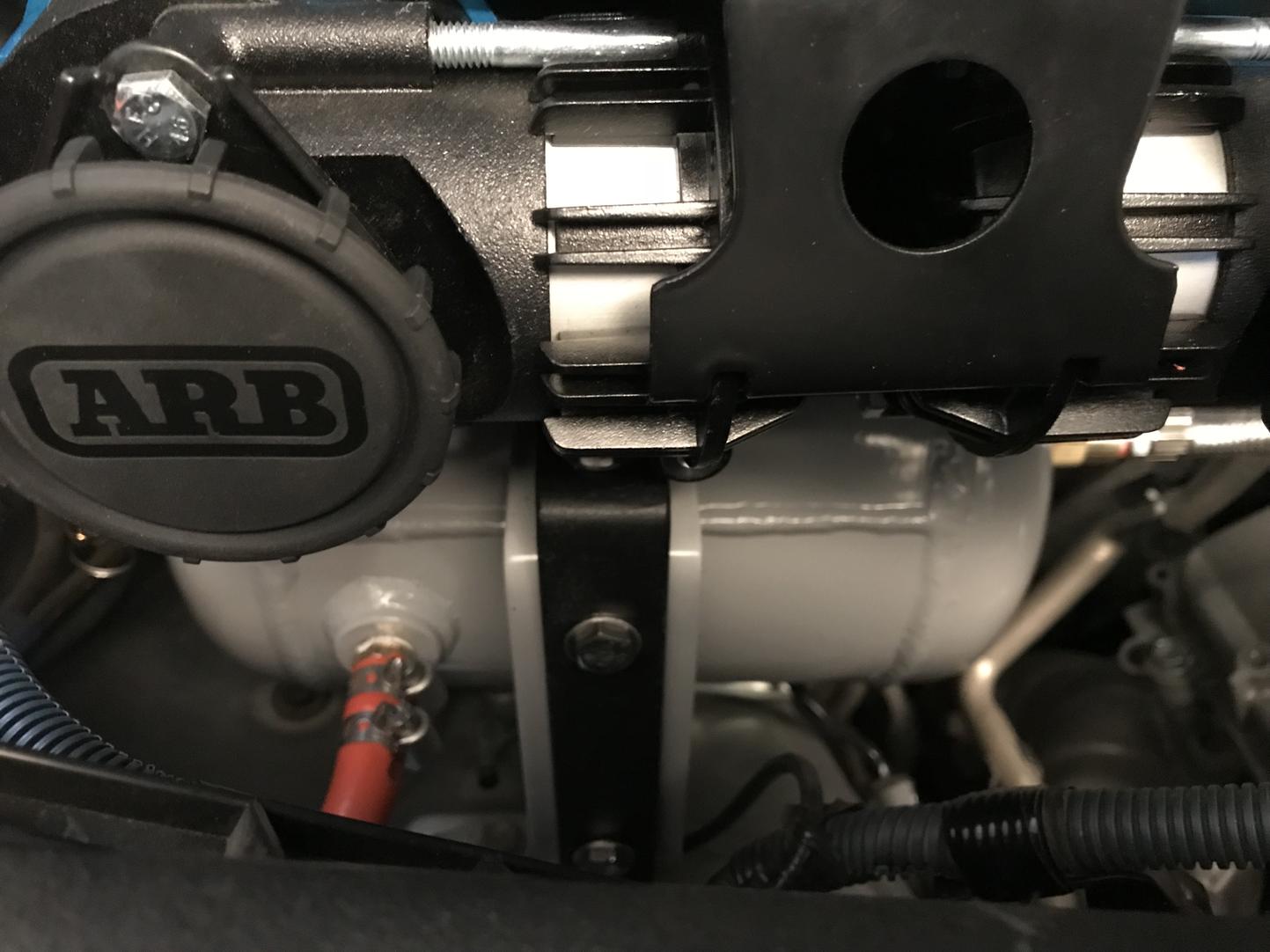

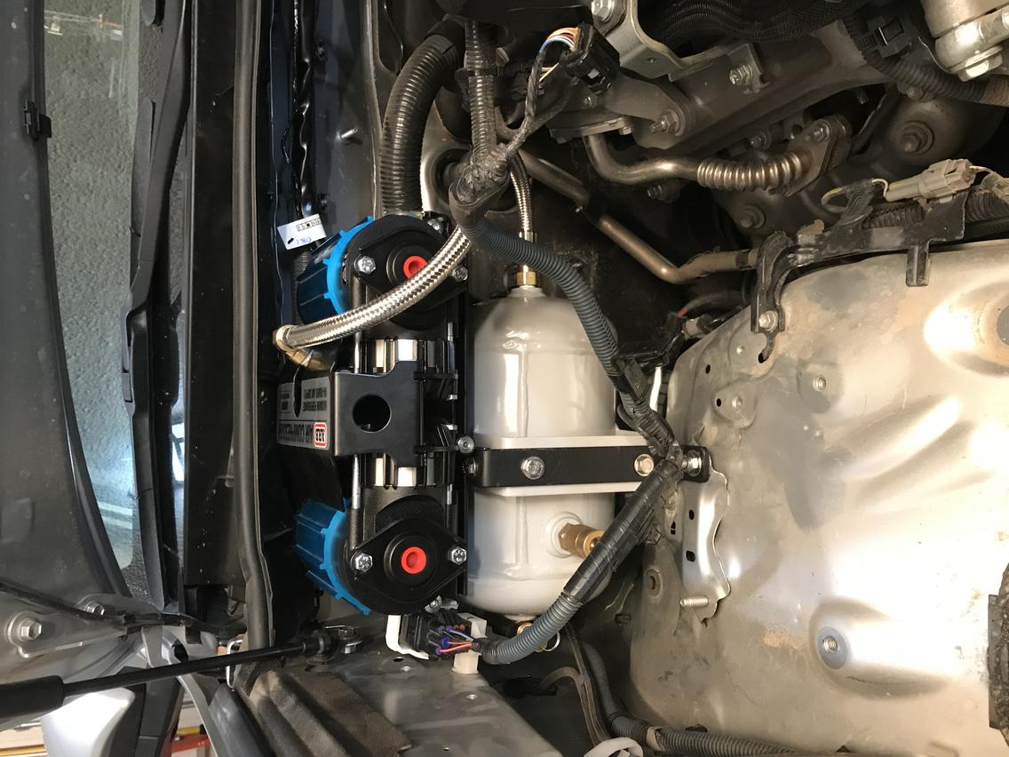

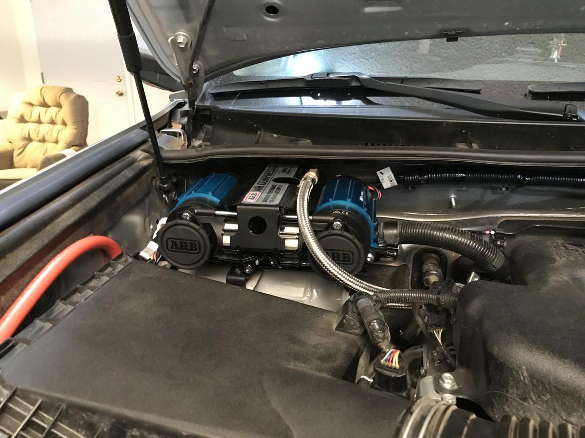

Installed Bandi Mount, ARB Dual, Viair Tank
So this past weekend I installed the ARB Twin and Viair 1 Gallon Tank with a remote quick connect in the front bumper (temporary setup). I assembled everything on the work bench first to make sure everything was going to work together and then tried to install as a package. This does not work! So after disassembly, I installed just the mount then the compressor went on. Once everything was tightened up, I installed the tank. In all I assembled/disassembled everything 4 times to finally get it all in and the configuration the way I wanted it. The I proceeded with wiring everything up. Took me about 10 hrs. of total work time and 3 trips to auto parts/hardware store to get the ancillary parts. A lot of the time working on this was my OCD trying to get everything perfect. Thank you to Leroy for making such a great product. AWESOME!!! (Sorry about the last 2 pics being turned 90)
