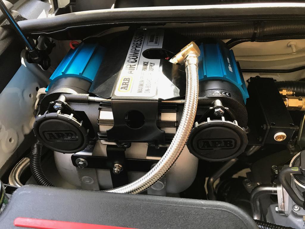

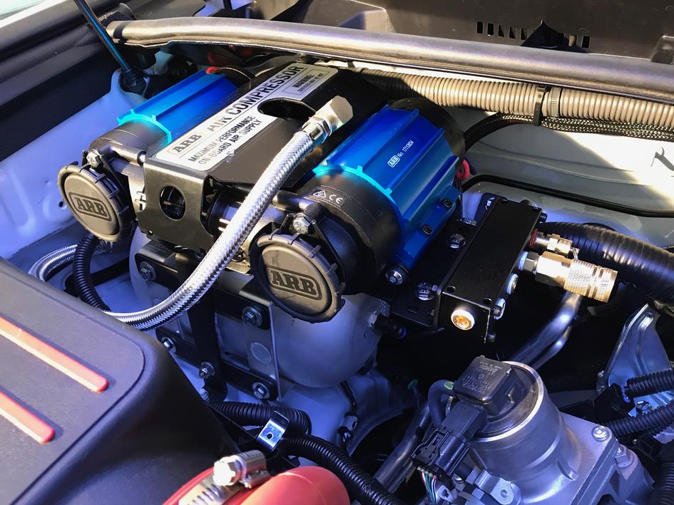

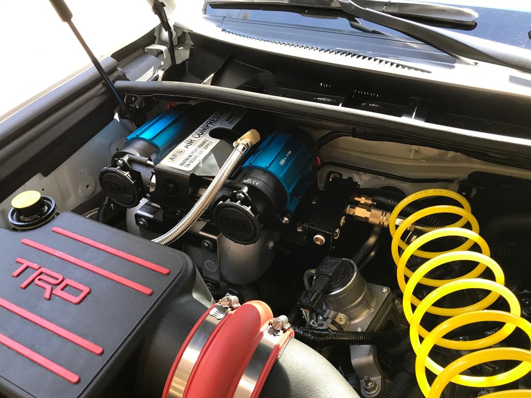

Wanted to post another successful BANDI onboard air install:
My install steps:
  • Install dual AC on BANDI mount
  • Install Viair manifold on BANDI mount
  • Install air lines to AC, manifold, air tank. Pressure test. Disconnect air tank from AC
  • With AC and manifold installed on BANDI mount, install in engine bay. Note air tank is NOT installed yet. I removed engine air filter for easier access.
  • Locate air tank below AC and secure to BANDI mount. Reattach air lines.
  • Pressure test, reinstall engine air filter
I initially tried to put everything together on a bench then install in the engine bay. No can do. There's one bolt that secures the mount to the passenger engine bay wall that is REALLY tough to get to with the air tank in the way. It needs to go in piecemeal (which I think another installer mentioned in this thread, but I was too hardheaded to initially follow that advice).
Leroy (BANDI)'s equipment / material is great. Solid and well painted. He included a really helpful hand drawn sketch of how everything went together. Would buy again!
