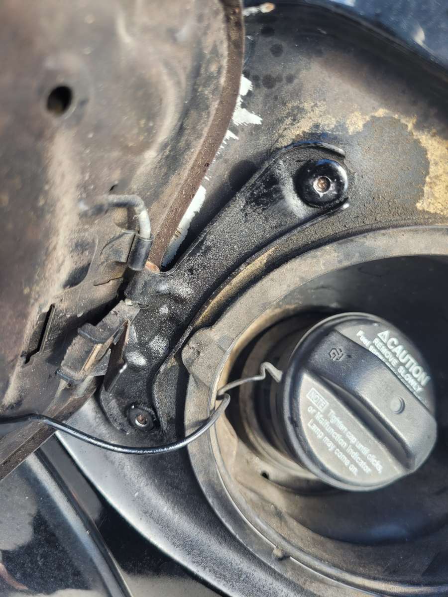

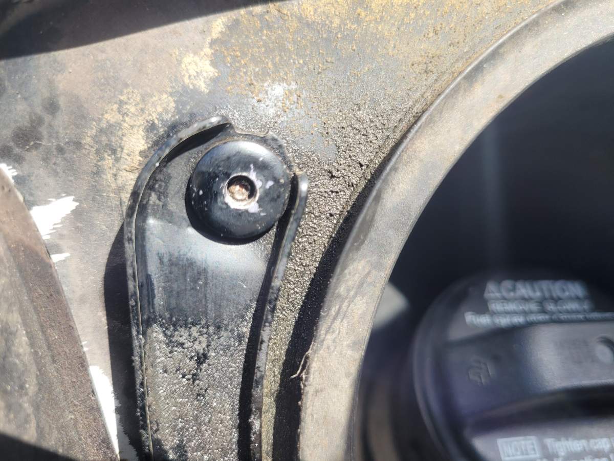

Im trying to replace my current fuel door for my 4runner from 2004, a hinge broke recently and I've been getting P0 error codes, so I thought it was time to replace it.
Issue is, the screws that bolt the fuel door in place look indistinguishable, I can't tell what shape they are and what to use to remove them. Here's the highest quality photos I could take, but it seems the screws are covered in rust. Any advice on what to do to remove them is appreciated.

Toyota doesn't use screws to mount the fuel door and it's hinge.
They're a funky rivet, which is why you can't identify them. We have a customer support program for Siennas where we replace the fuel doors, it's pretty easy to do.
I don't remember if they are a specific diameter rivet or if they are like a standard 1/4" rivet; I will keep my eye out and if I do another Sienna I'll measure them for you.
But you drill them out, pop in two new rivets and you're good to go!

I have a rivet gun and rivets, that's not the issue. The issue is I've been trying to drill them out and no luck. The drill is set to loosen, I've tried 1/16, 1/8, and 7/64 drill bits, and nothing. I've never removed a rivet before, so I could be doing something wrong. What do I have to do?
I sometimes have had issues with the rivets spinning when replacing them on Siennas.
I usually just grab one of my big boy drills (I have a 17/32" drill I use for installing M8 Nutserts) and carefully drill the head off the rivet and then push the rest out with a pocket screw driver if they give me any trouble.
I brute forced it out, using a 1/4 Drill bit, shaving every piece of the rivet off... the ground around me shined silver and I think an gold panner came to shift thru the shavings... I used an hammer and peeled the door off, the teardrops left of the rivets popped off and startled every veteran in a 50 mile radius, and using my Roman Era chisel, the same one Da Vince used to carve the Mona Lisa in Starry Night, I pounded both rivets out with the sheer force of fifty thousand oxs. Now, I'll I'm missing is a 1/4 to plug back in. Hooray...

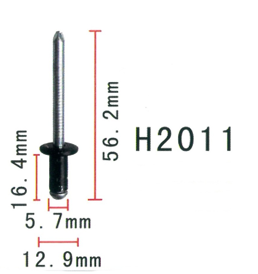

Hey pal, I'm looking for rivets and 3/16 don't fit, so now I'm looking for 1/4 rivets as you suggested but not Lowes or Home Depot carries bigger than 3/16, so I looked on Amazon and I found too many options. I don't want to waste my money, so if you'd be kind enough to recommend what rivet I should get, it'd be appreciated. Thanks bro.
So doing some Googling for Part Number# 90269-06017 (Supposedly what fits 2003~2009 fuel doors for Toyota 4Runner)
I get these dimensions:

I didn't even bother with rivets on mine. Drilled out both rivets, replaced with a nut/bolt and tightened it down. If it happens once, it'll happen again. It's easier to replace the door by unbolting the nut/bolt then drilling and riveting again.
