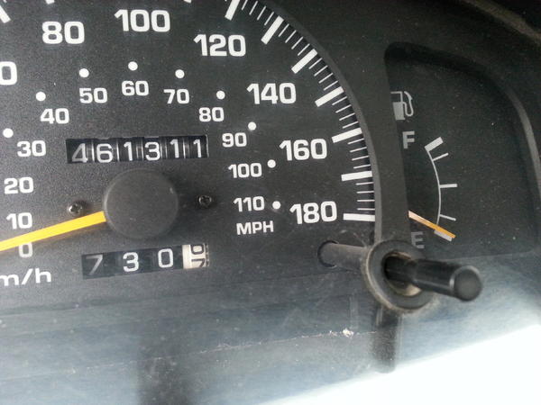

2 months ago this was my best tank as I drove it in town down to the low fuel light after arriving home:
highmiles-albums-1996+4runner-picture41971-low-fuel-light-just-came-one-tank-fuel-trip-through-rocky-mountains.jpg
I have a friend with a 99 SR5, and have been sending him photos like these as his highway travels have been 400 km on 55 litres of the 65ish litre (?) tank.

I'd make sure you're really seeing what you're seeing. Use your phone's GPS to make sure the speedo and odo are accurate.
Double check this too. Never heard of a speedometer or odometer go bad but I guess it could happen.

Even if the odo/speedo were reading wrong, he's basing this off of the trip he usually takes as well. If he has significantly more in the tank or can start the return trip without refueling, that is unrelated to a false readout. Intriguing.

Unless I missed it in a post somewhere, you are basing this off of the fuel gauge and no hand calculations. Even when you say you can make the trip from Calgary to Penticton without filling up, that's still only based on the gauge.
The 3rd gen fuel gauges are notorious for 'failing' and the fuel light showing up at around 5 gallons (18.9 liters) left (so they take about 13 gallons (46 liters) to fill). If you are basing it off of this, then if the gauge 'fixed itself' it looks like you can go an extra 4-5 gallons worth, which makes it seem like you have better mileage.
(question, is it the fuel gauge or fuel pump that causes this 'inaccuracy'? Doesn't really matter with this issue, but still)
The only way to know for sure: Do a hand calculation.
Make sure that your speedo and odo are correct via a phone app and then top your tank off. Set the trip counter to 0. Drive till the gauge reads half empty (or really any amount; half is just an easy number) then fill it back up. Divide the miles driven from the trip counter by the amount of gallons it took to fill.
