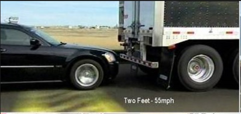

It's very simple how highmiles is doing it... :car:
In all seriousness I've drafted an RV my parents were driving years ago in my 85 ford ranger and it went from 19 to 30+ mpg on that road trip. I stayed on their butt the whole time.
