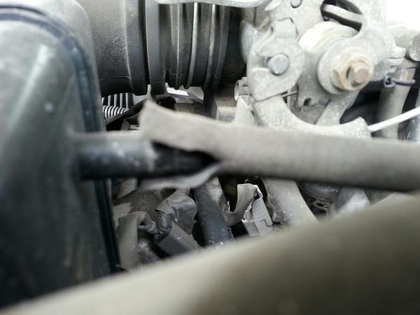

The vacuum leak I had fixed before returned. Originally I had cut the split end off and stuck it back on, but have no idea when it split again.
The hose is from the black plastic box hanging off the intake between the air filter and plenum.
Replaced the vacuum line this time. Head out on my trip tomorrow after work. Will see what happens.

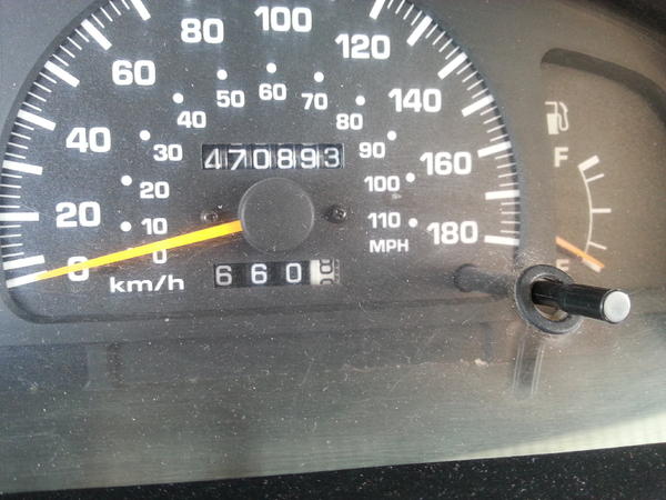

Last trip:
GPS says I am just over 3% slow on my odometer. When I compare the corrected odometer reading, it agrees with Google Maps, within a kilometer and a half.
There were no winds for or against me that were worth noting.
I filled up to spill before I left, did the same upon arrival.

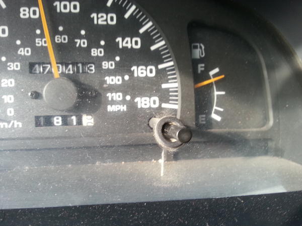

This is an honest reading once out of the mountain pass. I know that it can be easily fudged by slightly letting up on the gas pedal. This is not that.
Arrival:
Fill up:
Math:
661km x 1.03 (correction for tires) = 681 km
Convert to miles: 681km / 1.62km per mile = 420 miles
Litres or fuel to gallons: 65.98 litres / 4.54 liters per gallon = 14.53 imperial gallons
420 miles / 14.53 gallons = 28.9 mpg, or 24 mpg, US gallons.
For me, this is about 150 km more than my old tank of gas while doing this trip over the years. It slowly changed over about 4 months.

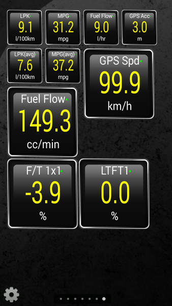

Set the cruise at 100km/h GPS and measure the CC/min of fuel that the engine is using with the torque app. Make sure to measure on a straight and flat road. From my measurements, I think my truck gets 160-190 cc/min. Roughly 13 L/100km

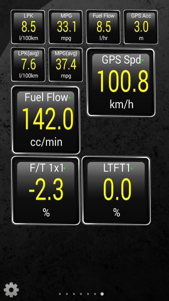

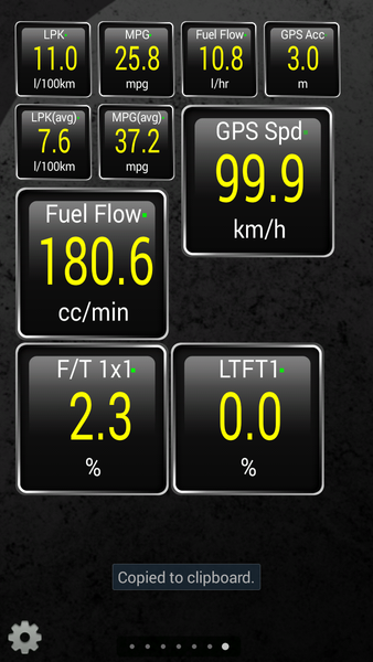

Here are the results:
Even with the cruise control set, there was a bit of variation, the fuel trim would bounce between low positive and low negative numbers.

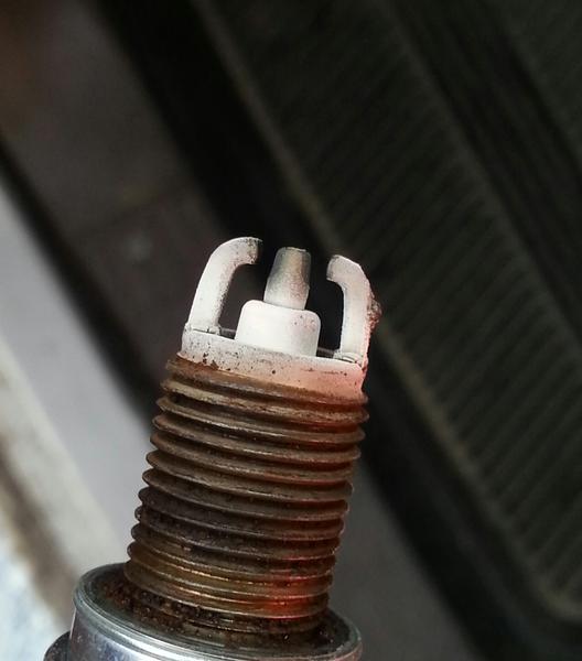

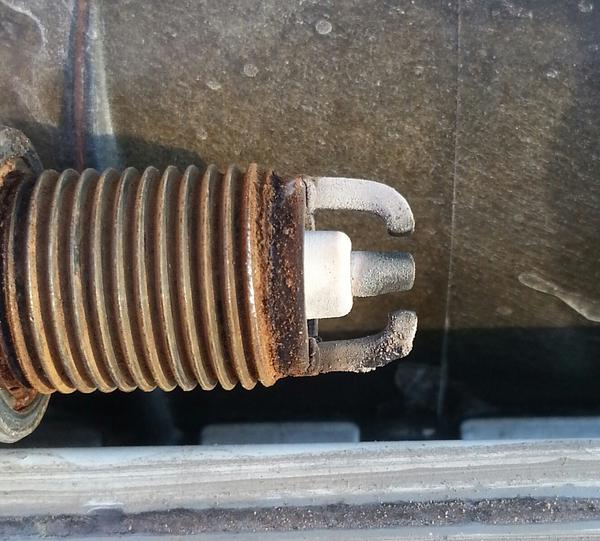

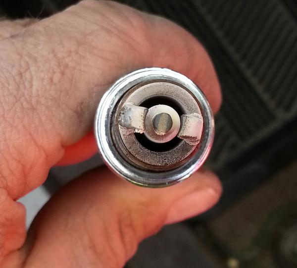

I pulled 2 spark plugs, and the plug wires had deteriorated off in the plastic tube where the metal end that snaps to the spark plug was crimped to the spark plug wire, so I had to replace the wires.
30 years ago, I was taught that the spark plug should be a chocolate brown. Now this was for carbureted engines that were gas pigs.
These were white, which seems to be old school for lean. Is it new school for efficient?
The electrodes look worn, probably should replace them soon, but does anyone know if this colour is ok?
I really appreciate all the help you guys give. :-)
