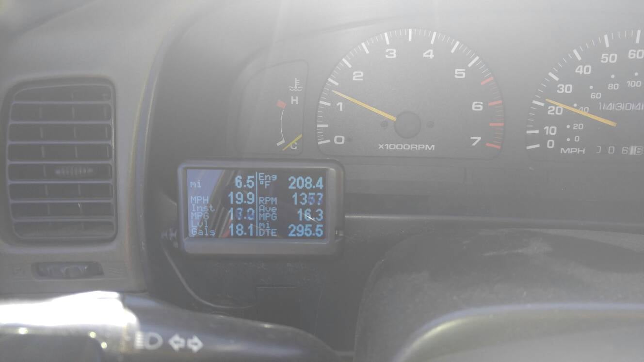

Well, just installed Ultra Gauge an its saying 300+ miles to empty ! LOL my just carry 5gl fuel tank around till it runs out to c how far it will go ! haha Thank for info !!!!

ive never used my fuel gauge, throw that money at an ultragauge and use that. its been extremly accurate to where i can gas up with almost the exact amount. i usually just ask for a dollar more than i need just to be sure. ultragauge is about $80

The prior owner may have pulled the low fuel light bulb. I did it to mine b/c it was so annoying. I solved the problem by using an ultragauge.
The ultraguage gives you a readout on your gas tank levels? So the 18.1 is how many gallons you have in your tank currently and it calculates it as you drive?
correct. and its very accurate. only gauge that is accurate on my dash is the rpm. the temperature gauge is also innacurate. it stays the same from 160 degrees all the way to 225. then it will move lol my speedo is off cause of the 33s so i have that calibrated into the ultragauge. right now it says i have 14.2 gallons, my current gas price is 2.49. so i would need $4.30 to fill it up but i usually round up just in case and its been great. very close.
