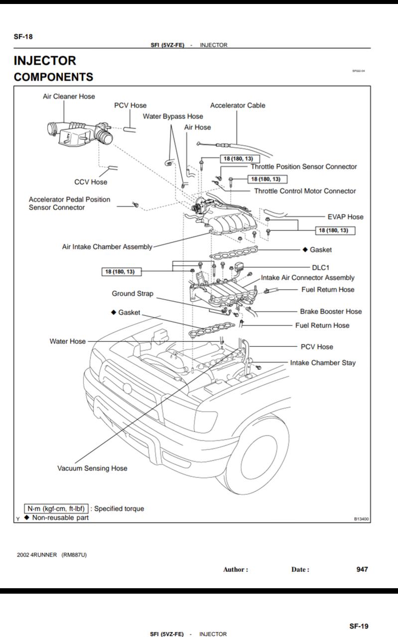

check the fuel return hoses going to the plenum. it could also be leaking from elsewhere and pooling at the lower plenum.
