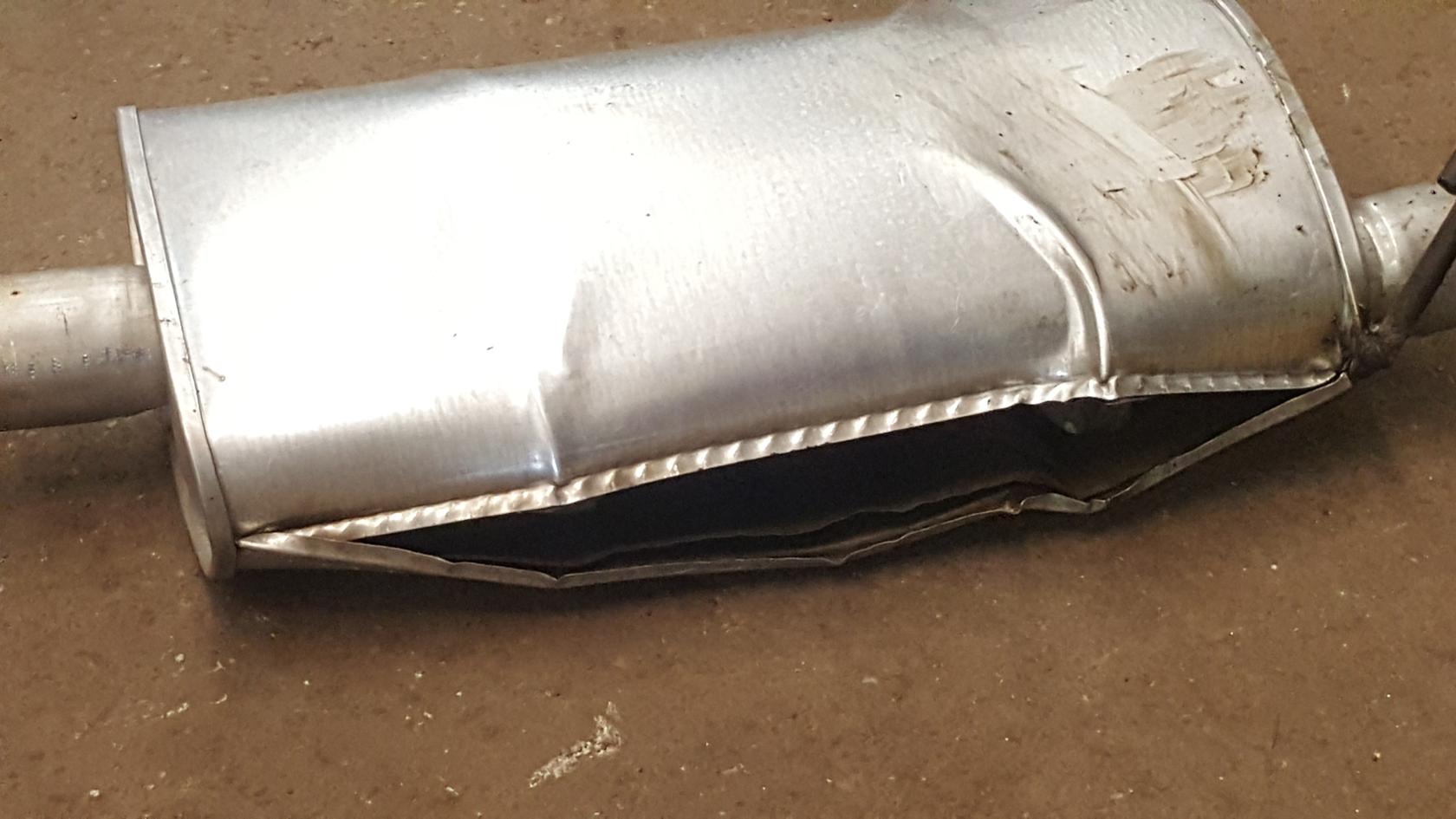

Nissanh, I checked the wire 2 days ago and it was in tack. I will check the wires at the pump tomorrow. But the craziest thing just happened! I left work after posting my last post and on the way home I was driving and the truck was hesitant on the highway about 60mph, so I stepped on it and then heard a loud bang (like a gun shot) the muffler exploded apart!

Muffler blew apart?! Was it made out of card board? I do not care if you just shot NOS down your intake, the muffler should not fall apart.
Yeah it just blew apart. It is so weird.....
My BIL did it once. Couldn't start his beater old C10 Chevy pickup up in the mountains (no cats) and ran the battery down. Decided he could start it coasting down the rocky mountain road. No spark, so he managed to fill that muffler up with gas until something made that sucker explode. Peeled apart like a sardine can. Sounded like a bomb went off.
Only time I've ever seen that. P.S. He was an engineer.

Hey Guys, I replaced the o2 sensor and MAF sensor 5 days ago and the CEL has not come back on. There are no codes and readiness is ok. Replaced all with Denso Parts. So far I haven't had the stalling issue. Thanks for all the help.
Here is a pick of how the exhaust blew up.

Considering the extent of the muffler "blow-out", I'm surprised you couldn't simply tell something was up from the exhaust sounds you were probably getting.
