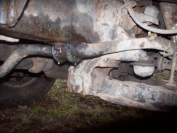

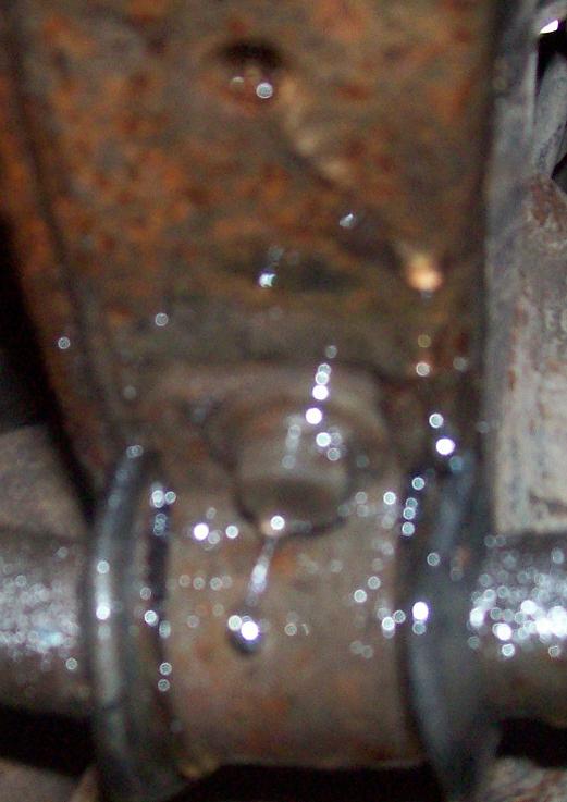

the gas is comming out of the hole on the top and running down in the picture...

I wouldn't worry about anything behind there because there is no way it would leak onto the sway bar bushings unless you back your car in the driveway. Follow that line all the way up to the intake manifold and good luck finding the leak. I don't know how long that gas has been leaking but it can eat up the rubber on your sway bar bushing.
Yes there is a fuel line on the side of the frame but I highly doubt that it would be leaking. Check the fuel filter as well. Your best be would be clean it all off with an air hose. Then have a friend crank the car w/o starting it. That will preasurize the fuel system and create the leak again and hopefully you find it.
