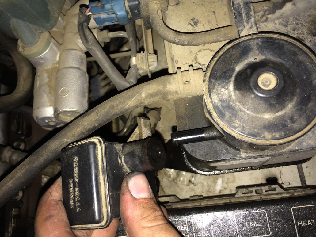

Update
Replaced timing belt and water pump this weekend. Engine seems to run fine for now. So I turn into the driveway and it started acting funny. It's as if the turning of the wheel had caused something. I turn it all the way to the left and it cuts out and dies. Then the fuel started leaking again. It's coming from the evap canister... Where it sucks in air. I'm thinking some vacuum lines may be crossed, or fuel lines may be out of order. Any suggestions? Btw. The tank has been kept at 1/2 full.

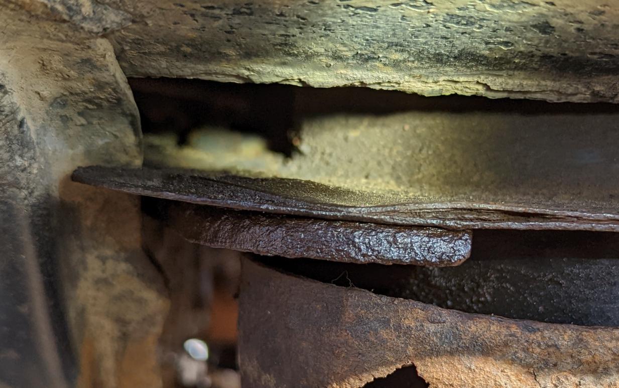

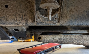

Hey guys, first time poster here but long time 3rd gen owner and poster on other forums.
I've got a small leak on the front drivers side corner on my fuel tank and it's gone unnoticed for a while. The attached pic illustrates the issue with the wet spot smelling like fuel but not dripping or anything. The leak seems to be at the corner or just out of sight behind it at the pinch weld.
I got some JB weld gas tank repair with fiberglass reinforcement linked below but I'm thinking this is a short term fix of maybe a few months to years at best. Amazon.com: J-B Weld 2110 Metal Fuel Tank Repair Kit, Gray : Automotive
Anyone have a bit of advice on if this is something I can drop purge and weld, or is this a situation where I'll need to find a better tank at tank junk yard if the epoxy and fiberglass doesn't work well?

Thanks for the quick reply and info, I really think it's coming out of the side seam still though. Up above the seam it looks dry, like the gas is coming out of the corner where the halves come together which makes sense given the rust pushing the halves apart.

Don't know for sure yet it looks pretty rusty along tank seam. Is that rust on vehicle at bottom of pic?
I'd be tempted to find another junk gem of a tank...
The lower rust with the hole is the skid plate, it is rusty here but still sound enough on the bottom to protect against rocks etc. I'd be tempted to check out a junkyard but the closest one is in Colorado.
One thing that makes me worry a bit is that the front drivers side bolt just spins so hopefully it isn't needed to press the halves together. This bolt mainly just holds the skid plate on there where the notch in the tank that sits up against the cross member. The one I'm talking about is the bolt being torqued in this vid @38:33 https://www.youtube.com/watch?v=GrzX_K-jcuo
well, last i knew Wyoming was not a rust belt state...i could be wrong...hopefully you can get it tight...
I say that tank seam is done. Drill the head off. The front gas tank skid bolts are the one closest to the frame and the furthest up towards the passenger side. The middle bolt holds the tank.
Once the tanks out. You can probably fix that nut. One way or another.
Soak those bolts and nuts with penatrating oil for several days before you start trying to remove them.

3Bears: Wyoming is not a rust belt state, dry/high and no NaCl on the roads.. but I got this in Colorado last winter for a steal and I think it's from the north east. Ohh well, I grew up there and am used to some real rust.
Brillo_76: I may be able to just get a wrench above to the top nut but if not I'll be hacking/drilling it out, but yea I know the PB/Kroil routine for this stuff, soak and heat.
Guess I know my weekend chore for next Saturday. Remove the messed up skid bolt and glue this sucker back together..
You got it. Just be prepared for a mess. As if it was over here. She maybe a little crusty.

Did you ever find out what happened? I am at wits end here thanks for posting that, at least I am not the only one that had this happen.
You my friend are awesome haha thanks!!! I think I may have swapped two of the lines like a dumbass. Will report back into that thread
