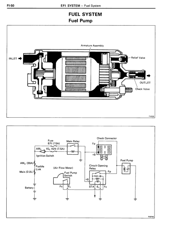

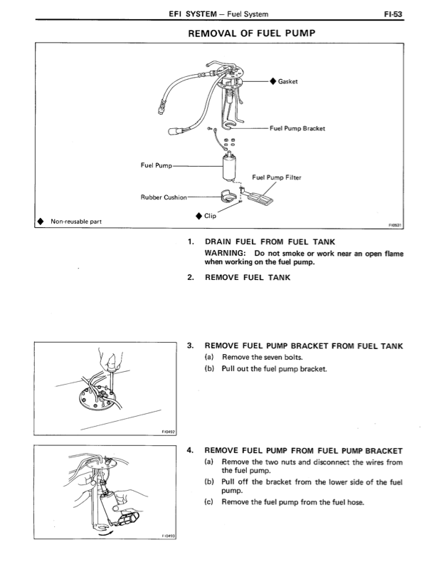

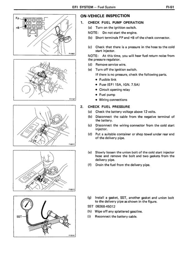

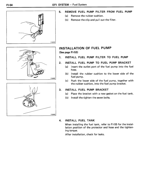

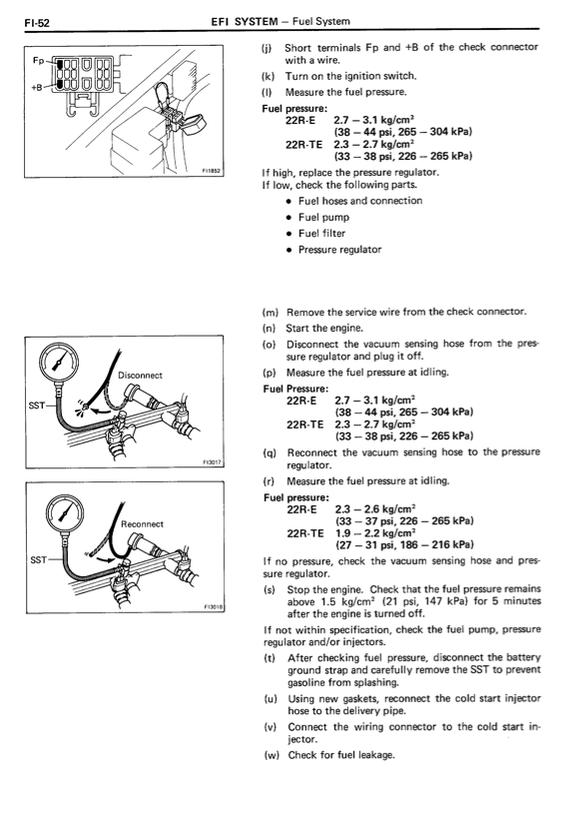

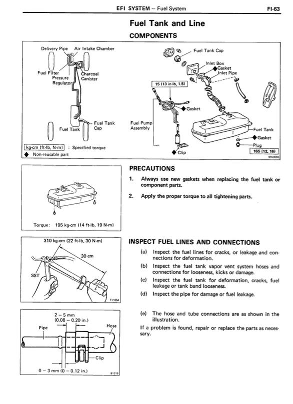

Anyone know of any thread anywhere that shows step by step how to swap out the fuel pump? Pretty sure mine has gone out and its at the hunting club a ways from any mechanic so I am gonna try it myself. I have searched around without much luck finding anything.

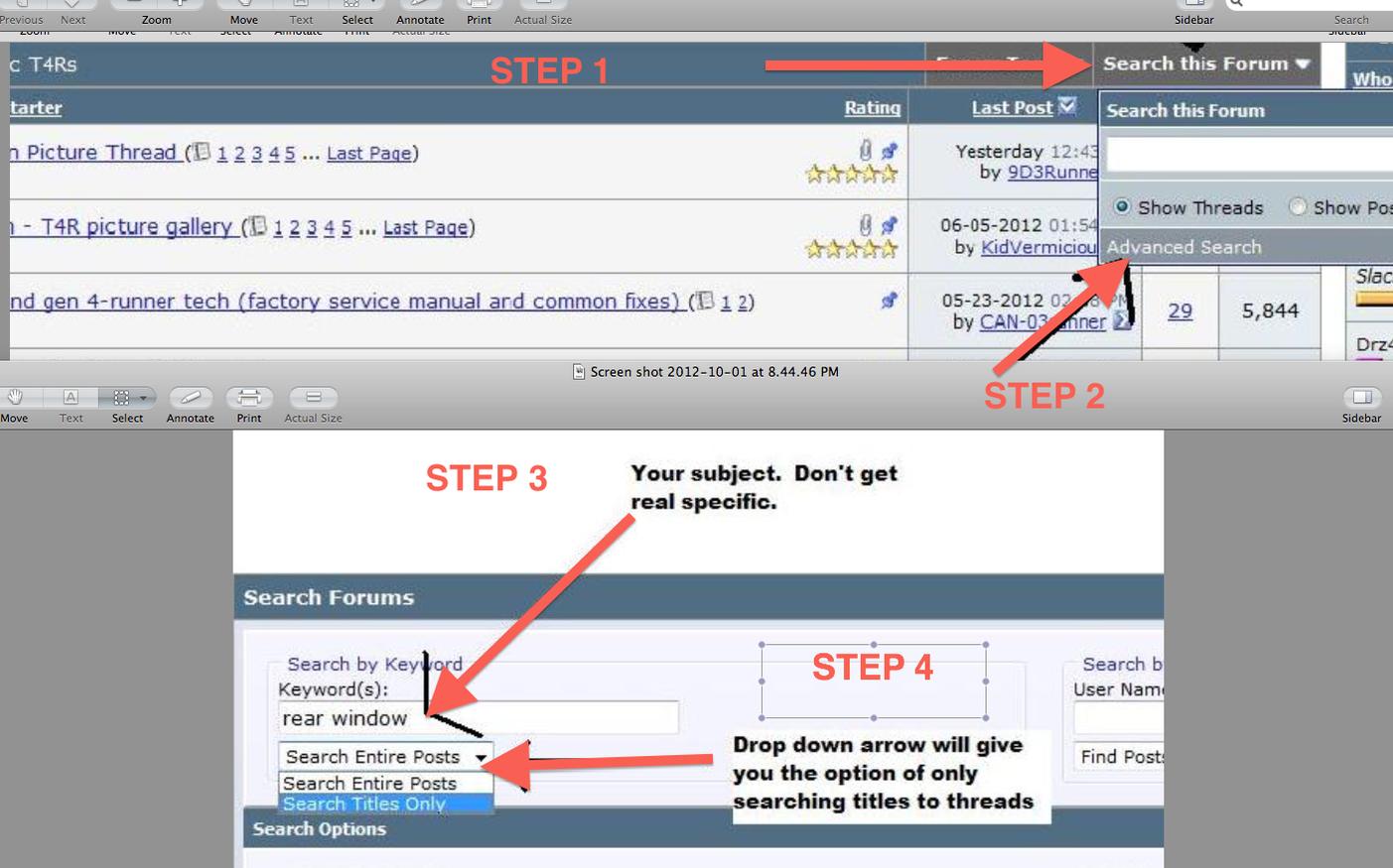

Steps from the FSM. Note, I have never taken one out in the 4Runner so I can't give you any tips. The next to last pic has the torques. The last pic has some steps for searching on this forum. I bet you can find some more info that way as well. Good luck!
