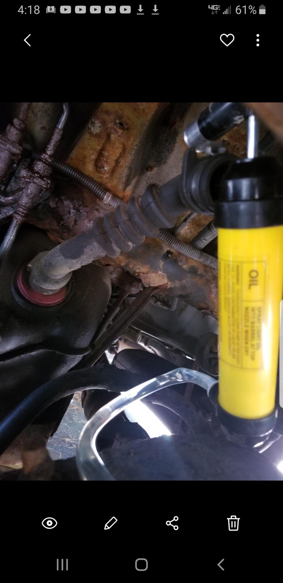

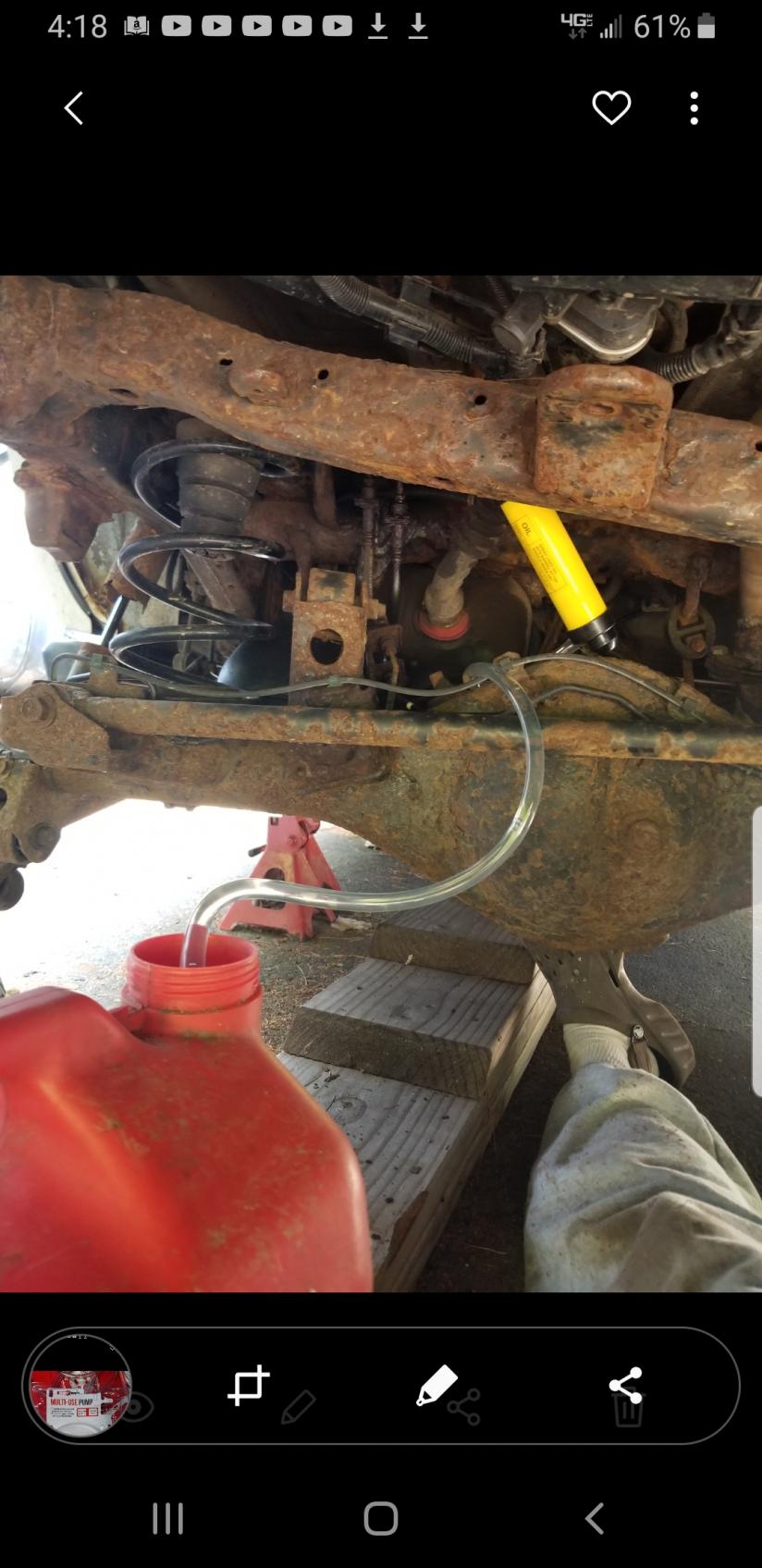

I found a band clamp near the tank where I could disconnect the hose. Am siphoning now. We'll see how close to empty I can get.
Here are some pics.

It was a bit time consuming cause the tank was almost full, but I got most of the fuel out. Luckily I had 3 empty cans and could dump some in another car when I was filling another one. I was also able to thread a nylon strap under the gas tank so I can remove the skid plate.
