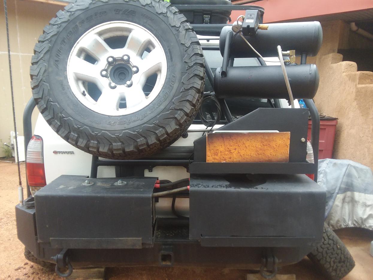

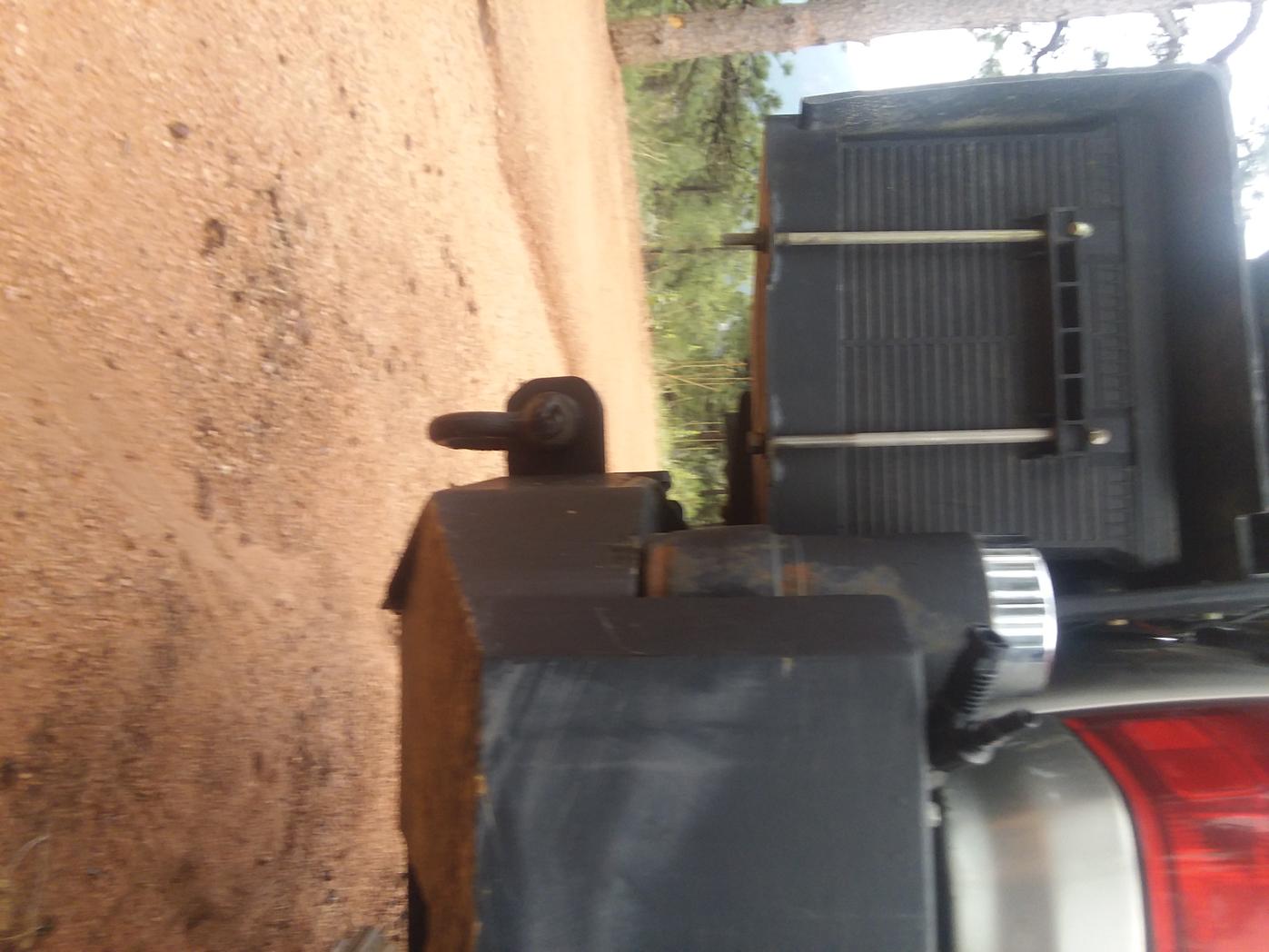

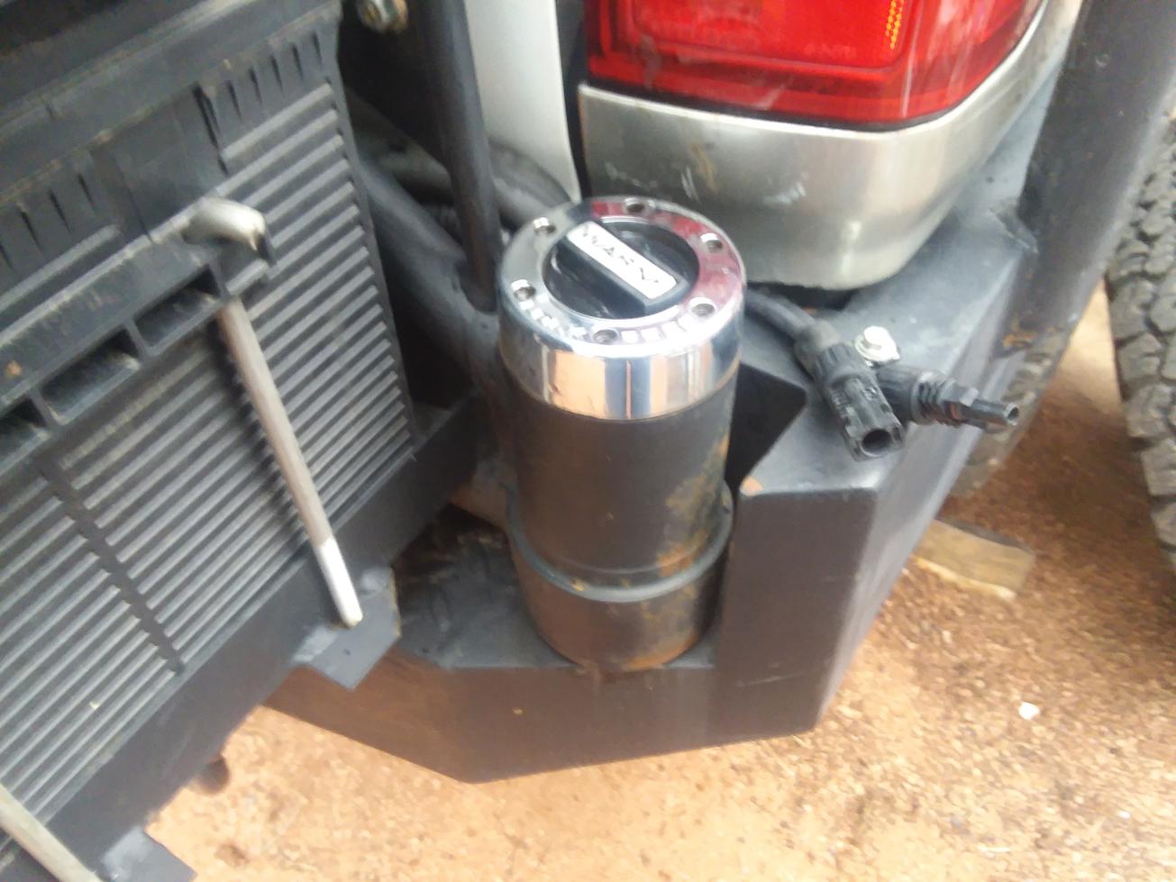

not sure about the sink... yet, but my set up does stick out, but my primary use is as an expo vehicle that i live out of for months at a time and 4x4ing secondary. The ability to lock out the swing has been high useful and adds safety when using on uneven ground. I support a large amount of weight and so far everything is holding up with out issue. If I build another one that's primary use is for off road I was thinking i could weld the hub upside down (weld the housing to the bumper) and use the spindle part as the mount point for the swing out and still have the ability to lock out. Hope this helps with ideas for a better design.
I like the setups that use the hub, but over time I have seen quite a few of these snap since there is not an easy way to make them double shear.
Sense building the swing I am careful to inspect for issues. I bolt the unit into place when its closed to help transfer some of the load while driving. IMO before the unit where to shear the weld at cast hub would the 1st fail point, would have been better to sleeve the hub first.

holy moly you carry a lot of weight on that hub! what's going on with the tubing on the sides of the truck?
It's partial exo because I wanted a full rack and to provide some protection because i tend to go where I shouldn't... As I make my rig more 4x4 capable I can add to it if I want.
I'd like a diagram of what all you got going on in that picture! I see the spare, and the air compressor. I understand your extra fuel tank fill point in your bumper. What are the other things on the bottom? Water tanks or batteries?
Battery bank
