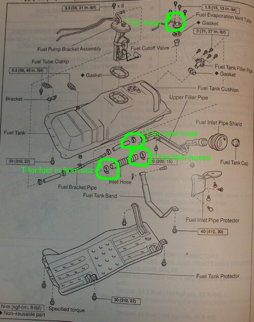

Thinking something like this:

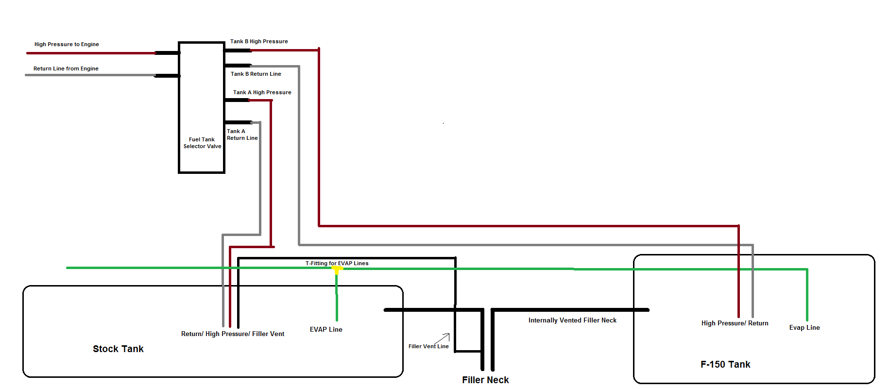

I created a quick little diagram to explain what I think would be the simplest/ best solution.
I think having separate filler necks would make things extremely simple since each tank has a different way of venting, and uses different size filler necks. No valves or weird engineering to design, or worries about proper filling or leaking issues.
EVAP would just be a T-fitting between the two EVAP lines. Just let both tanks breath directly to the EVAP system. I can't see why that would be any sort of issue.

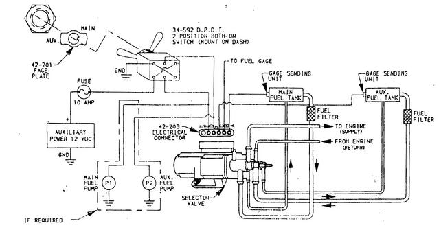

Selector Valve from a Ford or Chevy dual tank setup. Figure out the wiring, which should be super simple.

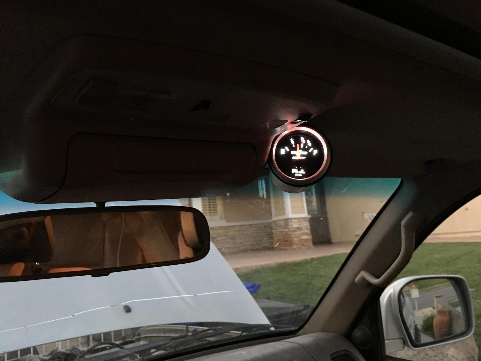

Do a secondary fuel gauge for the Ford tank/sending unit. That way you don't have to deal with accuracy issues or weird wiring setups. Let both tanks have their own gauge. I know my gauge is pretty accurate for the Ford tank. Maybe even wire the gauge with a relay to only be on when the Ford tank is in use? I wouldn't even mess with that myself. Just let them always be on and mount the second gauge out the way somewhere. I mounted next to the map lights/ sunglasses holder. It's never been in my way or a distraction.

Selector valve from a ford or chevy dual tank setup. Figure out the wiring, which should be super simple.

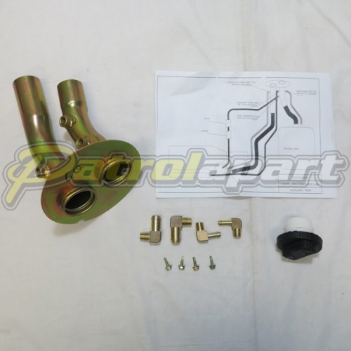

Still left with where to easily mount second filler. I don't want one in my wheel well. Long Range Automotive has some dual fill necks and Patrolapart has one I like better but I think it is too big to fit.
Wow that's pretty expensive! You would have to weld on another bung to the f-150 tank to change the filler vent style from internally vented to externally vented. (More modifications=more issues) And I doubt that would fit in the stock fuel door location either.

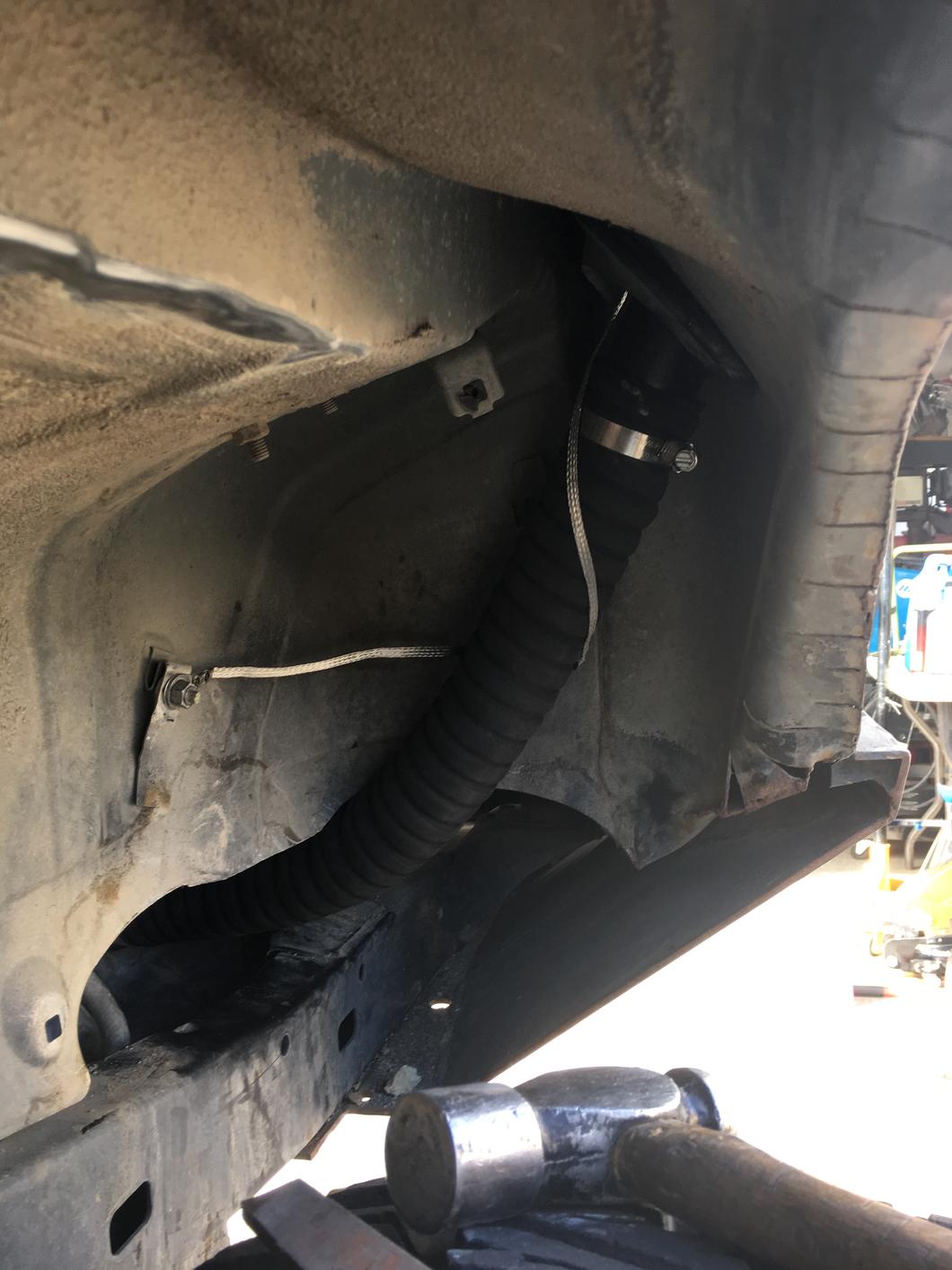

What is your reluctance to just having a 2nd filler neck in the wheel well? Just something simple tucked back just enough to be out of the way, but still accessible enough for a fuel nozzle to get to.
Here is the internally vented filler neck that I use for my f-150 tank.
