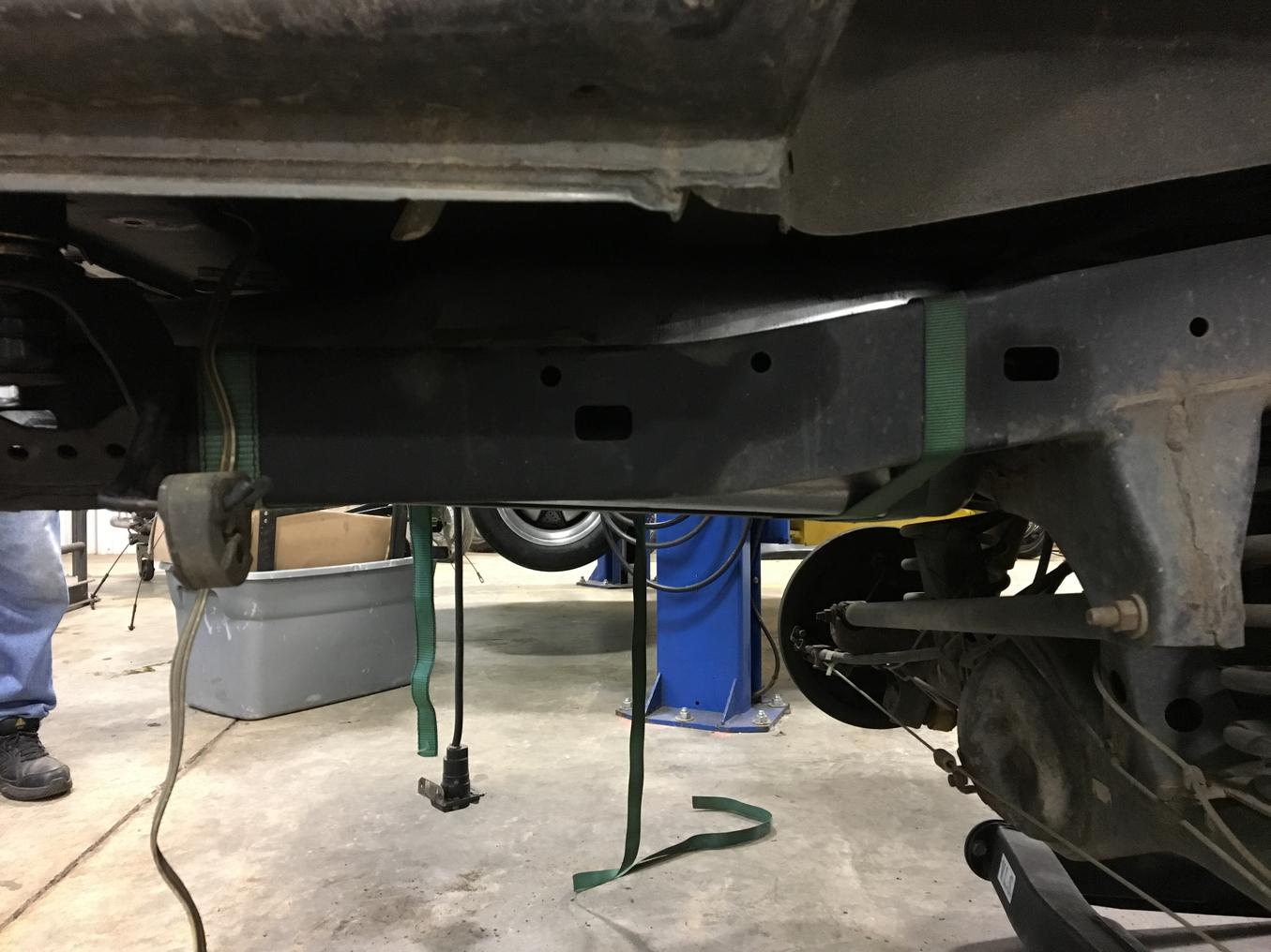

finally got a few minutes to work on the fuel tank relocation; had to cut off the muffler and snapped off a hitch mount bolt in the frame (rusty truck), but I've made a hole for the new tank:

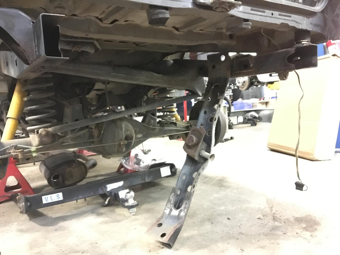

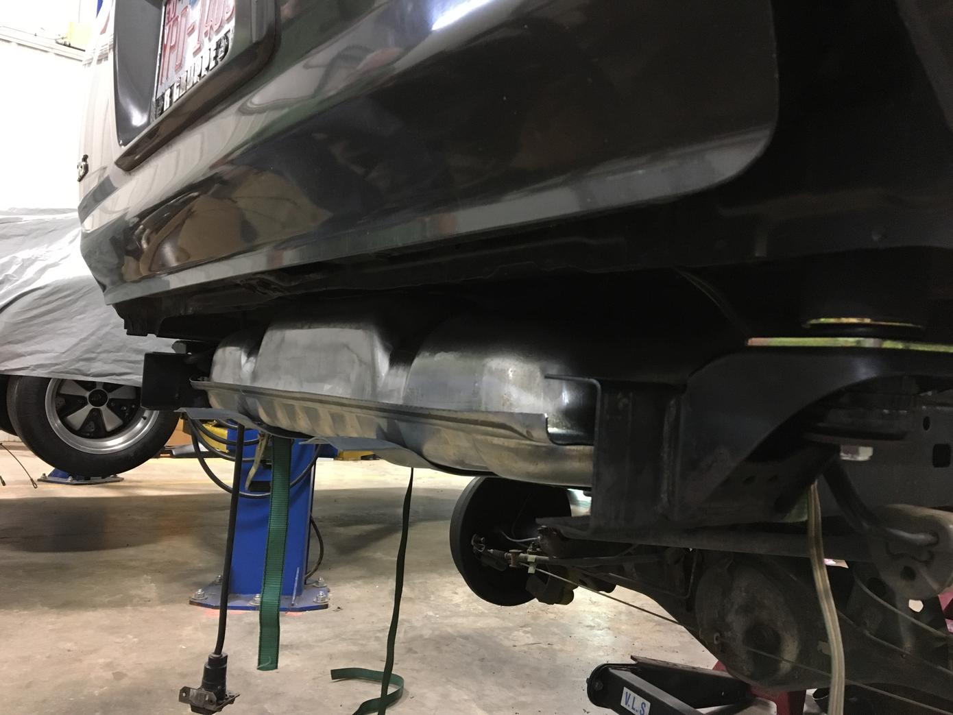

so a 1" BL is the way to go for tucking the tank (I'm working on a bracket design):
That’s looking good with it being tucked up that high. [emoji1303] I’m a little jealous but then again I also don’t have a body lift (frame drop)...
