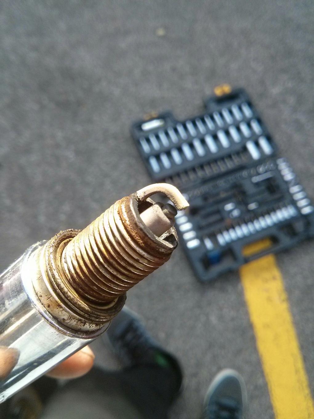

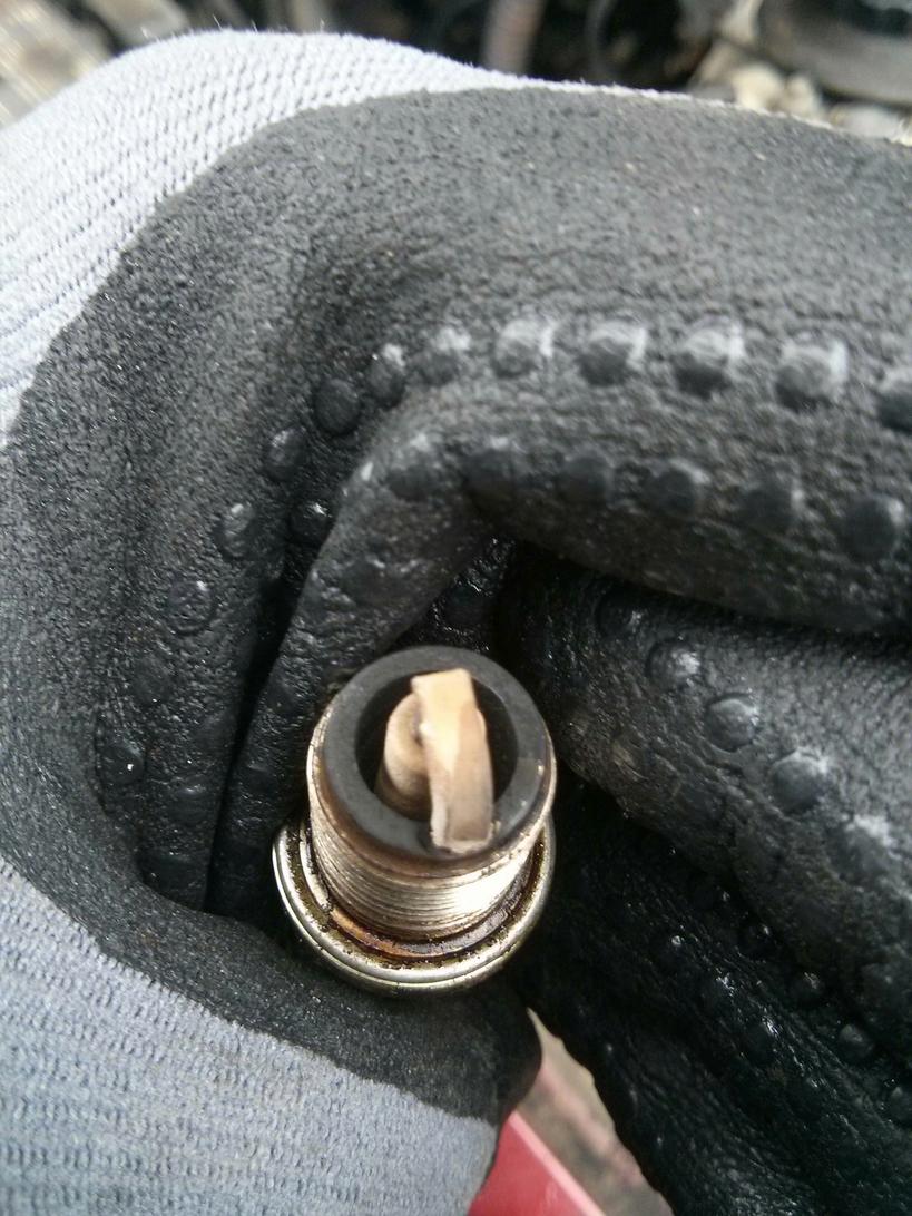

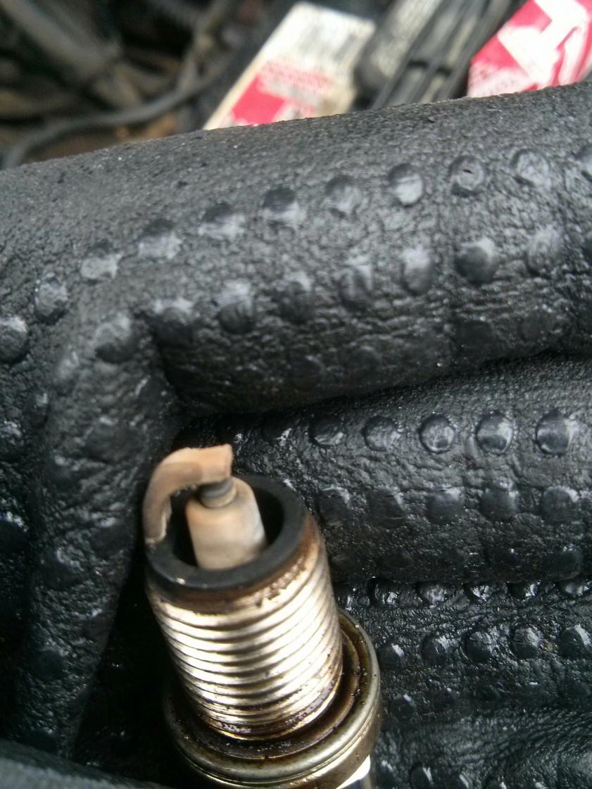

all the plugs look identical. one doesn't look any different from the other. these pictures are diff angles of a few plugs.
Postimage.org / gallery - IMG 20150626 180309, IMG 20150626 180315, IMG 20150626 180323

Ain't nothing rich about that plug! Those plugs look slightly lean, actually! Since they all look similar and nothing out of the ordinary, you could rule out bad plugs and BHG/rings/cylinder issues. And definitely don't lean out the system any more! No changes to anything until the issue is solved, that would be the wisest thing to do at this point.
Now, next thing I'd check would be timing, play around with it to see if you can get it to change the miss. Stock for a 22RE I believe is 5BTDC, but you can run them up to 10-12BTDC for a bit more power, but we're just trying to see if you can get the miss to go away or be reduced here, we're not lookng for extra anything right now! If no changes, put it back to where it was initially and move forward.
You can then start checking the throttle body, might be dirty or a vacuum hose that's cracked or loose or popped off. These items will give you a leaner mixture (more air into the system than its calculated through the MAF). These can also give you a missfire.

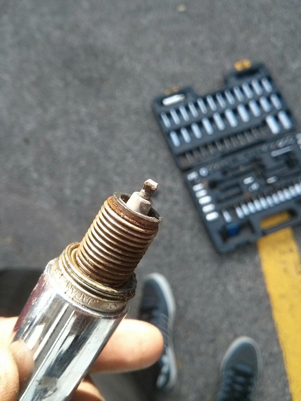

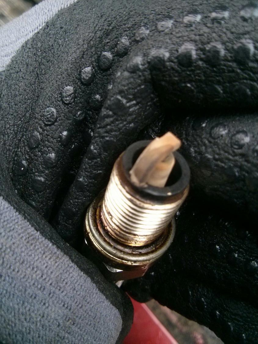

This is probably a better photo of the plug. It has a deep black base and white top. The reason I suspect it running rich is because of the exhaust smell.

Yep, that's a better pic of the plugs. They actually look pretty good, I wouldn't worry much about them being too rich or lean for now.
Go ahead and get those parts installed, then see where it goes from there. As for 16º advance, that's a bit high for the engine, I wouldn't go much over 10º. Getting it to fire that early can screw with your idle and knock sensor, which I believe will pull the timing down when set off, as you're basically igniting your fuel mixture before the optimum spot in that cylinder's revolution of its stroke.
This can also create a rich mixture as you're not burning the fuel in the cylinders at its peak, which would also give you a richer smell at the exhaust tip and will also overheat your cat and deteriorate your o2 sensor.
Now, if you're seeing a missing fire with the timing light, that could be a couple of things here. If it coincides with the sound of a missfire (but not exactly at each revolution but more sporadic), then I'd look at distributor first, see if cap/rotor are good, check wiring to distributor for cracks or bad connection, then move up to the ignitor.
If it does NOT coincide with the missfire, then check your inductor of the timing light to the #1 spark plug wire. They don't always pick up the spark on every revolution. Run the test again after moving the spark plug wires around.
Let's see what happens with the new parts first, and hold off on installing the new o2 sensor just yet. I've had issues with the Denso o2 sensor from RockAuto, have a brand new one sitting here that doesn't read correctly, and I wouldn't want you to have to deal with another anomoly with your issues!
If you have time and wanna do something on the 4 runner, you could always pull the throttle body off, give it a really good cleaning with TB cleaner and a toothbrush, then clamp it down on the workbench and test the TPS!
