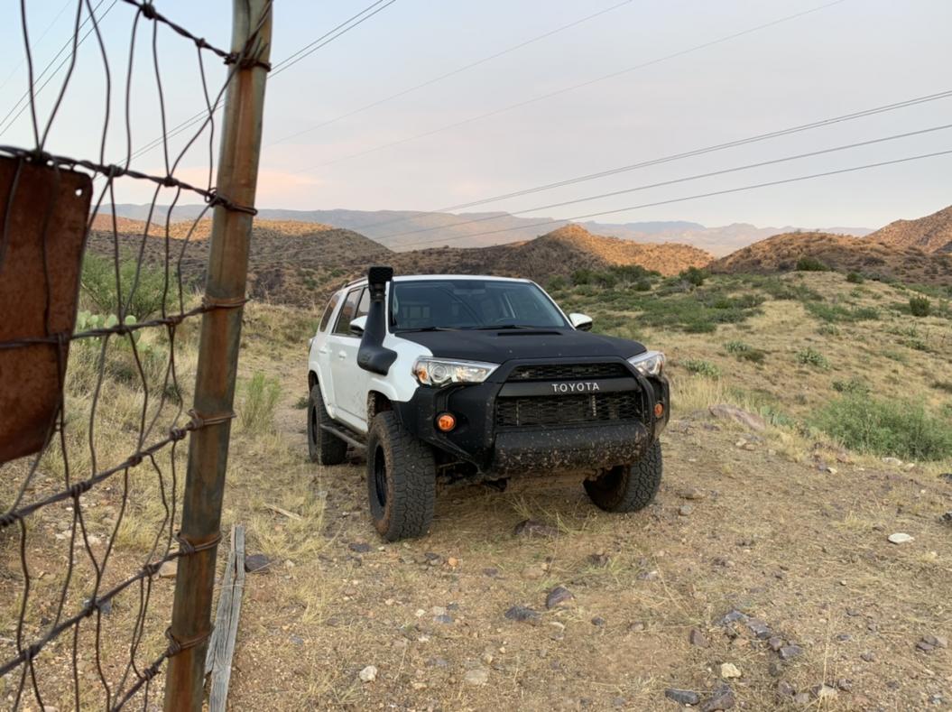

I would say I'm at an em-pass for my build. Truck is water tight, full skids, sliders, 33's/wheels, 2nd row delete platform, and a lift. It's a very pleasant to drive on/off-road desert cruiser that I daily.
The stock plastics have all seen better days and I'm thinking it's time to pony up and go full plastic delete. I'm limited to the kinds of lines I can take with plastics. I've bent a fender (minor) on a steep decline into a bit of a hole. I've bent up the rear passenger cab tub doing the same.
There are only so many options for front and rear bumpers resulting in adding around 200 +/- to both ends of the truck no matter what route you go (to include winch and carrier).
I've attempted to contact shops about making lighter bumpers but nobody seems to want the job.
So my question is for those of you that have the catalog thrown at the truck.
What kinds of average MPGs are you seeing?
Have you seen the trucks capabilities off-road be limited with all the weight?
Is the sacrifice in weight worth the ability to bump and scrape with confidence?
