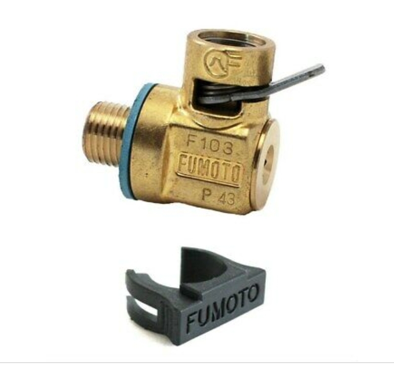

I did my first oil change a couple of days ago and the mess was not pretty. I've used Fumoto drain valves on other vehicles before, but location of oil plug on this T4R is concerning, as it's pointed directly to the ground which provides little protection if an object were to hit that drain valve I'm referring to, which measures 1.25". What I found great about our T4R is the METAL splash shield as all other vehicles I've owned were made of hard plastic. So a metal splash shield is certainly more protective, but what if?
Just curious if someone has used those drain valves and what their take on them. Thx

I've been running the F103-S, which has the short nipple. Easy enough to hook a hose on it but doesn't stick as far down as the regular N.
Just picked up an Oil Udder to avoid the mess of the oil filter as well.
You'll be golden with both of them.
I’ve had one for years with no issues, including off the pavement. See my YT channel link below if you’re interested in where the Fumoto has been. They’re golden.
I installed one of these a few oil changes ago. Great product, great functionality. I would highly recommend one.
No experience with one on a 4runner, but I've run the F103S on our Sienna the last 15000 miles or so. With that and their hose kit, oil changes are almost too clean! I'd have to imagine on a V6 4Runner, a Fumoto + the top mounted filter would make changes stupid easy.

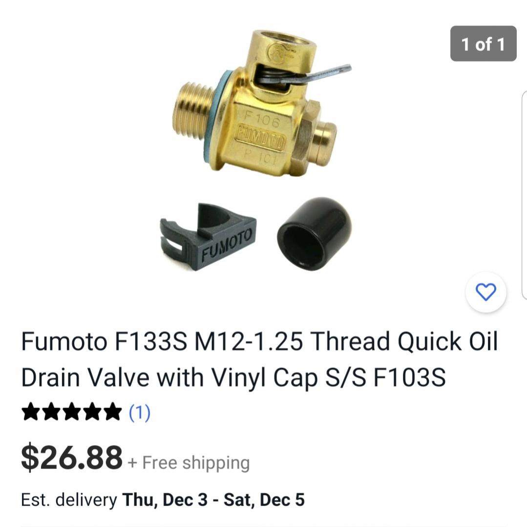

If you end up getting one, order the F133 not the F103. The 103 is the old valve with a smaller outlet. F133 has a larger drain and so it only takes about 4 minutes to drain the oil, vs 15 with the old one.
That's reassuring. I just ordered on Fleabay, and yes F133S is the updated version.
