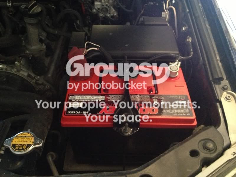

Odyssey 34R-PC1500
Nothing too exciting here, but after hitting 90k miles I decided it was time to proactively part ways with the OEM Panasonic battery. The Panasonic served me well, but there were a few warning signs that it was going south. I wanted to make sure I had a strong, reliable battery going into the winter months last fall so I replaced it.
I was looking at the Diehard Platinum batteries, which are apparently the same exact battery as the Odyssey's, but they don't come in all of the same sizes. I was considering a larger battery that would have required a few, minor modifications. However, I don't run a lot of accessories requiring additional capacity so I opted for a drop-in replacement. Despite the slightly smaller size, the Odyssey has more CCA's than the stock Panasonic. So far, the Odyssey has performed great, even in extremely cold conditions.

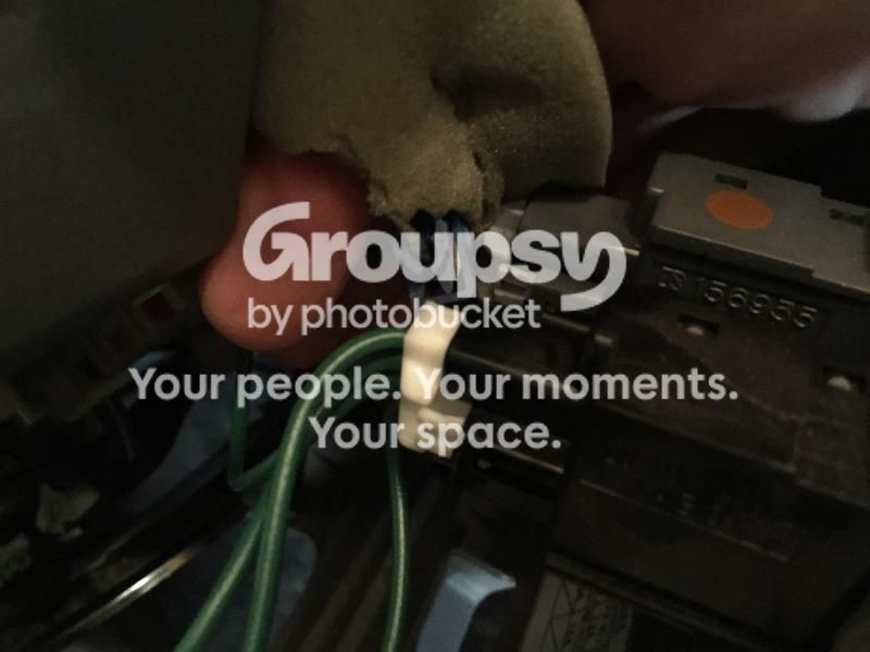

I used an OEM Tacoma fog light switch in one of my blanks next to the center diff lock switch to give it a clean, factory look. I spliced into the center diff lock switch so the Taco switch would illuminate with the rest of the gauges when the parking lights or headlights are turned on.
DSC00396.jpg~original
Can you go into more detail about how you taped into the center diff wires to backlight your aux light switch? My understanding from looking at the FJ forums is that you would use a T-tap on the Green and White/Green wires on the RR Diff Lock switch. However, we don't have a RR Diff Lock switch but we have other switches taht are backlite, such as the DAC, AC 115V, RSCA OFF, Center Diff Lock or traction control (VSC).
Thanks for your input.
Correct. I think any of those switches that are backlit will work. I'll try to snap a pic behind the panel sometime in the next couple of days and post it so you can see what I did. If memory serves, it was a green and white wire, but I will confirm.
Sorry for the delay in getting back to this. I just dropped my bottom dash panel to snap a quick picture. It's not the greatest, but you can see the style of splice I used. It was hard to see the wire I spliced into on the center diff lock button, but I believe you are correct with the green and white one. I spliced it into the third lead down on the Tacoma fog light switch. It worked like a champ. Let me know if you have any other questions.

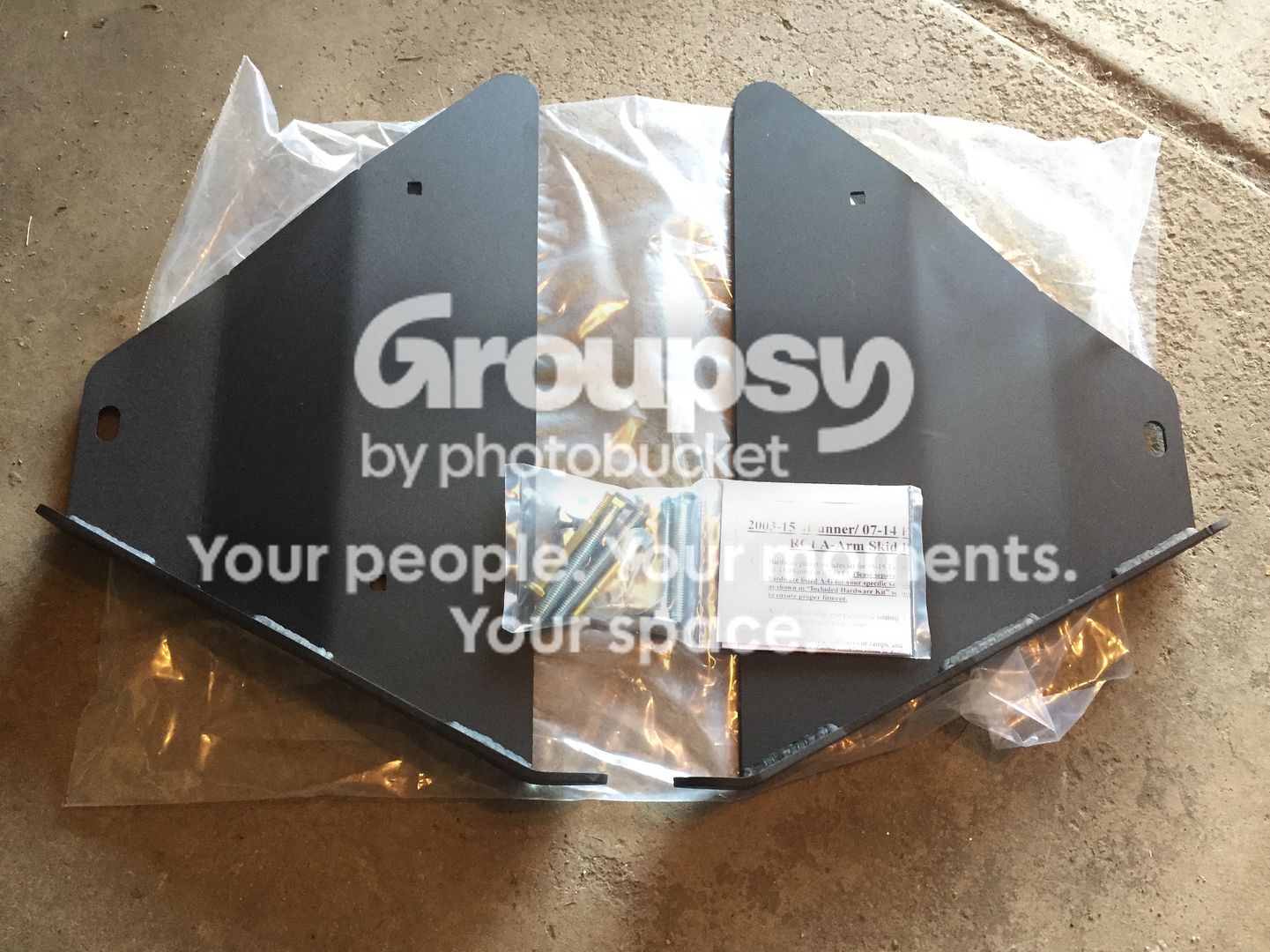

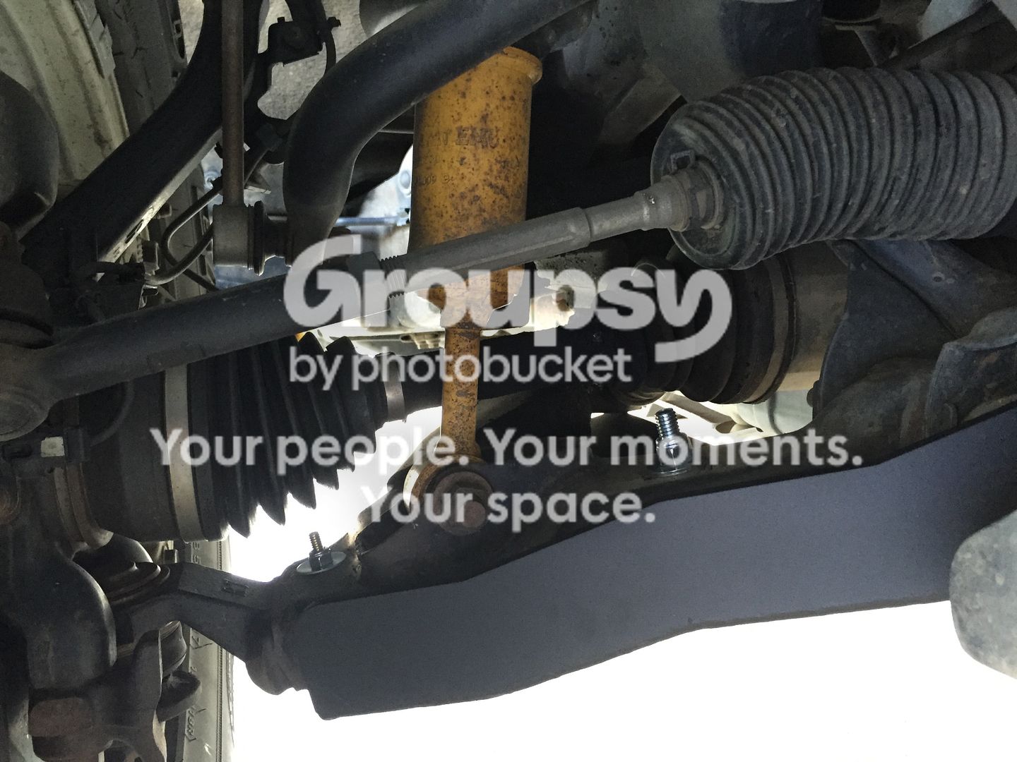

RCI A-arm Skids
It's been a while since I've updated this thread but I've added a few upgrades over the summer....
The first was set of A-arm/lower control arm skids from RCI Metalworks. The fit and finish is great, and it only took about 20 minutes to install them.

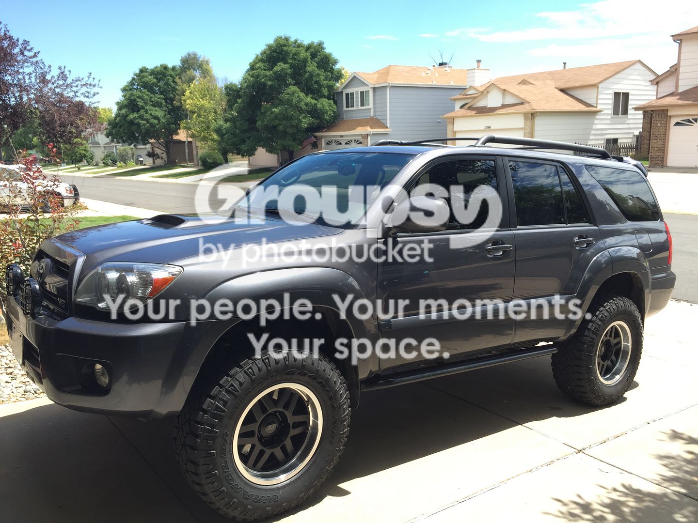

Stealth Customer Series Wheels + Duratrac's
It was coming time to replace my Goodyear Silent Armor's and because Goodyear doesn't make the Silent Armor's anymore, I had to consider other options. The Silent Armor's where the first tire I've ever owned that I would have definitely bought twice. Goodyear replaced the Silent Armor with the Adventures. While they share a lot of the same characteristics, the Adventures just looked too tame for me. They actually look like the old GSA's. I'm sure they are great tires, but I was looking for something more aggressive, so I decided on the Duratrac's.
I had read about Stealth Custom Series wheels here and on other forums, and I really dig the looks of their wheels. As the name implies, "Stealth" Custom Series Wheels are more understated and clean looking than a lot of the aftermarket wheels you find. Plus, they are designed specifically for Toyota trucks. They have a hub-centric design and the perfect offset for our trucks. With the 285/70/R17 Duratrac's and the SCS wheels, they have the perfect stance for me.
I was on the fence between gun metal grey and flat black, but when I saw the limited run of Stealth 6's in flat black with the machined lip, I knew they would look great on my Galactic Grey Mica 4Runner. Vin at SCS is also great to work with. I highly recommend them!
