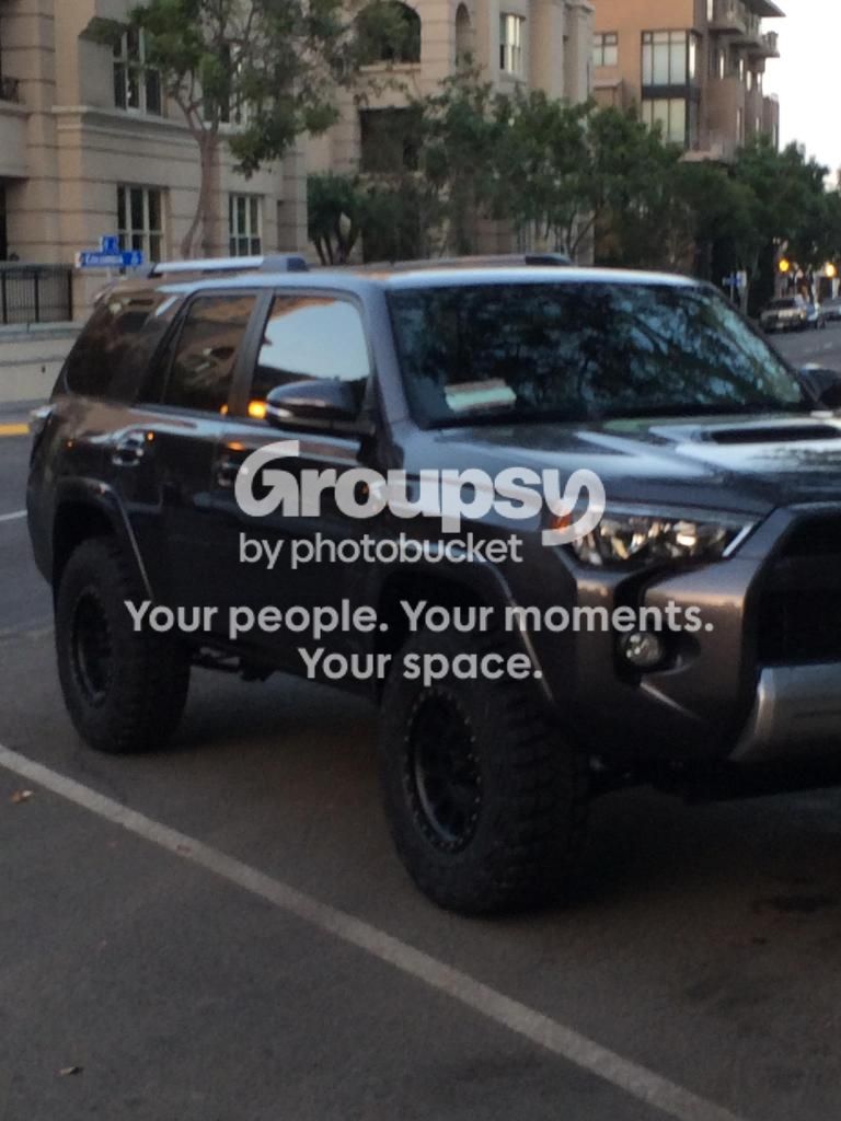

Were you running the spacers in this picture?
I want to say yes but I cant be 100% sure. I cant run my wheels without spacers because of them rubbing on my Coilover reservoir. I installed my coilovers about a week into owning the truck so I cant be sure this photo was taken during the first week.
I don't know if you have a lift but you can pretty surely count on rubbing the front bumper. I don't remember how bad I rubbed body mount.
I currently have a 2.5" Toytec Front Leveling Kit installed.
topteam-albums-2017+sr5+premium+4x4-picture46288-installed-toytec-2-5-front-leveling-spacers-cornfed-1-rear-leveling-spacers.jpg

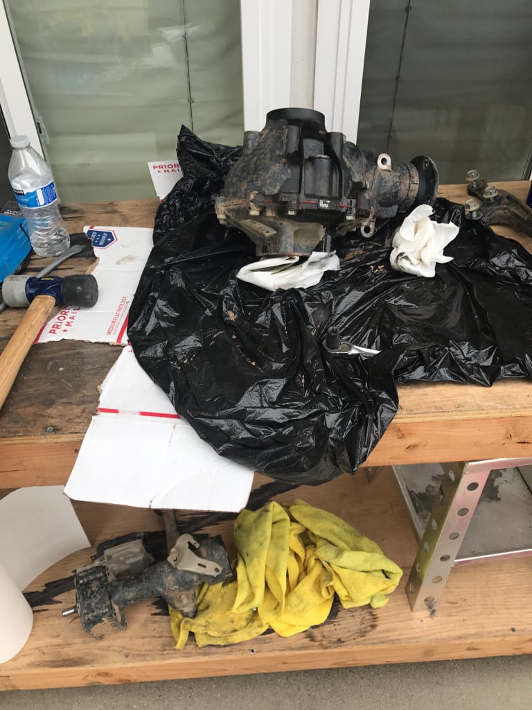

So I finally re-geared to 4.56 over the weekend and man was it a job. I did the whole ECGS route with self install. The truck didn't blow up so I guess I'm going in the right direction. Too early to have any real feedback but this was the last big mod for me. Now it's time to put some miles on her. Pretty pumped.

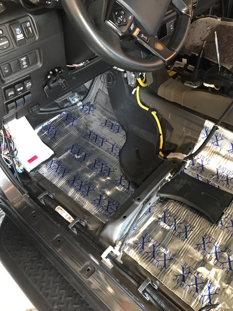

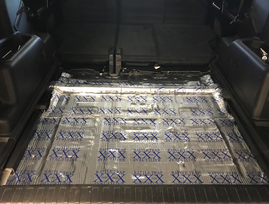

In anticipation for the OEMAudioplus kit I ordered, I started sound deadening my interior. I also removed slide out tray and built my own version of goose gears plate system (all for about $150 including linex).
You're going to be pleased with how this really wakes up the performance, especially around town. You are going to see an increase in highway rpm, but that is not all bad. You'll now be operating in the torque sweet spot and will notice a performance improvement there too. Expect a 1 or 2 mpg hit on the highway, but that will be offset by a 1 mpg improvement around town.
I wish I had done this mod years ago.
That's good to hear. I had PM'd a couple people this morning asking about highway RPM's. I knew it would be revving higher but was a little surprised by the 2300 @65mph. all in all, it was what the truck needed with the weight it sees and new towing.
It's not horrible, especially if you are not trying to drive a constant 80 MPH. I usually cruise between 70 - 75 on the highway and as fully loaded and un-aerodynamic as it is, average about 15 MPG. Way less hunting for the right gear while pulling inclines.
