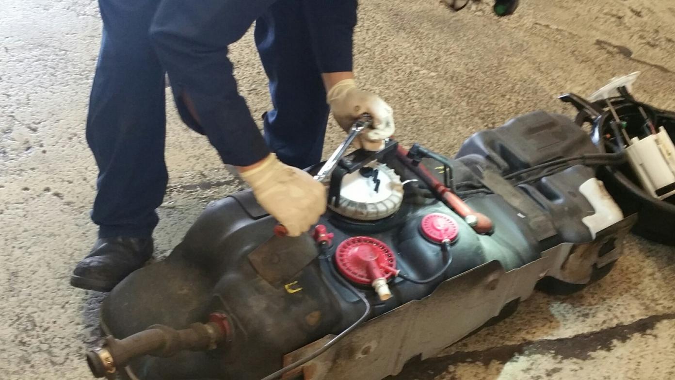

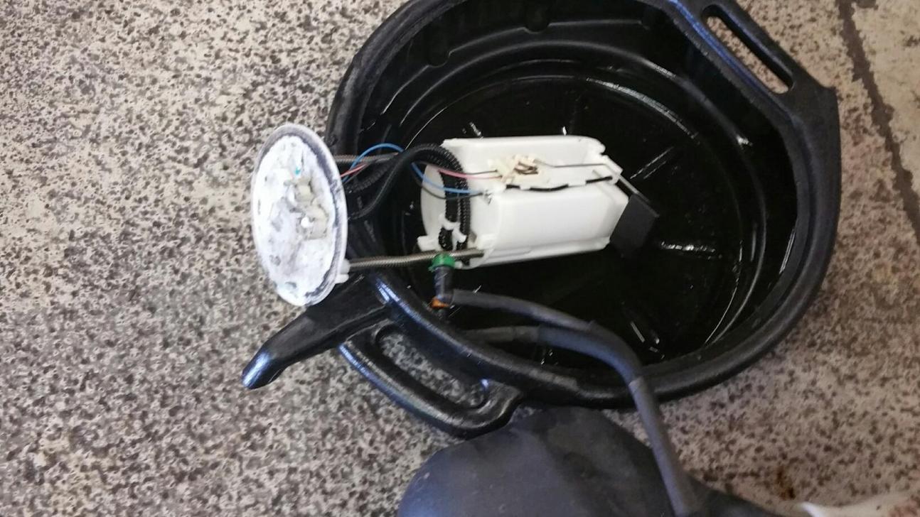

If you wonder what this entails...
I chose to replace the entire cartridge with pump and fuel level sender.
Having a consistent commute is fine with a busted gauge, but add wheeling trips with seldom fuel stops, and it gets sketchy.... :sick:
Yep! You could also, you're feeling sporting, pull out the driver rear seat and roll the carpet back towards the cargo Bay. You'll find an access port for wiring, though it's too small to get the pump out without cutting. Took me about 30 minutes to get it where I could access it without dropping the tank
