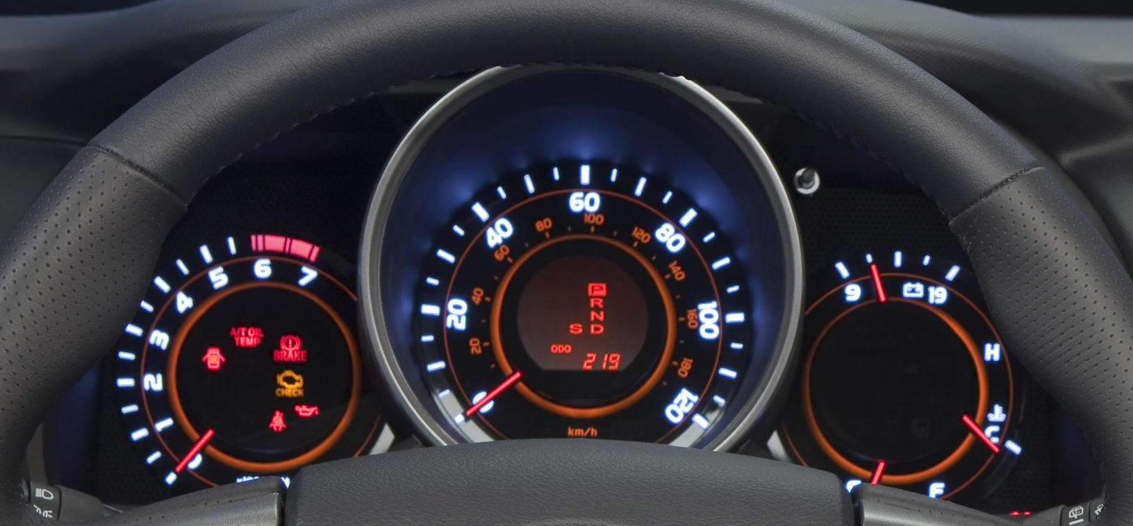

I also wondered this... Asked a while ago with little response. I did do a search for one off a wrecked TE or LE with no luck. If I could get one under 500$, I'd like to give it a shot
The difference is SR5 doesn't have Optitron, which is sweet
what's the diff between them?

Pretty sure it was asked before and Harper or someone mentioned the wiring harnesses between the clusters are different. Could be mistaken, but that's what I recall.
I hate to say it but we do needs more wrecked 5th Gens for parts. I know I know - a horrible thing to say.
As for the cluster I just saw pics of the difference and now understand the desire to change.
I dont think the wiring harness is any different, from the initial research that I did. I tried to order one from Toyota and they wont do it because they need a VIN # to order the part and since I have a SR5 it only allows them to order the gauge cluster for the SR5 not the Optitron that is in the Trail and LTD. Since the gauge cluster also has the odometer in it, Toyota has to send out the new cluster with the correct mileage. So service has to pull the original gauge cluster and tell Toyota how many miles are on the car. Then the car has to sit, cannot be driven, until the new gauge cluster is put in so the mileage is the same and not altered.
If I could get them to order it, then there is no way I could return it if it did not work since it would then have my mileage already programed in it.
I am trying to find one from a junk yard, and try to just plug it in and make sure that it works. If it does, then that cluster can be sent out to someone to program the correct mileage before I permanently installed in my truck.
If any of you guys have a friend with Optitron try to plug it into your SR5 and see if it works. It will either fire right up and be fine, or it wont work at all. The gauge cluster is super easy to take out and swap for a couple minutes to test it out. You just have to pull the black trim bezel around the gauges and then remove it with 4 screws
exactly this.
harnesses looked the same when I looked at them.
The harness is the same for all 3 models (look at the EWD). The difference is a few wires within the harness. I'd have to spend more time between the EWD and FSM to decipher the wiring more.

Yeah, like mentioned above I just wanted a locker and optitron. ARB takes care of the locker problem and a gauge swap will take care of optitron. I will figure it out eventually, just has not been the highest on my list of things to accomplish until now.
I would love to know what you come up with. Its so nice having a wiring genius on the forum :)
Kudos, you have helped people out on this forum so much already with the all the ESM work you did. Much appreciated!
The real question would be, "should I (you) spend $700 to swap out a gauge cluster?" Good luck finding a junkyard TE or LTD.
