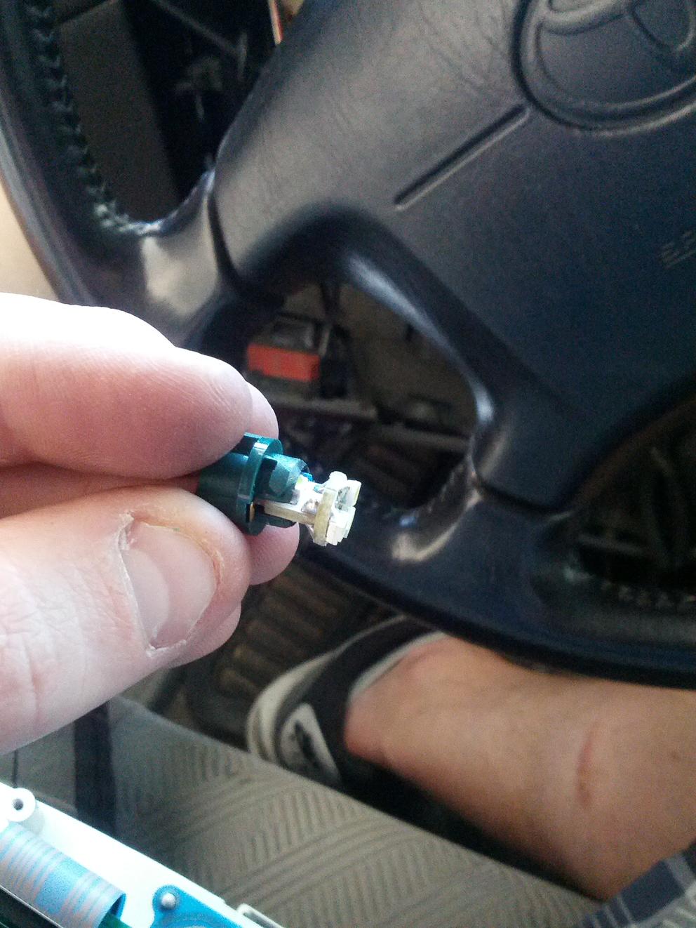

So I pulled my gauge cluster out and replaced the 3 green condom'd bulbs with the 3 #24s from above. First, they were loose. WTF? Every forum I read for 2001-2002 the gauges have #24! So I put a tiny piece of tape not touching any contacts just keep them in securely. Put gauges back in, and no lights at all. So I pulled them back out, and turned one around, hoping I happened to have them all reversed, no dice, no lighting.
So I took the green condoms off old bulbs and put them back in, all works.
Anyone have any ideas what I'm doing wrong here? Or common problems that happened? Is it a series circuit, so if I have just 1 reversed, the whole gauge cluster doesn't work?

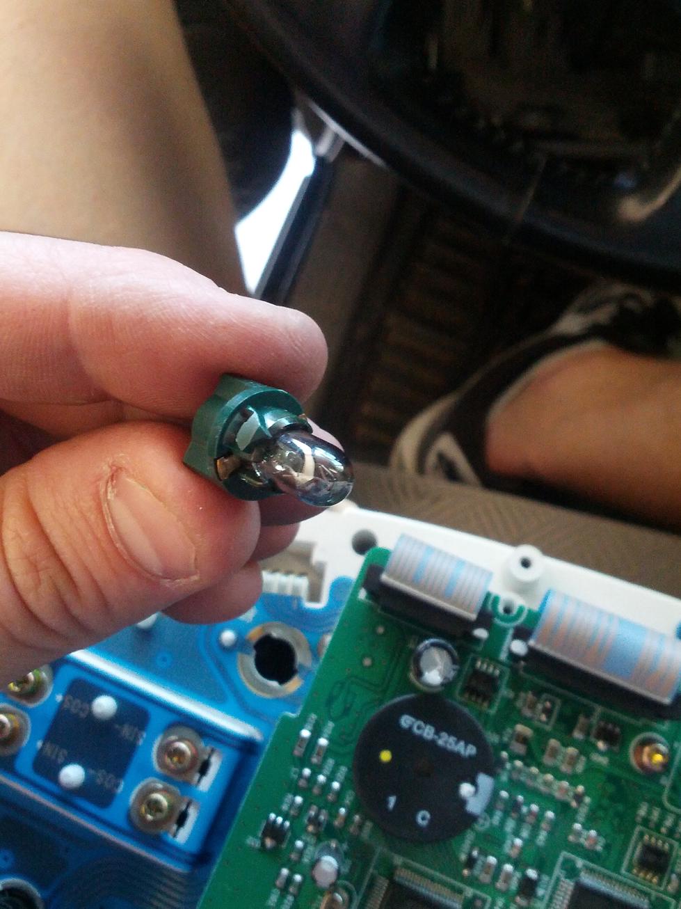

Also the single samsung LED from above I got for the keyring bulb, and ... it's too big. WTF!!!
Heres a pic of stock bulb and the new LED stuffed in:

So I figured it all out. I used a knife to push the contacts in a bit to hold the LED in better, and I also found that the LED + has to be pointing below the 'TOSHIBA' on the other side of the bulb insert. Then the bulb insert has to be inserted such that the TOSHIBA is right side up. Now all of them work.

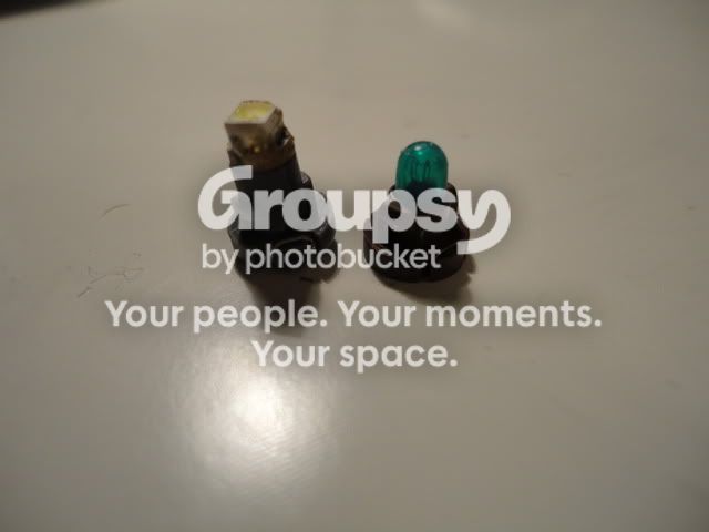

neo 3 is a 3mm bulb that lights up your ect, defrost and rear window button. the neo 4 is a 4mm bulb that covers the 3 knobs in your HVAC. I guess it technically classified as wedge-base bulb which makes no sense because there are no wedges what-so-ever in these particular bulbs. they just twist in.

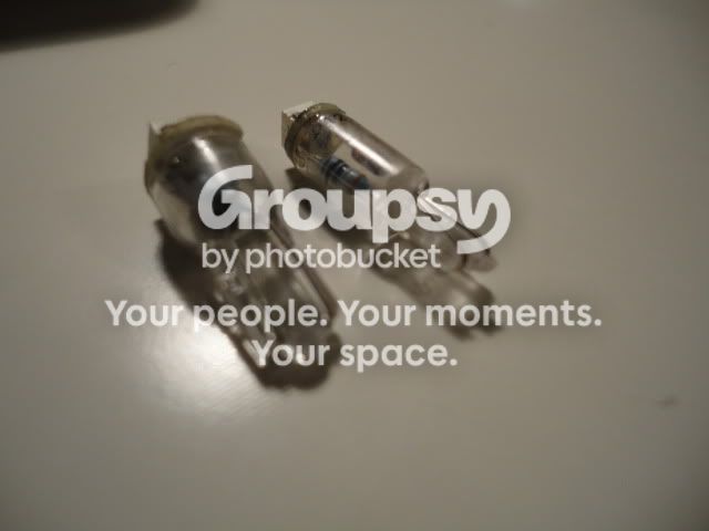

these are #24 and #74 bulbs
these are your neo wedge 3mm bulbs (Stock vs LED)
