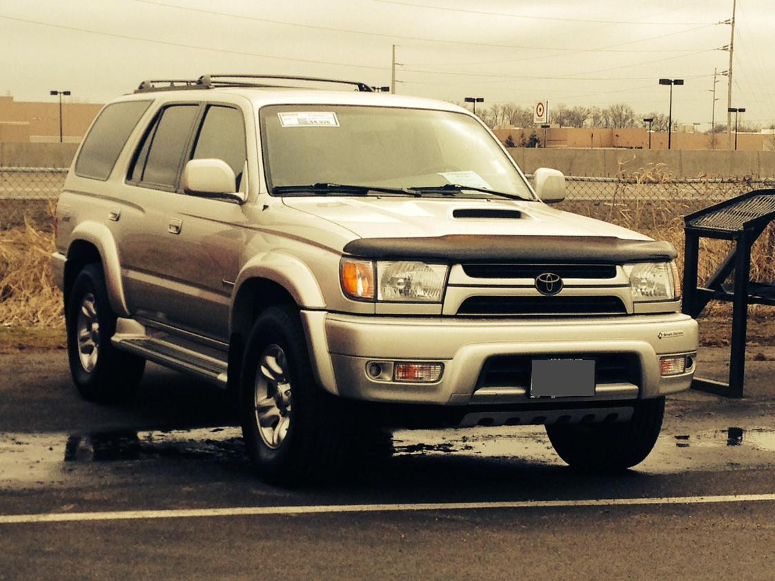

Just got a new (to me) 2001 Toyota 4Runner SR5. I had an identical 2000, but it was totaled last summer. Found another and I have a quick question.
The tachometer gauge overlay was bubbled up when I bought it. I'm guessing a bulb got hot or the sun damaged it? Either way, I'd like to replace it.
My two problems:
I can't find a replacement gauge overlay. All I can find is expensive "white" gauge face overlays. Does anyone know where I can find a black, stock looking replacement?
I'm not sure I'd be up for the challenge of replacing the gauge overlay. Has anyone done this? How hard is it? Do you need special tools?
Thanks in advance for any help you all can offer!

Yes, that's all I need. My tach overlay is bubbled up for some reason. I'll take a look when I get in there. But, it hasn't changed and isn't getting any worse.
Either way, I'm not sure if I need to change the entire tach face or if I can simply find a stock tach overlay and replace that.
Sounds petty, but it bugs me every time I drive it.
