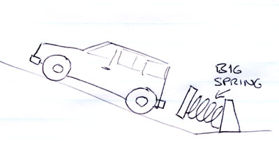

Something like this might help though (& yes I'm kidding)...
HAHA
You guys are helpful.
