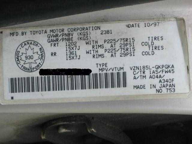

That guy's chart is horrible for runners. He does mention pickups throughout so maybe there is credibility in that aspect. If you have a factory locking rear then you should have 4.30s. This is what I have and your code matches mine exactly. However, if you don't have the locking rear then you should have 4.10s. I have contacted a dealer before regarding the codes and they had no idea.
Yeah, his chart doesn't seem accurate for much of anything after the early-mid 90's anyways.
This link breaks it down pretty good. http://www.top4runners.com/ja/runhist319982.html Basically if you have a V6, auto, and stock 265/70/r16s and no rear locker then you have 4.10s. All that plus the rear locker then you have 4.30s.
Specs for all the models are listed just under the Powertrain heading on the link provided.

No 3rd gen w/ auto tranny ever had 4.56 gears. The lowest gears you could get in an auto were 4.30s and that was ONLY if you have the rear locker. 4.56s were an option ONLY in manuals if the 4Runner had the upgraded tire package (265/70r16.)
You said you have stock gears with "bigger" 31s?? What size tires did your truck come with because it should have been 31's. If your truck is a Limited (mine is also) without the rear locker then you should have 265/70/r16 tires stock, which is a 31" tire and 4.10 gears.
Good info on what gears are needed for what size tire, but check the link I provided in my first post for your accurate gear ratio. It's not 4.56.

I like to know my gear ratio. On this link my gear ratio is (A04A) 4.56.....Gearratiosanddiffs Is this good reference.
That website is very wrong. I checked my 4runner and was bummed to learn I had the 3.15 ratio (doorsill says A05A). But I still have my original window sticker, and I checked and my vehicle has the SV upgrade.
The SV upgrade includes (among other things) 265/70R16 tires and importantly a 4.556 rear diff. The VIN on my car, the window sticker, and the door sill sticker all match. To be fair the doorsill still shows my tire size being the smaller 225 wheel (Toyota lazy), so maybe they didn't change the gear ratio code too.
No matter what, the reference that's linked is sloppy, don't use it. It doesn't list my 4.556 gear ratio, it doesn't show the 4.55 gear ratio that also existed. It also lists a 4.56 gear ratio that doesn't exist afaik, either they rounded up the 4.556 gear ratio to get that number (bad practice considering the precision these ratios have) or the writer had bad information.

For tire size, it's extremely common for the wrong size to be shown on the door sticker.
Explained here, the 225 size was the standard tire size and every base/SR5 model had this tire size on the door sticker. Toyota would put a sticker on for a 225 tire even if the 4runners were optioned with larger tires. Only the limited got the 265 tire size on their door sticker.

Look at the sticker in your driver door jamb. If it says A03A then it's 4.10 gearing. If you need help post a picture of it.
It does indeed say A03A. Earlier in this thread someone posted that the tire size the sticker states may be incorrect so I wasn't sure if the gear info might be as well.
