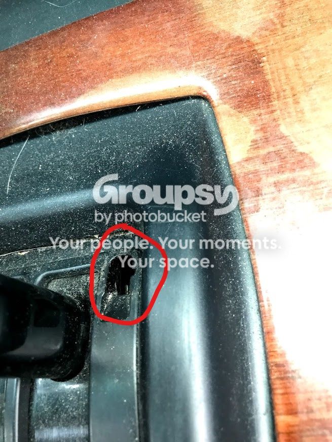

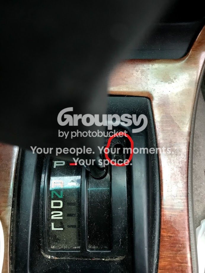

A few months ago, the ignition key cylinder on my 4runner wore out and had to be replaced. At the time, a tow service had to pick the car up because the key would not turn to unlock the steering or get the car out of park. The towing guy punched this hole near my shifter to "unlock" it...
So I had the ignition lock cylinder replaced and all was well afterwards.
Now... months later, suddenly my car will not come out of park without manually taking a small screwdriver and poking it into that hole and pushing down. Only then can I push in the side button on the shifter and take it out of park.
Any ideas what the heck is going on and how I can fix that?

Yes must have power but we can always over ride it with the emergency tow switch located beside the shifter to override that solenoid circuit.
