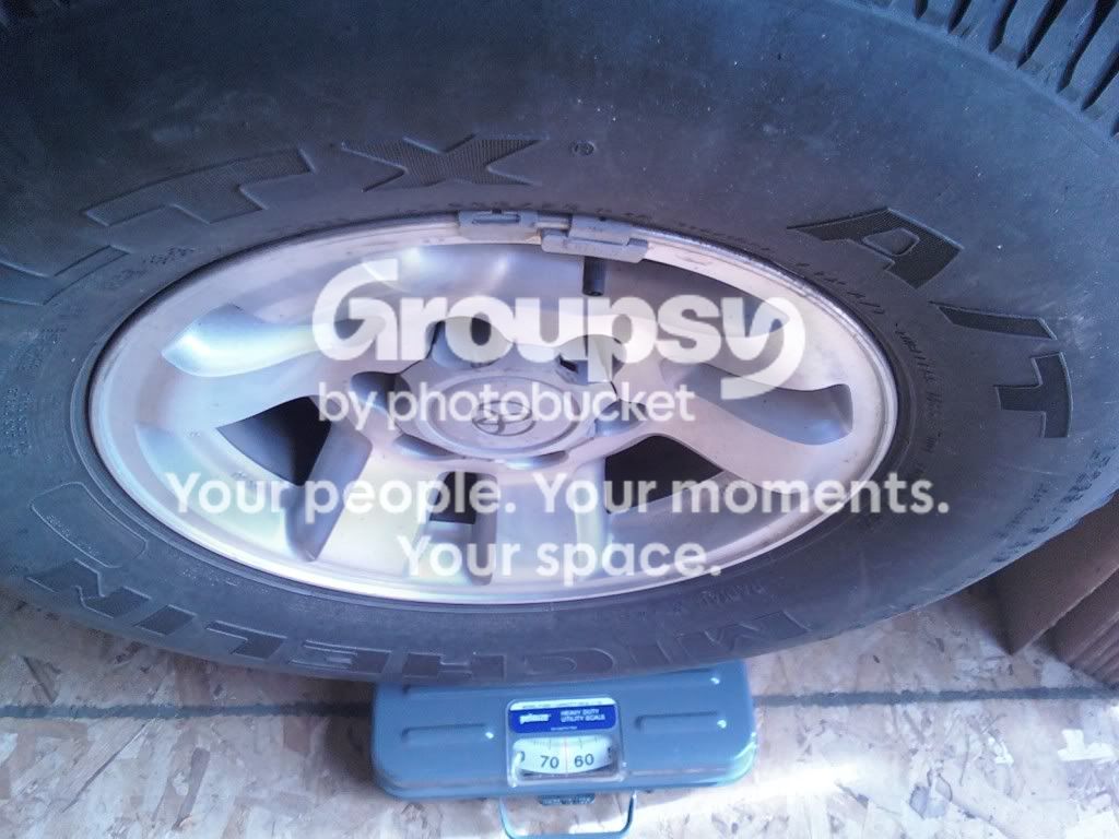

I could throw one of my stock '97 wheels with 75% worn 265/75 mounted on the shipping scale....

I have heard that before, as long as it has 4.10's i should be fine from what i am reading. That'd be great, if you could give me a weight. I just need something to reference.
with a 265/75-16 on stock split spoke wheel = 65lbs on my shipping scale:

Thanks man, So I am looking at a around 24lbs difference per wheel and tire.
Don't forget that you need to factor the weight of the wheel with no tire.
I was just factoring the total weight of the wheels and tires. It is around 89 lbs total and the others are say 66 with all of the tread.
I see now...reading comprehension fail on my end. Those steel wheels are heavy...!
That tire I posted weighs 49# new. I'd guess the aluminum wheel at 18#-ish.
