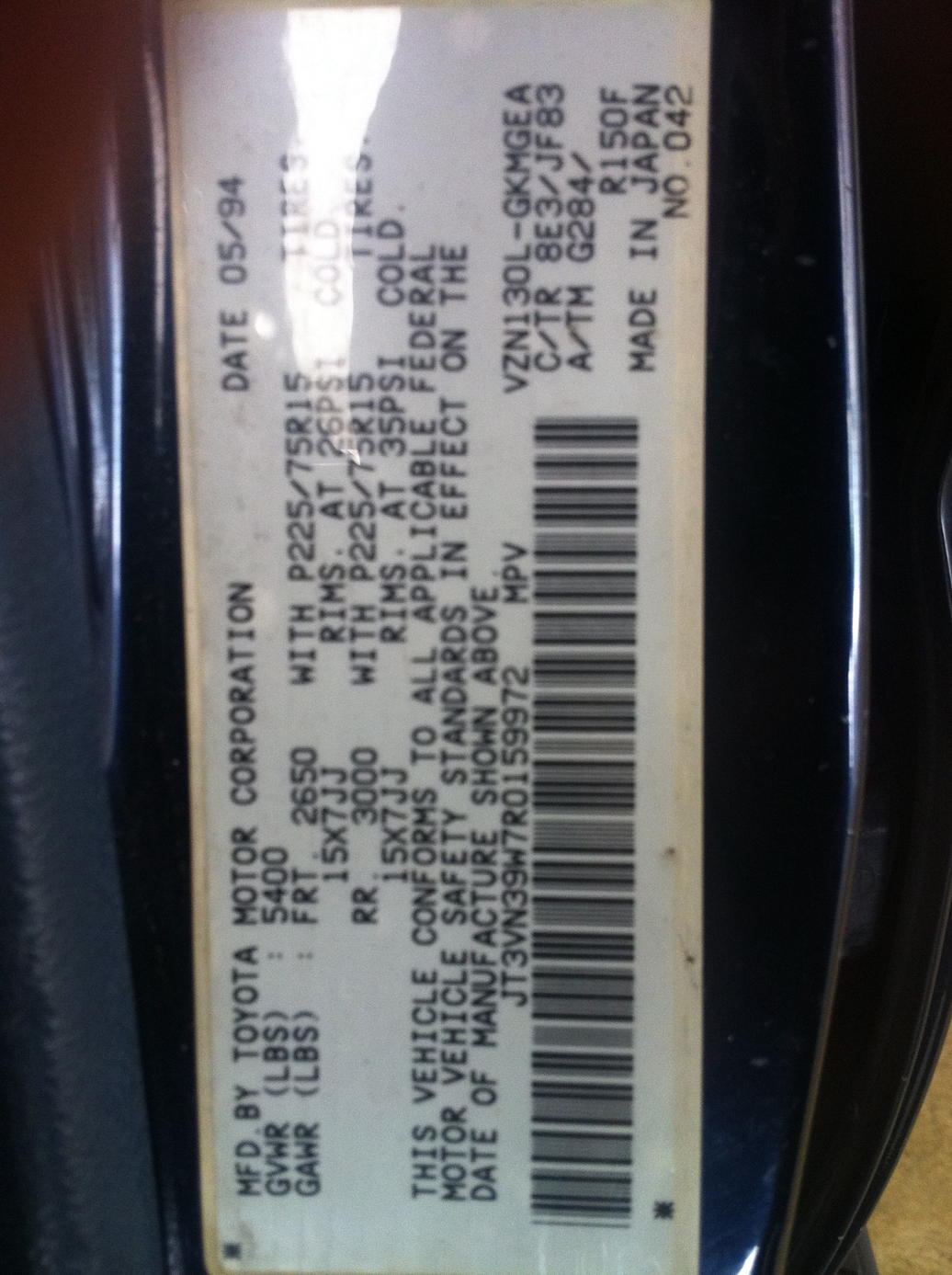

Your door sticker has a code to tell you what rear end is in it. Google for the code axle information.

Sorry for the huge pic.. Do you know which is the axle/gear code?
i think its the G284, you have an 8 inch diff, 4.3 gearing, 4 pinion open diff.

maybe look for the code G254. thats what i had before i went to 4.88's, which is G144, and i will admit that i preferred the 4.56's for highway use but i have lots of power with the 4.88's. if you want to swap out you gears id look for the 4.56's, they are more available than the factory 4.88's, i think you will be happy. i just sold my old set to my uncle to replace his 4.3's.
