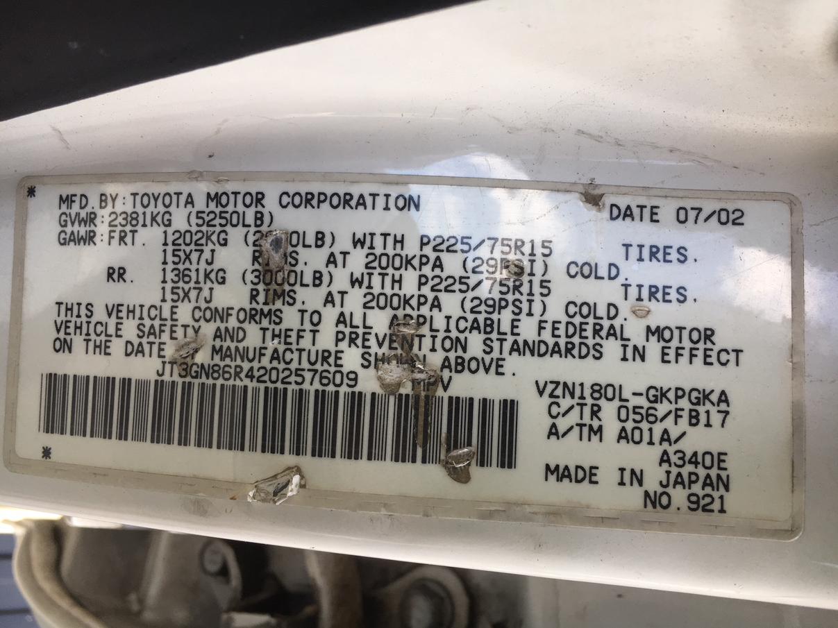

I finally got the door code deciphered. I have 3.46 gears.
My bro suggests 4.11 but he's not a Toyota guy specifically but he will put them in. He's an experience mechanic... 30 years or so.
I have 27 inch 15 inch tires.
Attached is my door sticker.
He asked me to ask you guys do they need to be shimmed?
courtesy ou jomentum on ttora forum
1st digit= ring gear
A= 7.5"
B=8.0"
2nd & 3rd digit= gear ratio
01=3.583
02=3.727
03=4.100
04=4556 or 4.30
05=4.700
06=4.875 or 3.909
4th digit= # of pinions
A=2
B=4
C= 2 Pinion OEM limited slip

Oh, so I have 3.58. Close enough

My truck has the "A01A" axle/gears stock (with 15" wheels) and it actually had the 3.73 gears from the factory. That's probably what you have, otherwise your highway RPMs would be way low (below 2k rpm at 70mph in 4th/OD).
