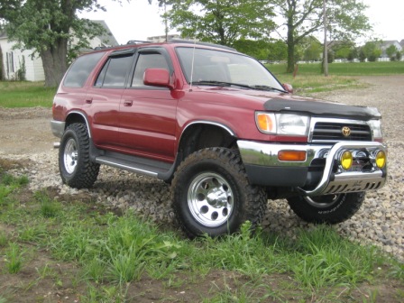

I have a '97 T4R, yesterday I noticed that I went to put my truck into gear and would not budge. I now have to depress the bypass button on the counsel. Help please!! What causes this? Easy fix or no?
