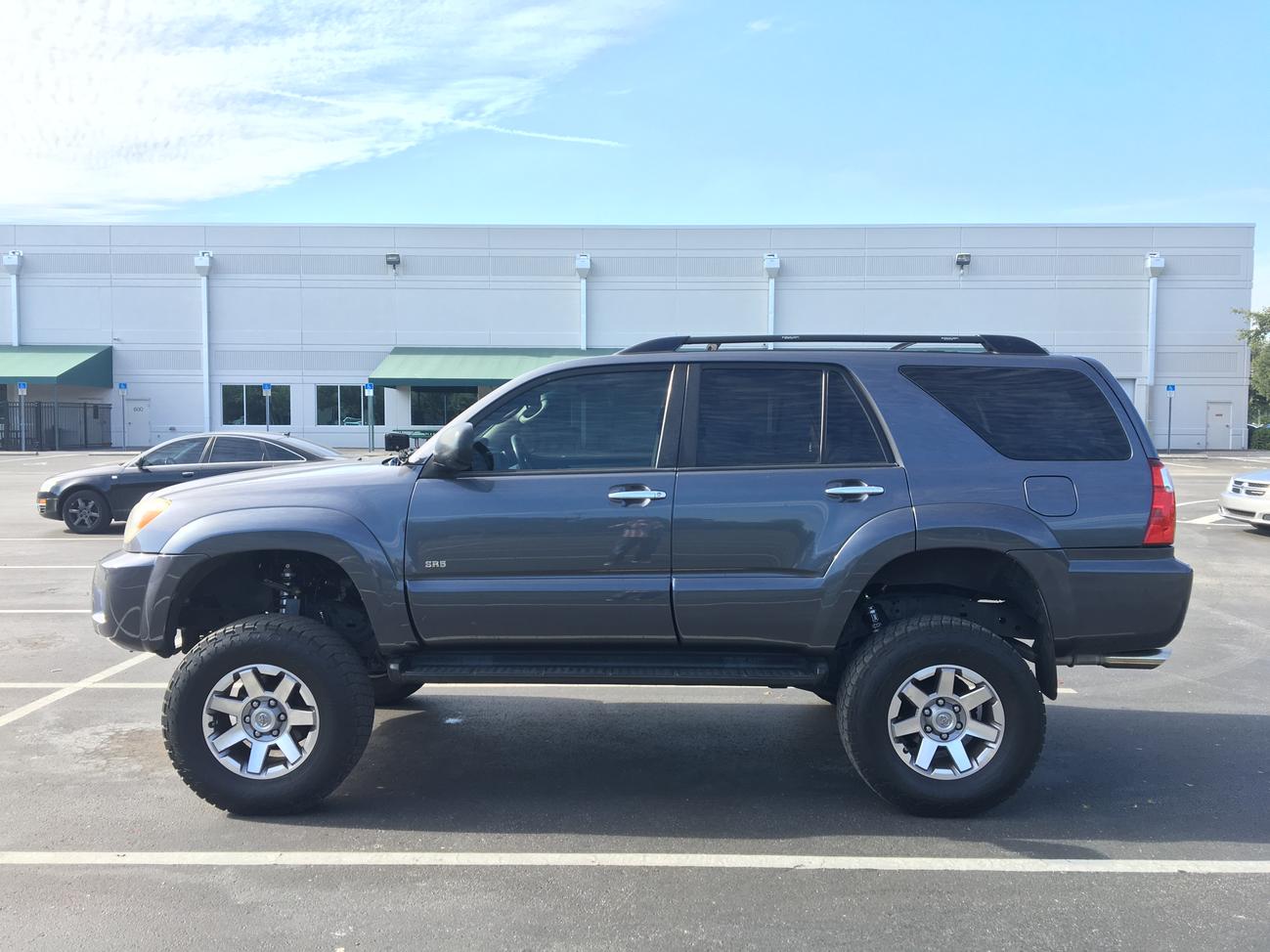

With a 2wd you can go way higher than 5" if you want to. Personally, I am running a full Icon Stage 2 lift with Icon UCA's, 4" lift spindles and a 1.5" body lift. With the coil-overs midway I would estimate that I am around 8" or 9" higher than a stock 2wd 4Runner. I am also running Icons 3" overland springs I the rear with 1.5" Daystar spacers on top to keep it level. One major plus is my tires don't rub anymore!

Cloudrunner, wow that thing is really up there! 4" spindle lift, interesting. And you didn't need any mods in the rear to account for that 3" rear spring and 1.5" Daystar spacer? Driveshaft and diff mate fine, no vibes, etc?
That is correct, no additional modifications required other than extended brake lines. I went with Slee Off-Road for mine.
