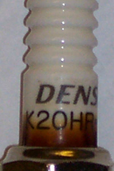

I decided to replace my plugs myself after the stealership quoted me $120. Followed the instructions from another post (thanks josh) and didn't have any issues replacing. However, I have a question regarding the appearance of the old plugs. I have a V6 w/ 33K. I had 3 Densos and 3 NGKs. All plugs had turned a dark brown at the base of the insulator. Almost looked burnt. Densos were worse than NGKs. I compared my plugs to the ones in josh's post and none of his have this discoloring. So my question is, is this normal? I've done some towing but I always moderate my speed. Any insight would be appreciated.

The plugs in question are the original plugs that came with the vehicle. I just recently replaced with the same Denso plugs. I confirmed that the new plug p/n matched the 3 Denso's I removed. Plug in pic is one of the originals. Anyone out there have have experience reading plugs? Is it unusual or am I just being paraniod. I'm curious to learn...
I don't recall ever pulling any plugs from an engine with that sort of marking. Makes me curious, too.

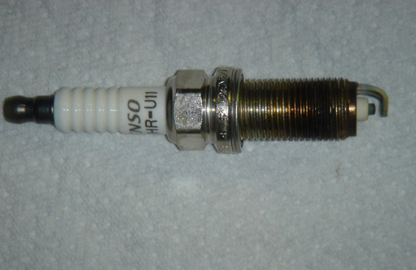

A little late, but nonetheless. Here's the pic

Thanks for the reply. I was told by someone on another thread that the discoloration is normal and is cause by oil vapors. He said he sees it all the time. I do a lot of towing so I'm assuming that is why mine have the discoloration and yours don't.
