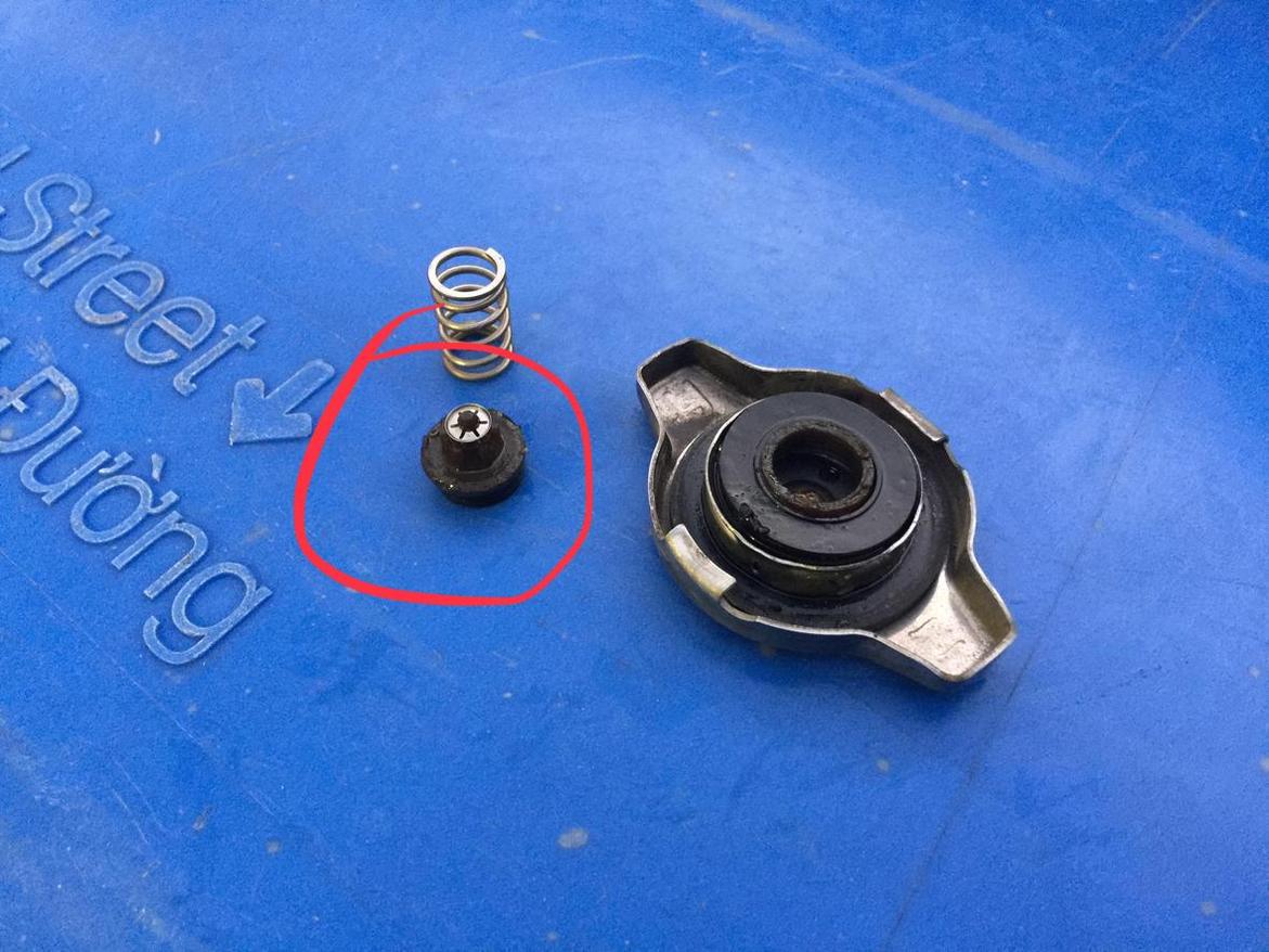

I hate to revive a 18 month old tread but this happened to me tonight. The plate I circled in red broke off and went in the radiator. Attempts to pull it out were unsuccessful. I’m worried this is going to get caught in the radiator and cause damage or overheat. I don’t think it would make it into the motor. Is it true as the OP stated that it’s is okay to run with it in there with no harm? Someone please calm my nerves or even give me the bad news. If it is going to cause damage I guess I’m pulling the radiator this weekend

That piece is too big to pass through the slots that I see when I look down into the top tank of my OEM [replacement]radiator. Water flow is down, normally.
Is there any scenario possible where the water/coolant could ever flow backwards into the top of the engine? ??
How old is the radiator? If it's over 10 or 12 years, and especially if your 4R has an auto trans, you are due for a new one anyway, and it's pretty easy to change.

Don't worry about it. Just replace the cap with a new one. As said, if your radiator is old, replace it along with a new tstat and hoses. If there is pitting on the mating surface of the water intake, replace that too.

Those broken pieces won't make it into the engine. If it will make you sleep better, you could pull the radiator, turn it upside and shake. There's a good chance you can get the loose parts to fall out. But, even better yet, replace the radiator as preventative maintenance so you don't get stuck somewhere in BFE if you radiator decides to spring a leak. There's also the extra insurance of avoiding a trans cooler failure and getting the dreaded pink milkshake.

Thank you! I also got a few PM’s that put my mind to ease. I’m going to pull the radiator as soon as I can. It may not be in the next few days but soon. It needs a good flush anyway I’m sure.
