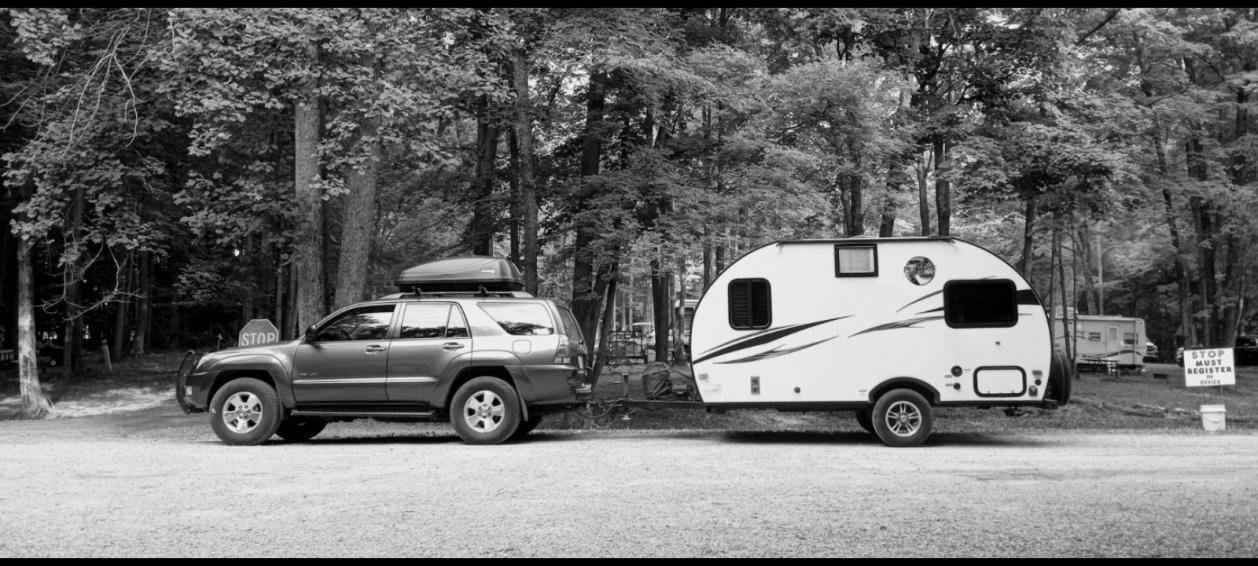

It's only $100 or so for a name brand one.
I pulled a 2k lb. Camper for a year without one and really don't think I needed it until I put one on. I'm traveling full time pulling the camper and figured I could use the insurance when I go over the Rockies in a month and the controller makes life so much easier even on flat ground in Kansas.
Get one. Period. Even if the trailer is light.
